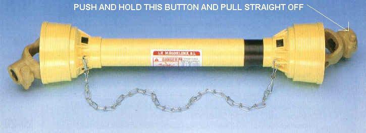

Without having it in hand it's hard to determine how the guard detaches.
Just for the record - you should not need to remove that guard in order to detach the drive shaft from the tractor. I've owned implements with guarded drive shafts like that for almost 20 years and I've never removed the guards from the drive shaft.
As someone mentioned there is a spring loaded button on the coupling that slides onto the drive shaft. You push the button in all the way while you pull on the shaft and it should slide off. If it's stuck try penetrating oil and banging on it with a hammer or try a pry bar. A helper makes it a lot easier when you're doing that.
/ The only stupid question is a question not asked ? #6
I would leave it attached to the gear box. It may be awkard, but you should be able to get your hand in the sleeve at the tractor end. Just pull the coupling sleeve back and yank hard.

I figured a picture of the button would help. A thousand words, right...

The push-button PTO release/retainer is the most common, but some (e.g., Bushhog-supplied) PTO shafts have a spring-loaded flange around the entire PTO coupling that must be pulled to the rear (away from the PTO) to release the coupling. There's probably some other methods as well. Close examination of the coupling should indicate how yours works. Granted, that's hard to do with the shaft cover in the way!

I have the same phd, same tractor for that matter... Turn the plastic slotted keeper so the slot is in line with the drive shaft and use the screwdriver or whatever to pull out on and completey remove the plastic keepers, then pull back on the yoke sheild to expose the yoke. Pull back on the yoke flange (you don't have the push button type) to retract it and pull the yoke off the pto shaft. I don't remove the driveline from the phd for storage. Instead I bungee the shaft to the boom. Don't forget to put the plastic keepers back in the yoke sheild so thay don't get lost.
