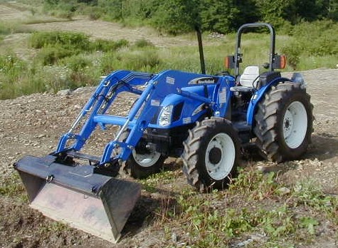

Here she is...my first tractor and I love it. What a nice feeling to own a piece of equipment that is not only good looking, but extremely functional.

Lookin' good. The loader seems real far out in front - do you have supersteer? What kind of projects are on tap.

Which loader is on it? 32LA/LC/MSL?

No supersteer....regular 4WD. It's the 32LC loader. There's definitely some room between the tractor and loader....which is fine by me.

32LC loader? Is it self leveling? Just curious as my TN75 I bought last year has a 32LA. Looks like they put a NH decal on the loader too - maybe this is the diff between LA and LC /forums/images/graemlins/grin.gif

There are a lot of differnces between the 32LA and LC. The ones I noticed are the round support tube between the arms on the LC, the LA had a square tube, the mounting brackets on the tractor are a flat piece of steel the loader hooks over on the LC, the LA had a C channel bracket that the loader sat into and was pinned on. The LC has a bolt that needs to be loosened to remove the loader while the LA only needed two pins pulled. Last that I have noticed is that the jack stands are completely different. The LA had two stands attached to the loader, one on each arm and you had to fold them down and extend them out and pin them to hold to remove the loader. The LC has a tube stand if I recall right that is attached to the loader when needed. All in all, I have not used the LC but from what I have noticed I do not see where the LC is better then the LA. I think it will be more of a hassle to remove then the LA but I have not tried one yet to know for sure. Let me know how the LC loader comes off and if you can get some pictures of the mounting bracket, jackstand and tube between the loader arms and post them and I will take pics of my loader arms on the LA so everyone can see the difference. Take care.
