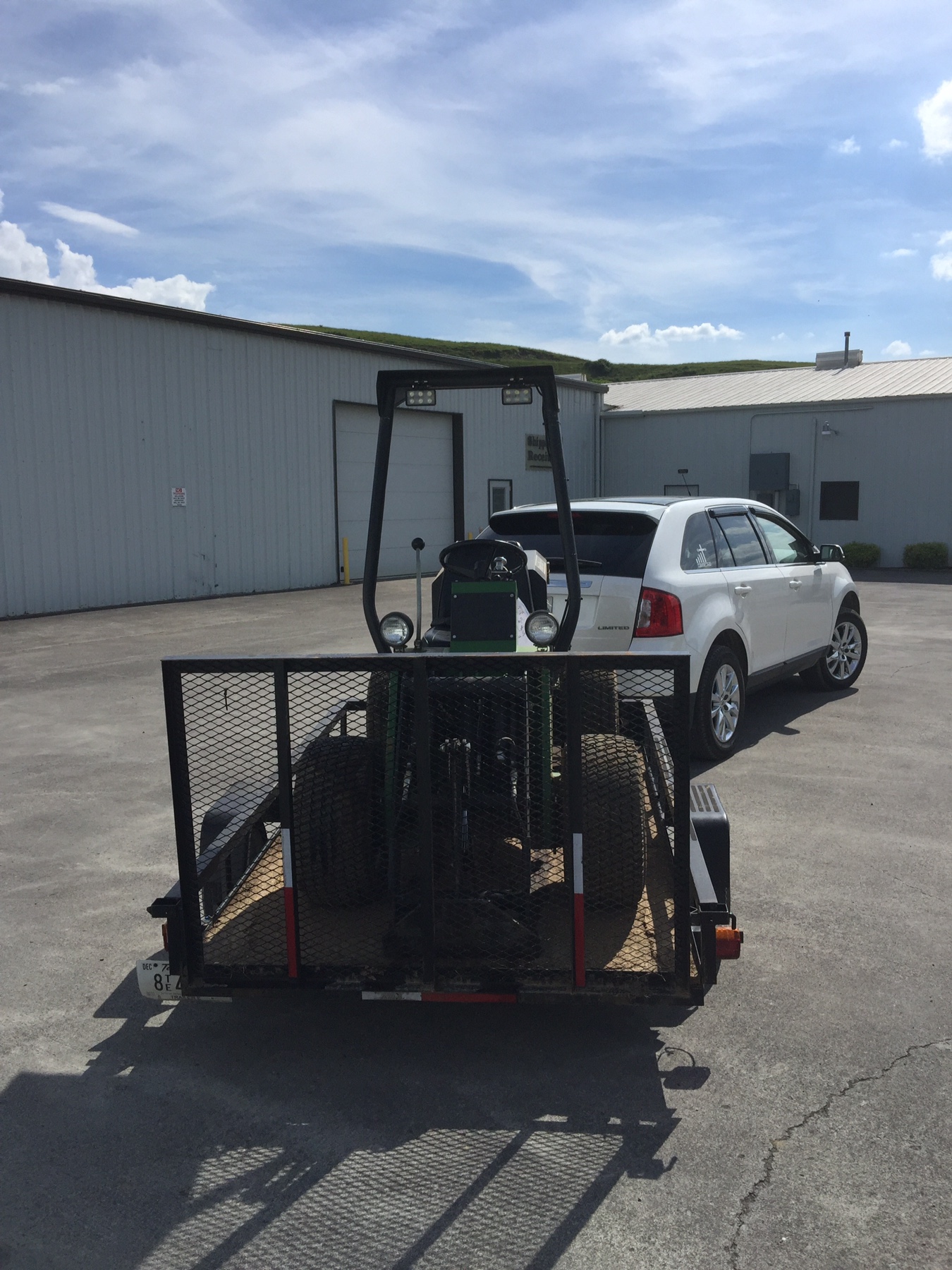

Upon inspection it wasn’t a hose, the oil was leaking from the tram and mount. With only 397 hour on the clock, Disaster! He had read of the dreaded tram pump failure on TracorByNet and here he was beholding it with his very own eyes. Only thing to do is call Terry and send in the tram for rebuild. The wizards at Tazewell did the deed and with the expected steep price. The man told himself “Self, this is the worst that could happen, now your tractor will be just like new, with a rebuilt tram at its heart. The man carefully reinstalled the tram with surgical cleanliness, then he primed the pump and got back to work.
PT worked like a champ for the rest of the clean up and the man again started to glance towards that “happily ever after” again. The PT was doing the job, mowing and pretty easy tasks like flipping over the leave piles for compost when low and behold it happens again. Only 425 hours on the clock. What the.....? The man was dumbfounded. How could this be? He did everything the was supposed to. Replaced the filter and primed things as he should, why did this happen? Of course these things always happen after 5:00 on Fridays all he can do is berate himself on something he messed up that caused the new failure. This time It will be fixed the right way, so he loads the PT up and heads to Tazewell. The man explained to Terry what had happened on the phone, but Terry didn’t understand the nature of the leak. When he decided to drive it in to the service bay, he left about gallon of oil on the ground on the way.
After cleaning up the spillage. They gained access and decoupled the tram to check the seal. Sure enough it was gouged and the metal was tore up. He suggested that some piece of debris got up behind the mount and took out the seal. The man thought, I guess that is possible. I did use a blower to clean out the tub last time I used it. No more of that. Terry replaced the seal and back to TN the man went. Happy he was never going to have that happen again.

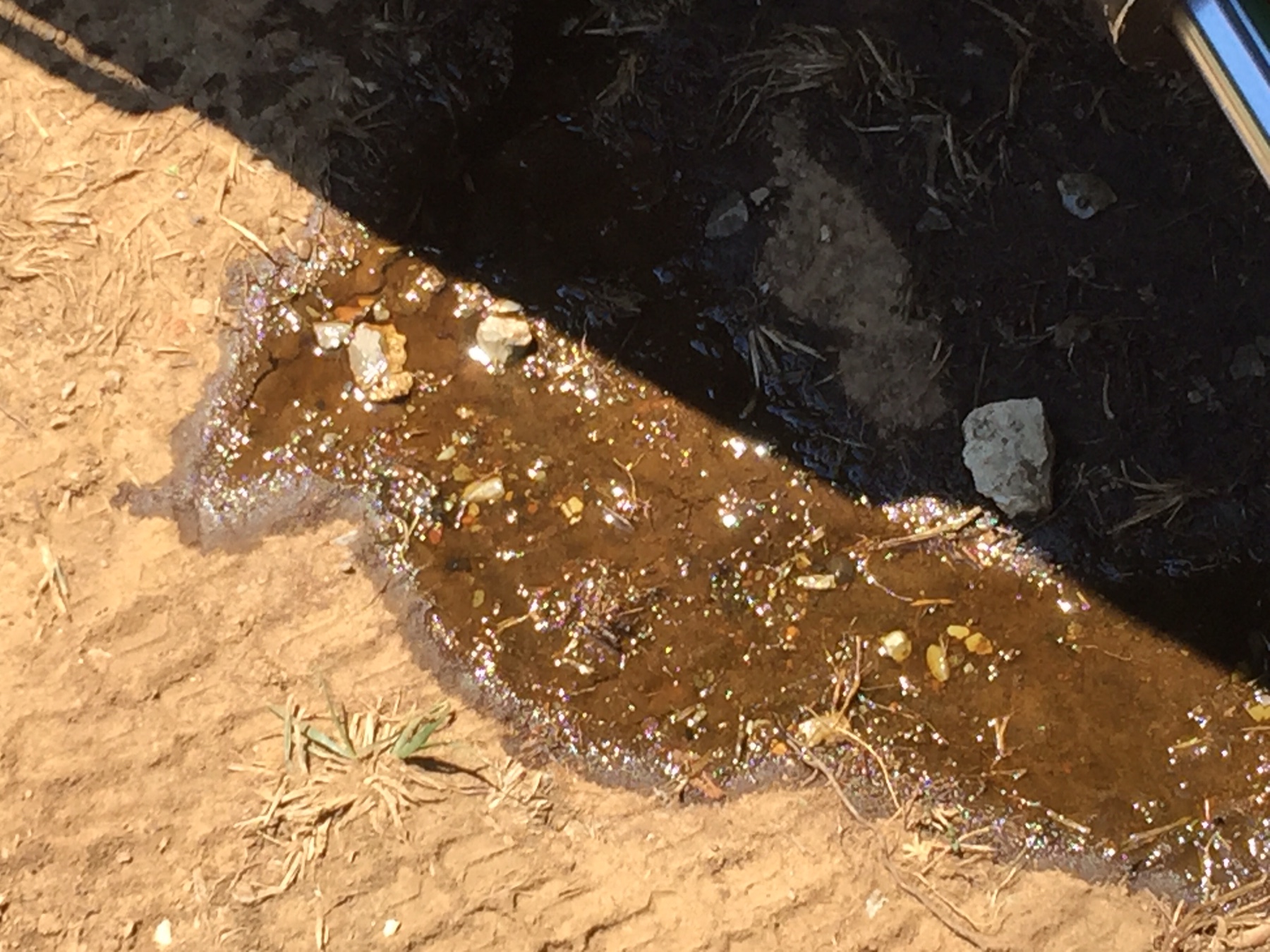

Yeah right! Just mowing the lawn. Come on now! That is not abuse! But there it was, oil all over the driveway and following his last run up the yard. Tell me now. Is mowing that strenuous that it would cause the seal to fail again at 459hours? Same 4.5 hour trip to Tazewell. Must be a bad seal this time.
