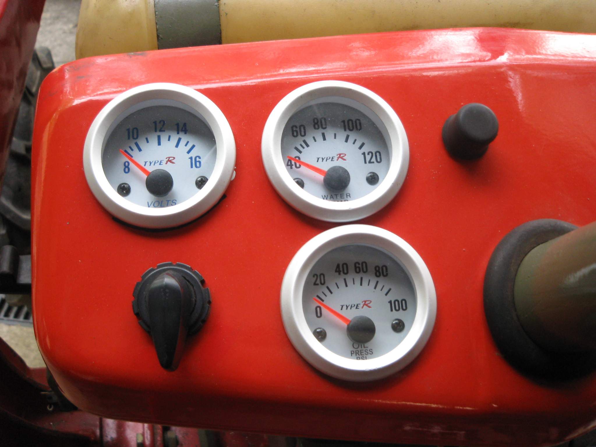

Today i fitted some gauges and a new fuel filter assembly to the 1500,i also swapped the LH and RH rear wheels around to give the wider track. i have almost cured the diesel leaks,only 1 left.it is the bleed screw ontop of the pump inlet,it has been overtightened at some stage and is nearly broken off. i can make one of these myself so all diesel leaks should be cured-well almost. any one got ideas on how to clamp the injector return hoses successfully as those wire clips are useless. i was going to try a cable tie but i dont think it will close around the hose properly.

Gr8 looking gauges im thinking of doing some myself!
   / The Mods have started! #3
where were the holes for the original lights? under the top left gauge?
