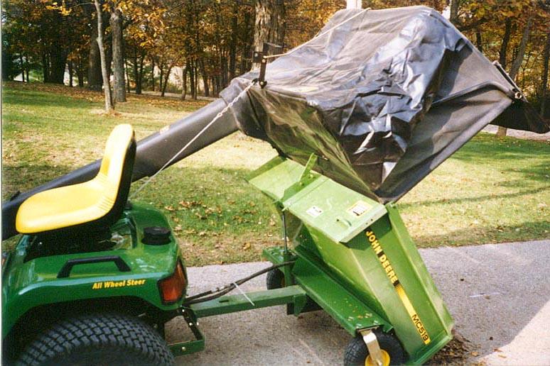

I can't say enough good things about my MC519 cart. And with the added hyd. cylinder to dump it, removing leaves is a breeze.
I found myself banging the bark on too many trees by not doing a good job of judging where the rear of the car was on a turn, so I added a block of wood with a 45 deg taper to the inside of the sides of the cart (at the rear). These blocks allow the cart to glance off of bark, without tearing into the bark.

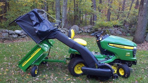

A couple of photos as promised! I'm really happy with this attachment so far.

Nice looking rock wall in the background :thumbsup:.
You will definitely get a lot of use out of the MC519 cart. When I'm not collecting leaves or grass clippings, it still gets a fair amount of use. Those tiny wheels and axles are very well built; I've hit several large obstacles over the years and they are still holding up just fine.

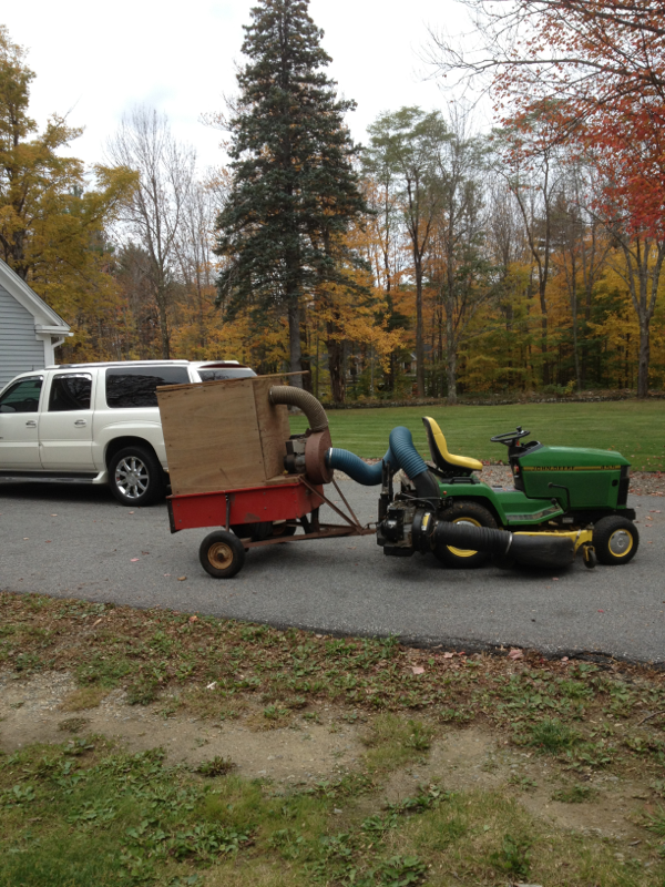

Here is my sucker, literally.. Two engines seem to help!
   / The little X324 gets an MC519 leaf cart
Wow, is there even a need to collect the leaf bits after going through two blowers? I would think you could just shoot them up in the air, ha ha. Heck, you could probably even keep a flame burning at the chute end and get some extra propulsion from the jet blast.
Getting back to topic, here's a little video clip of the MC519 in action
   / The little X324 gets an MC519 leaf cart #9
pilot-werx
That little box must fill up in a hurry.
Curious as to why two blowers? Seems one or the other would do the job.
