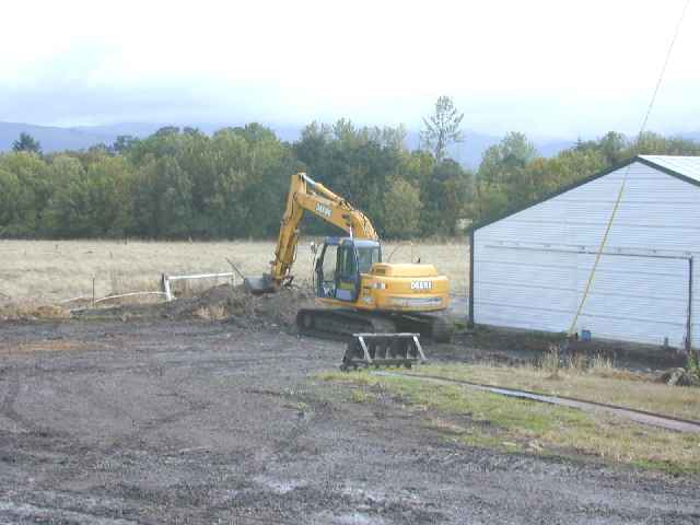

Last month I had to do some major excavation for a road that I am putting in. I got a bid for excavation of $4800. The trouble is that the new road is replacing a road that I have to use so there was only a two week window that the excavation had to be done in. Well my excavators never came so I called and they said that they were so far behind that I wasn’t even on the schedule yet. I panicked and called a friend that owns a construction company for advice and he said that he would rent me the equipment and get me going on my own but he was also too busy to do the job. So we rented a JD 120C (30,000lb) excavator for a couple of days. I found it very fun. I run loaders and tractors all the time so I found the machine very easy to use. In the end I got my excavation done for the rental price of $1100. I also learned a new skill and enjoyed myself.
My advice, if you like tractor work and you don’t want a big excavation bill, is to get a bid from an excavator then go down to Hertz or united rentals and asks what it would cost for a big excavator for a week. If the price difference is worth the effort on your part rent it and have some fun. They are really easy to use and do an incredible amount of earth moving.
