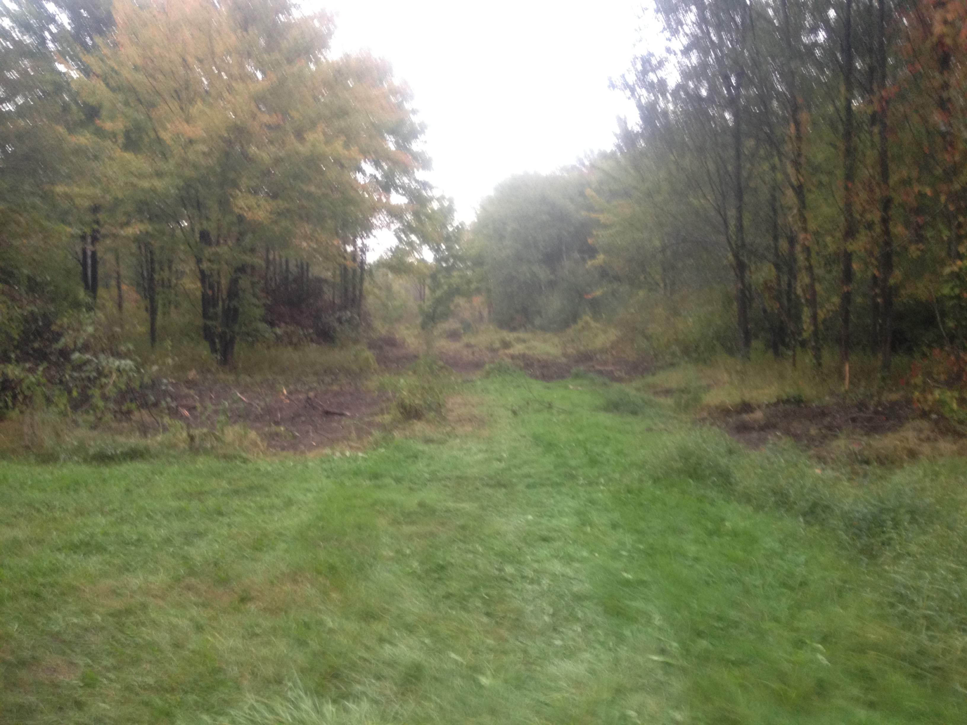

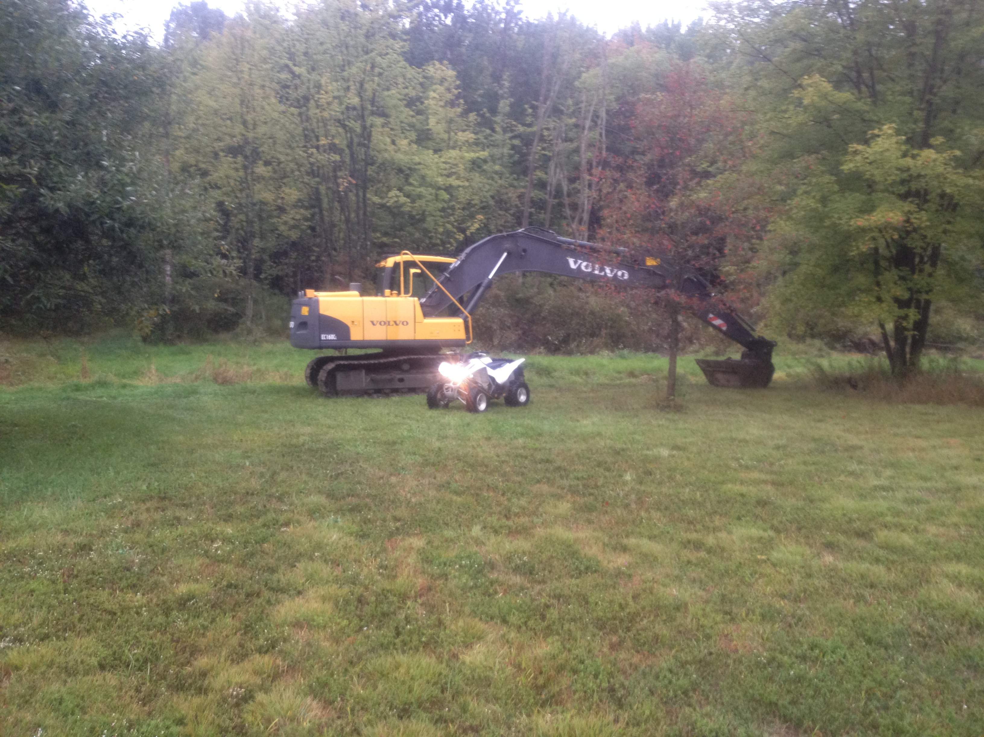

Last fall, the county came through to "open up" a small creek that runs across our property. I'm only there once/week, and a neighbor was nice enough to catch me while I was there and take me down a few properties to show what they were doing.

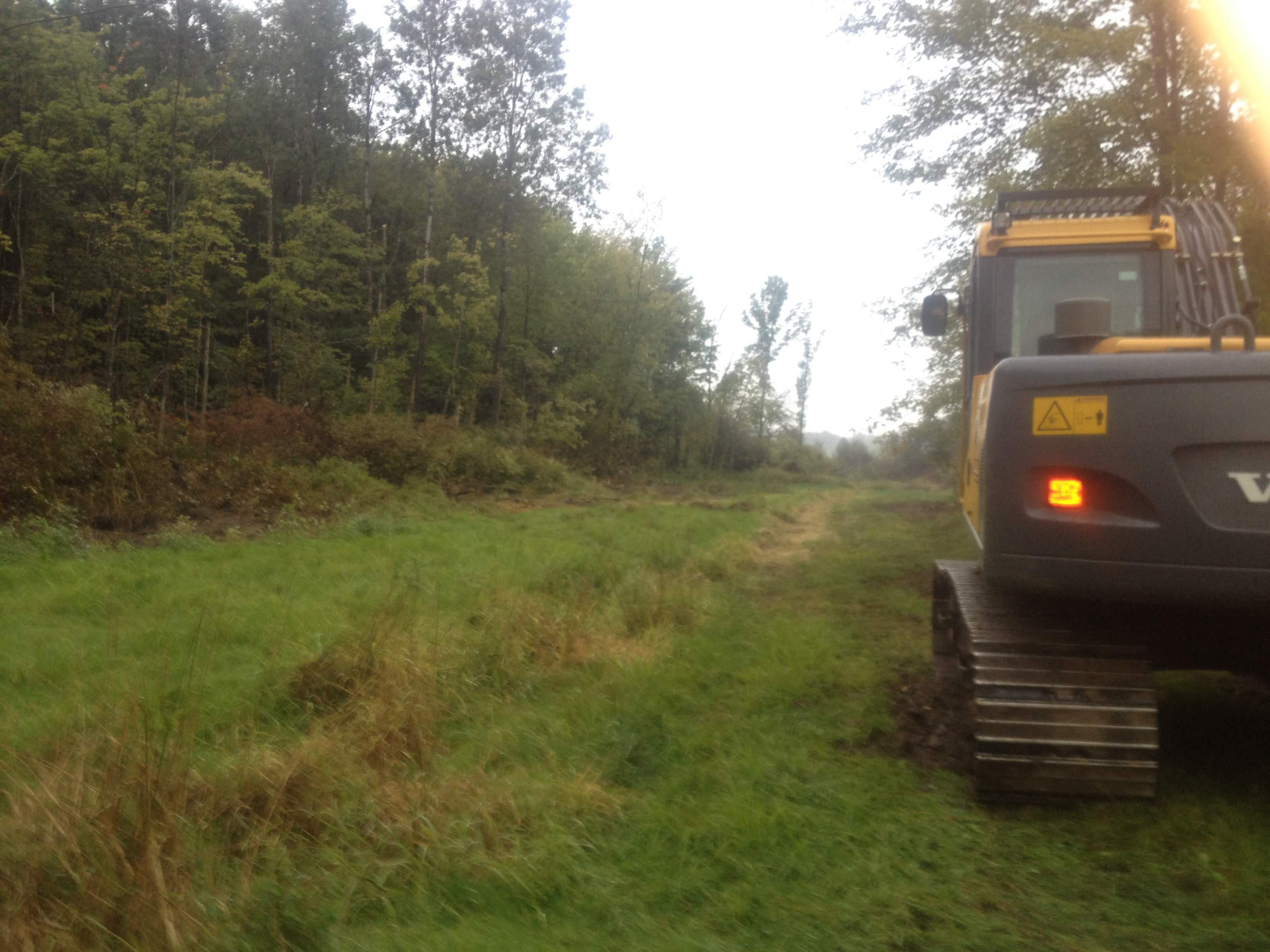

The next week, they had the machine parked at my place, so I snapped a few before photos:

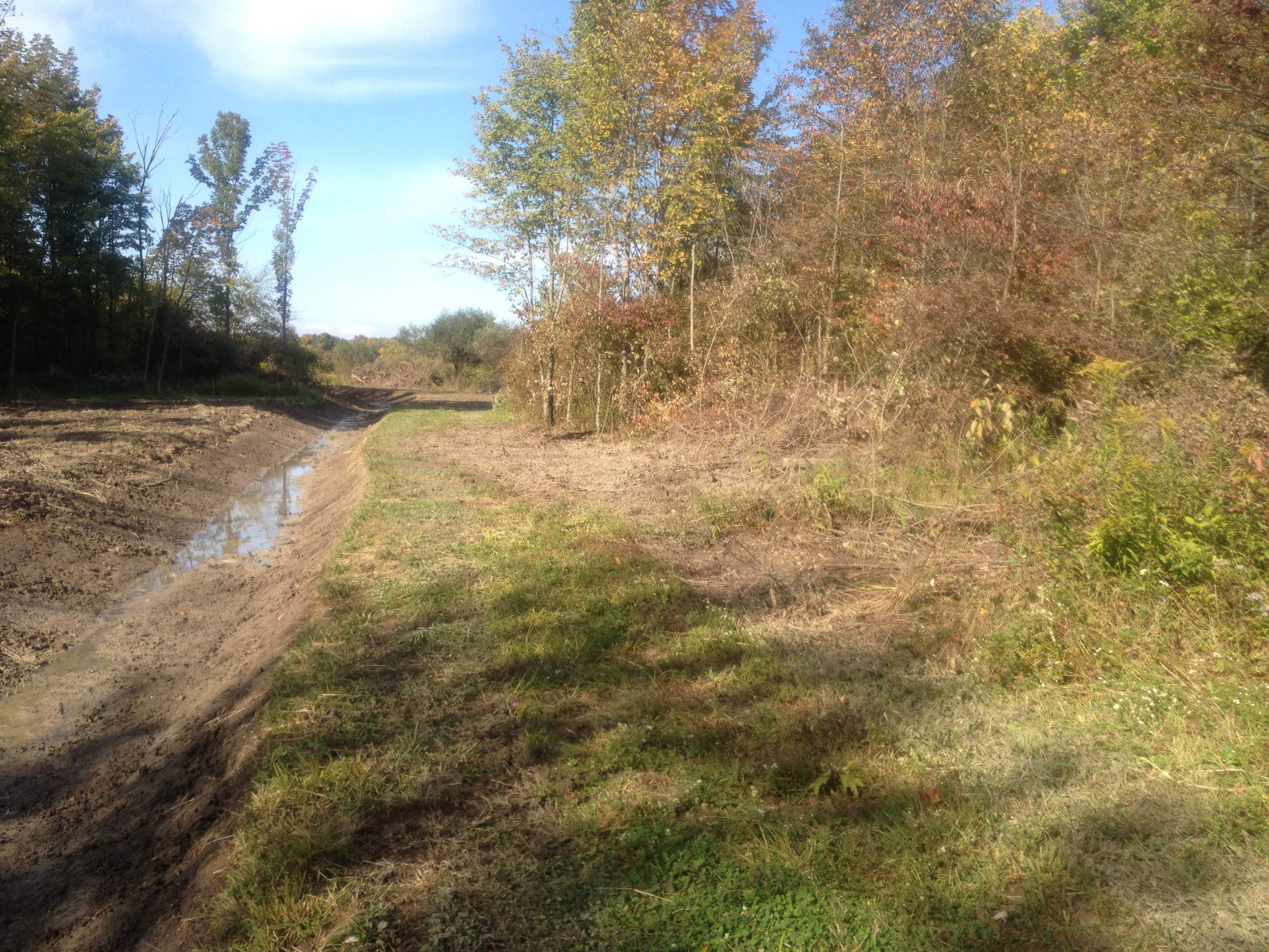

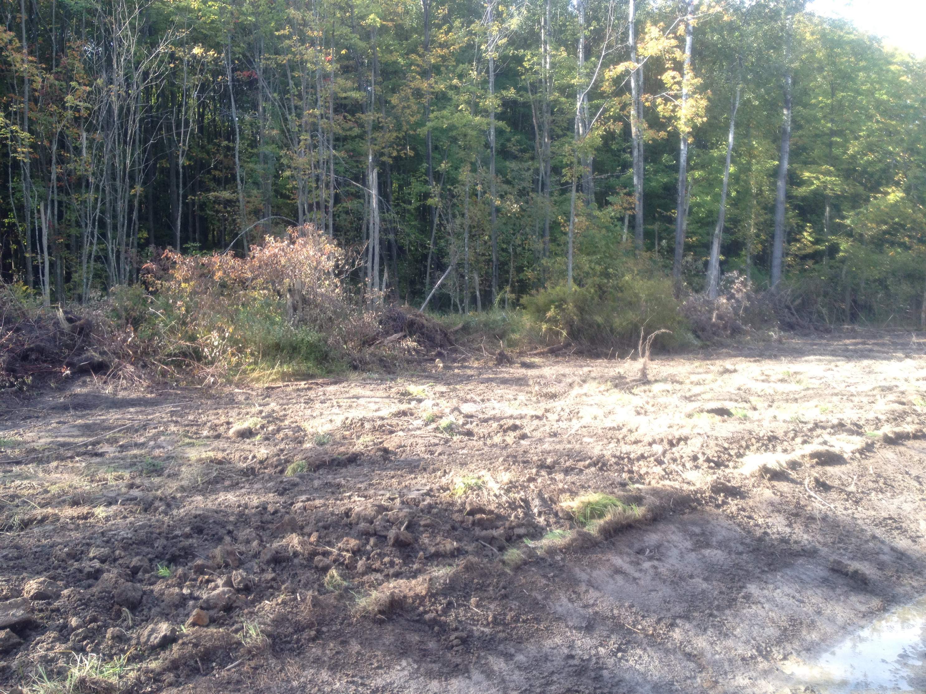

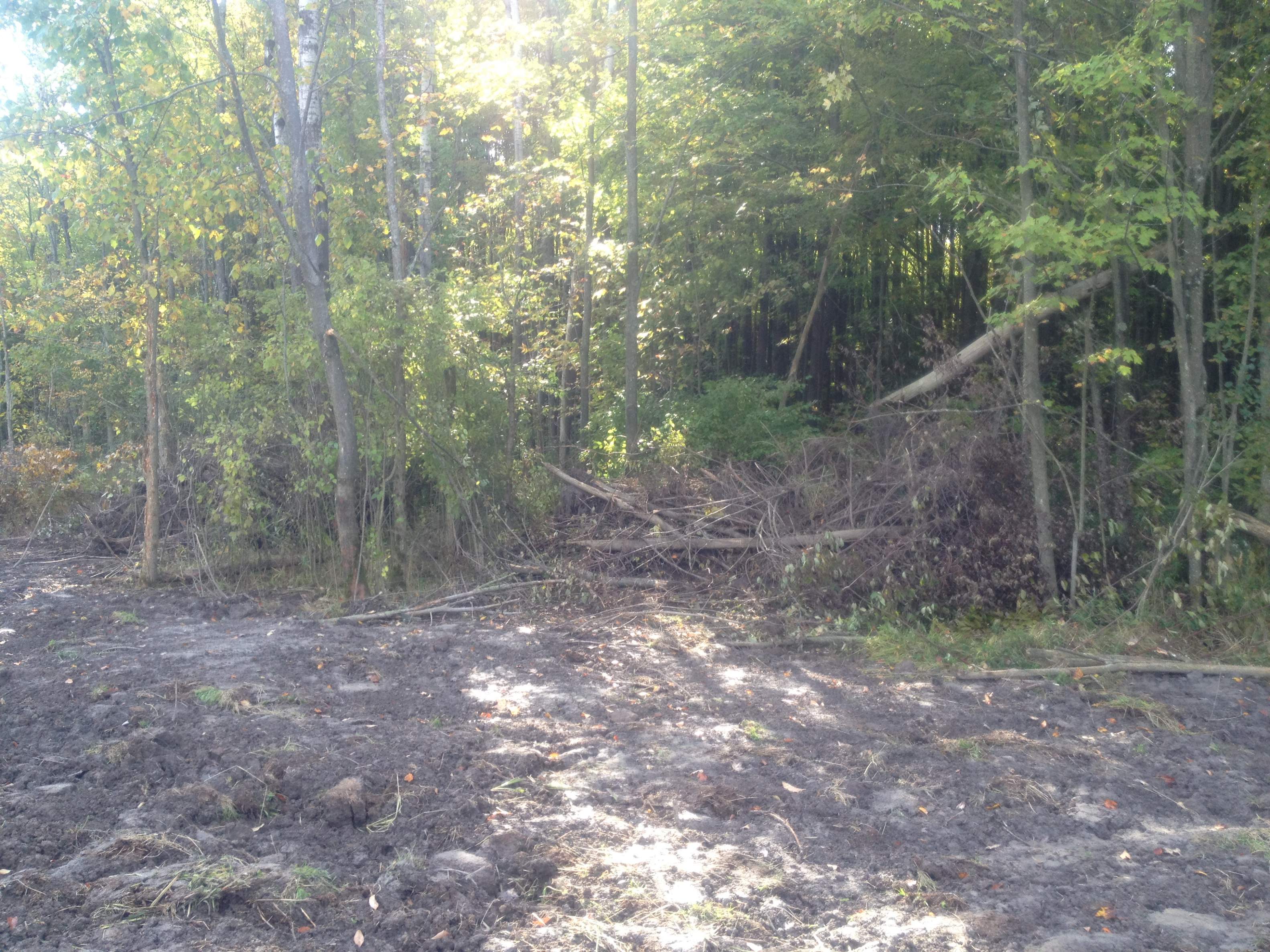

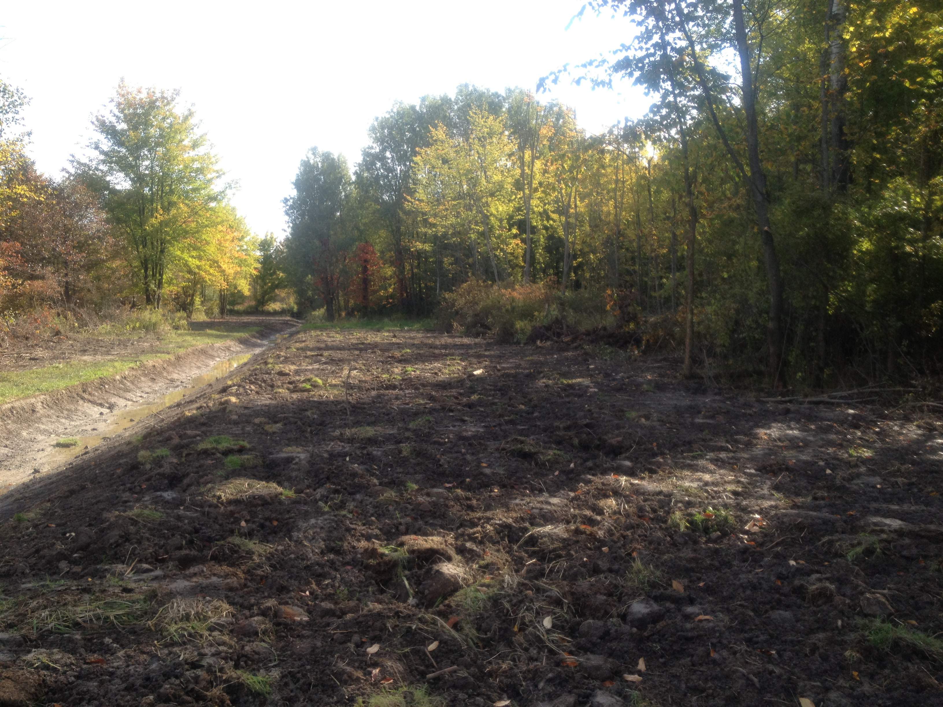

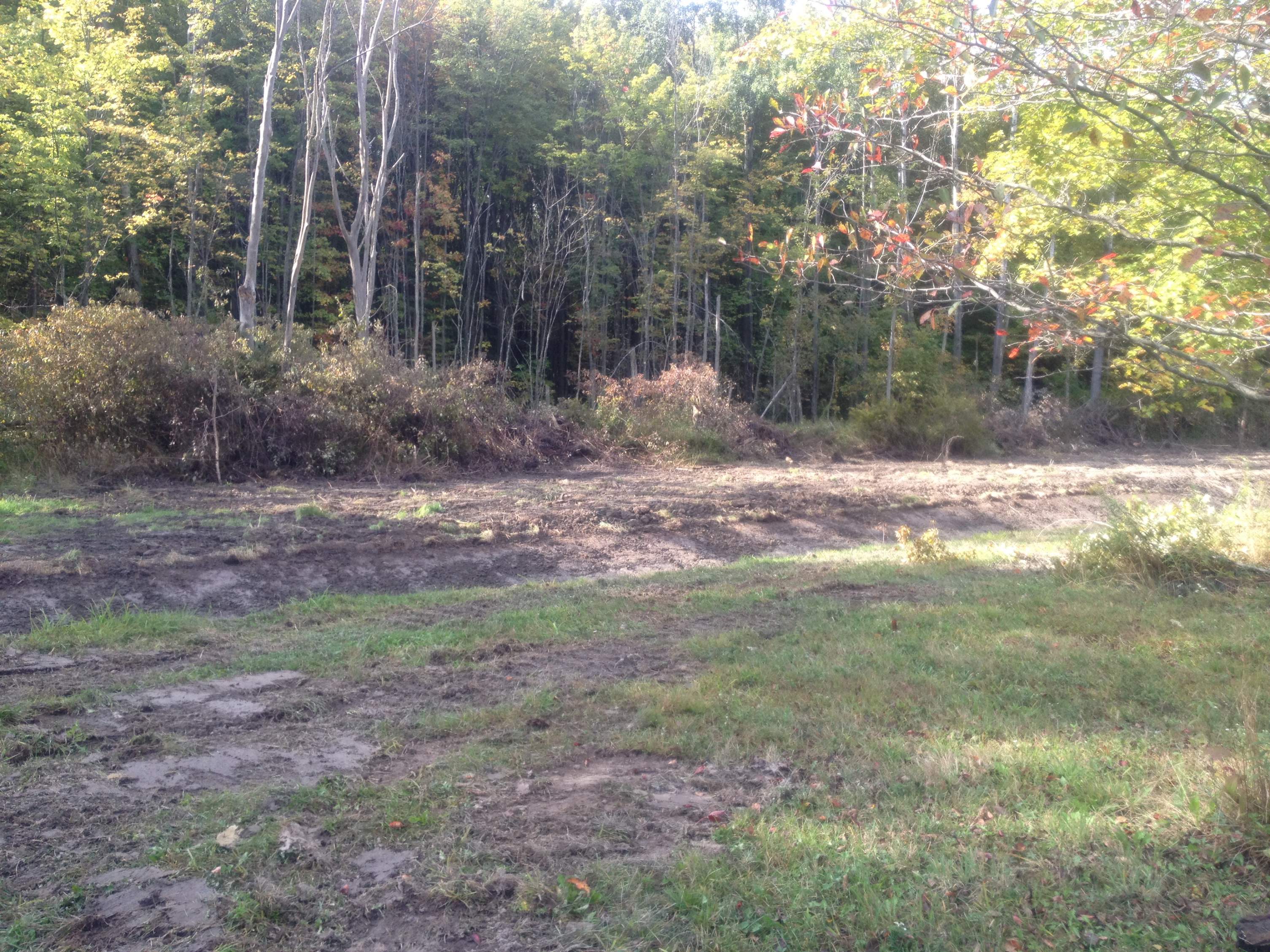

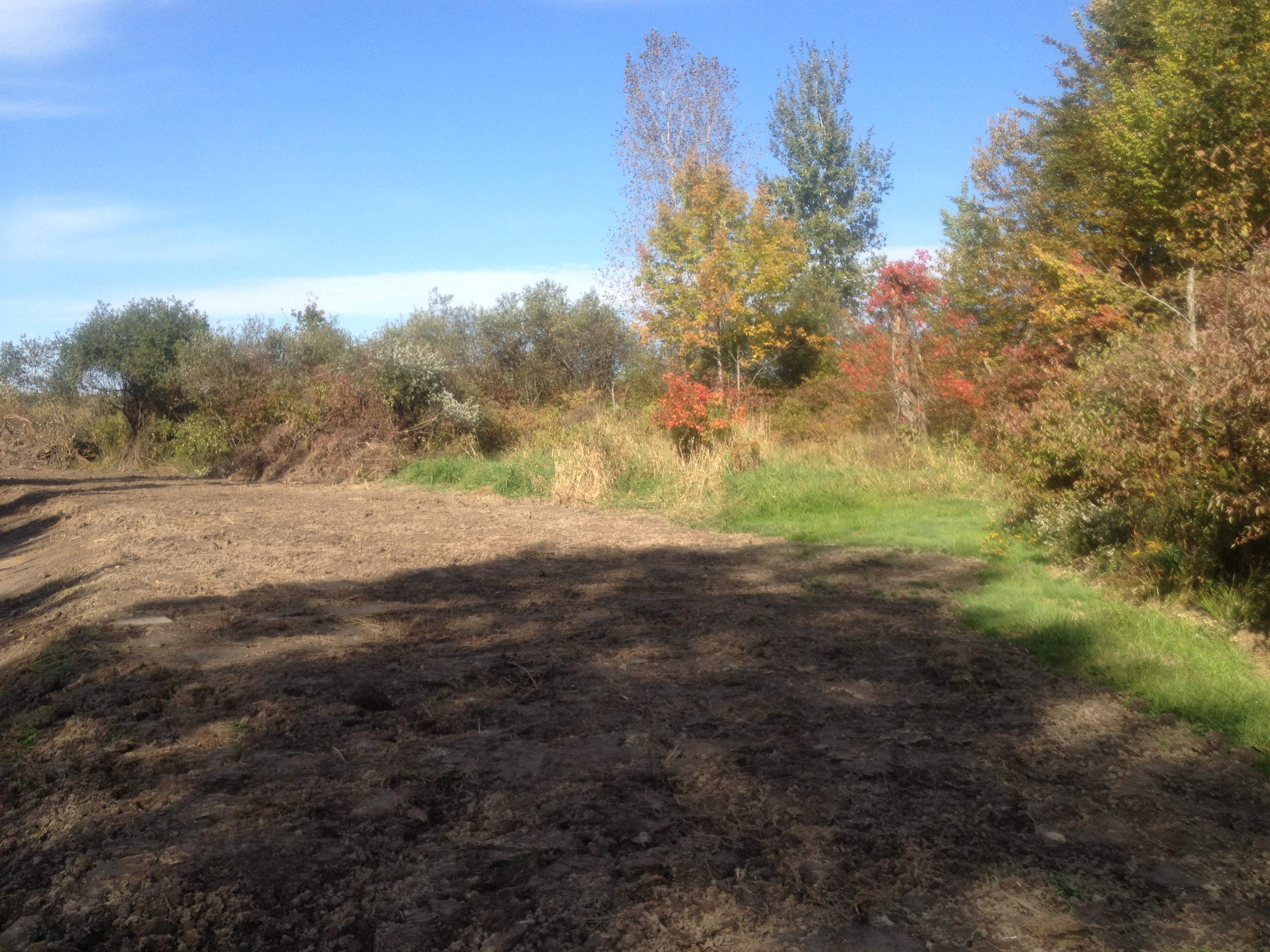

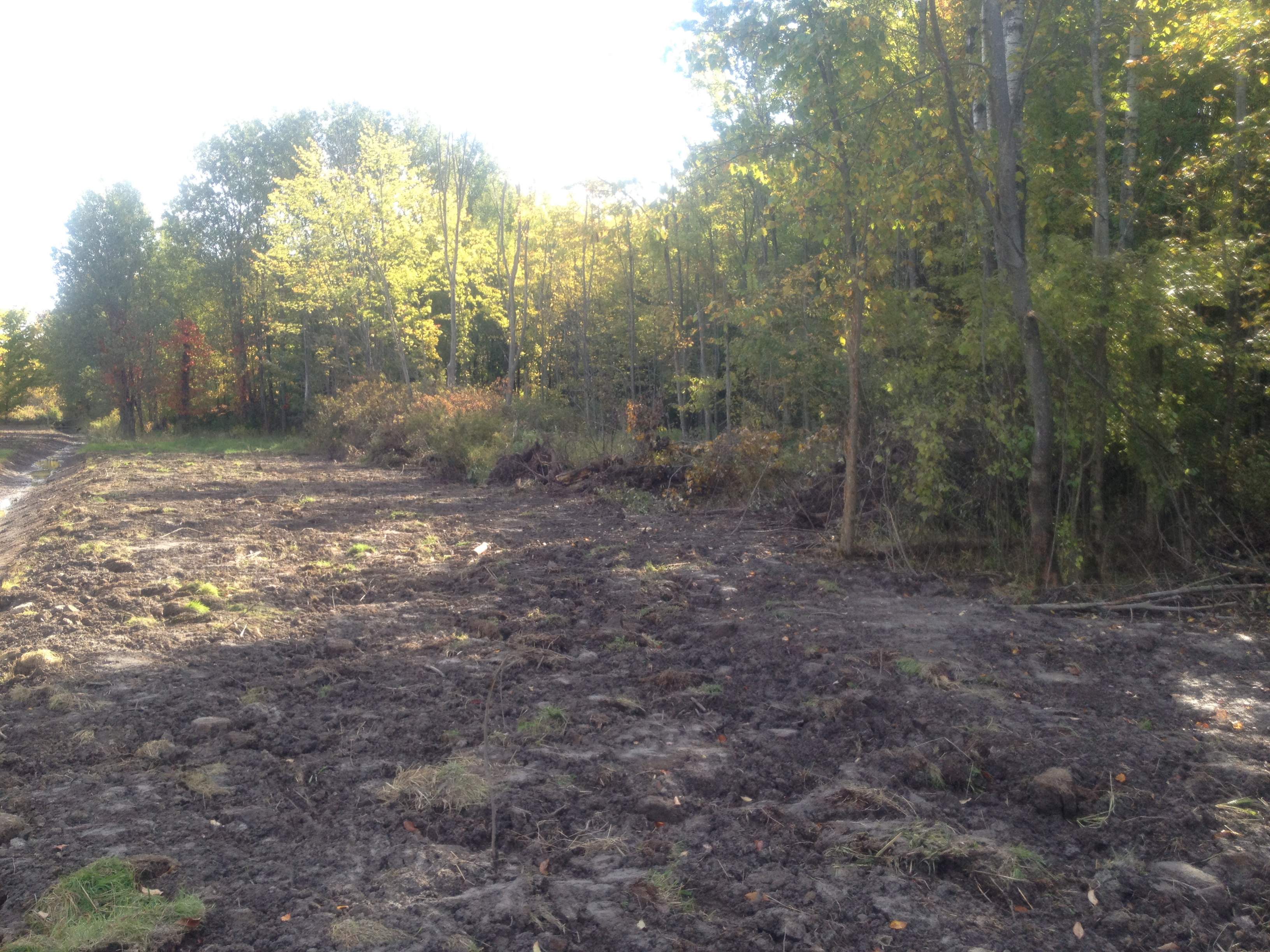

The next week, they were finished:
IMG_0080.jpgIMG_0072.jpgIMG_0073.jpgIMG_0074.jpgIMG_0075.jpgIMG_0076.jpgIMG_0077.jpgIMG_0078.jpgIMG_0079.jpg

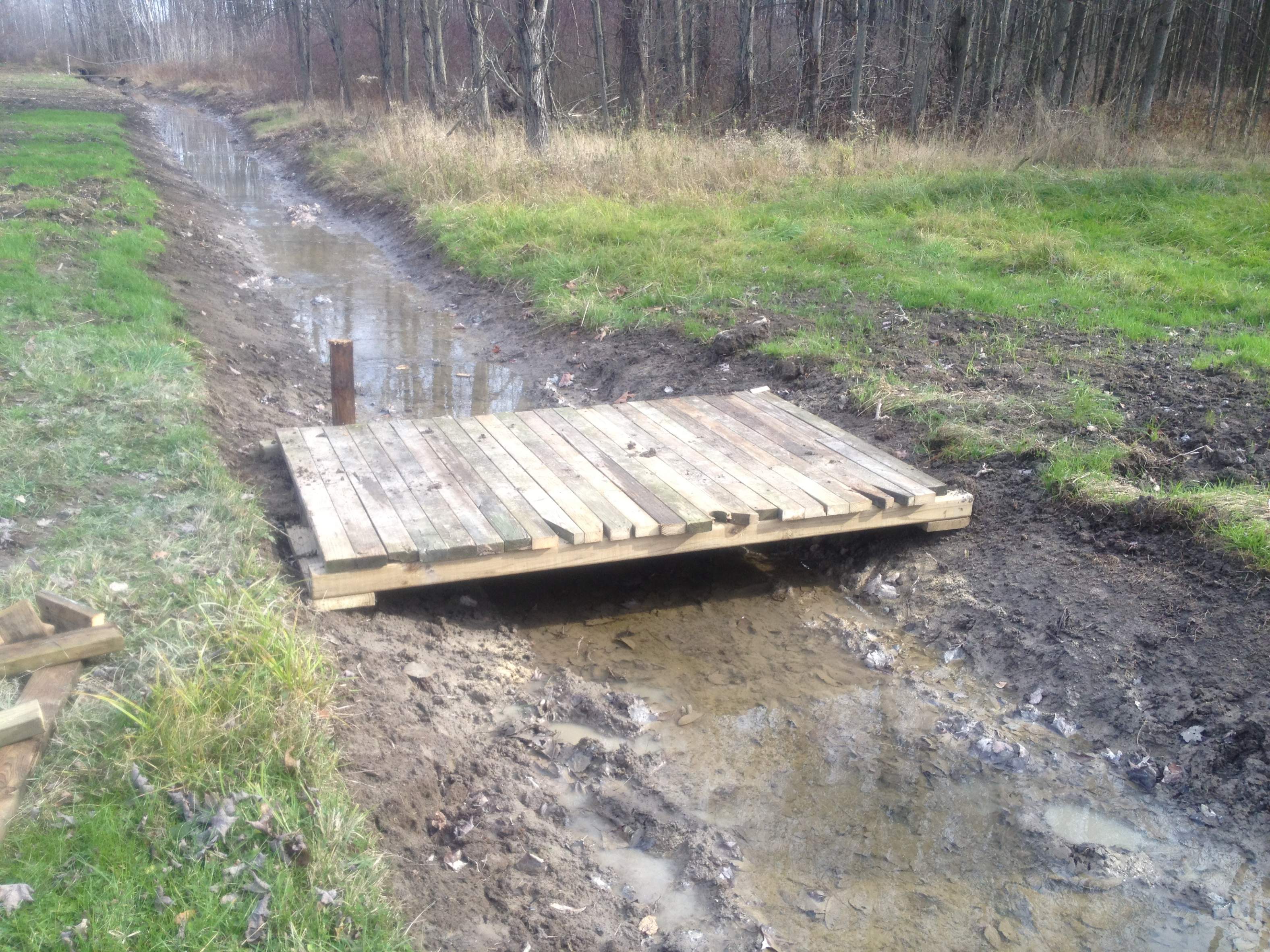

While it looks pretty in pictures, what I found was the whole area full of lumps, holes, rocks and roots sticking out of the ground, and brush and trees shoved into the edge of the woods. No way I'm walking that, mowing that, etc. I spent the rest of the fall collecting rocks and making piles of the wood/brush that I could manage by hand. Plus, with the creek now 3 ft wide, there was no way for me to get a tractor to the south side. My friend from work, who hunts the place over the winter, helped me build a quick bridge before the snow came in:

My neighbor had told me that the county guy was going to leave piles of dirt, so that's what I expected to find when I got back out there. I believe he was trying to do me a "favor" in spreading out the dirt, and he did the same thing all along the way through several neighboring properties. Mine was actually the only one that was clear around the creek, to the east and west of me the area was overgrown with bushes, trees, etc. It does look pretty good from 50 ft away.

Looks to me the county has done you a good favor.
Eddie
   / The county trenched my creek-Cleaning up the aftermath. #6
IMO they 'did you good' for this type of 'update'. (might want to grapple or trim out some castaway brush to open game trails) Counties do have 'eminent domain' or something rights when it comes to creeks & drains, as do power companies on their easements. Tidiness is pretty much up to them. Look for water collecting beyond the raised area. It may justify cutting or piping in to drain. (BTDT) Good access from your land means you can spot spray undesirables etc and otherwise keep them from coming back. :2cents:
   / The county trenched my creek-Cleaning up the aftermath. #7
I can fully understand your concern with the piles of dirt and debris, but I have a question. I looked at all the pictures, before and after. That "Creek" looked like a drainage ditch that was, perhaps constructed in the past, to help with drainage issues. It didn't appear to be a free flowing Creek, at least in the pictures. Have you considered calling the County? Just my thoughts.
   / The county trenched my creek-Cleaning up the aftermath. #8
Looks a pretty good job to me . Individuals let grass and rushes start backing up ditches someone has to do it

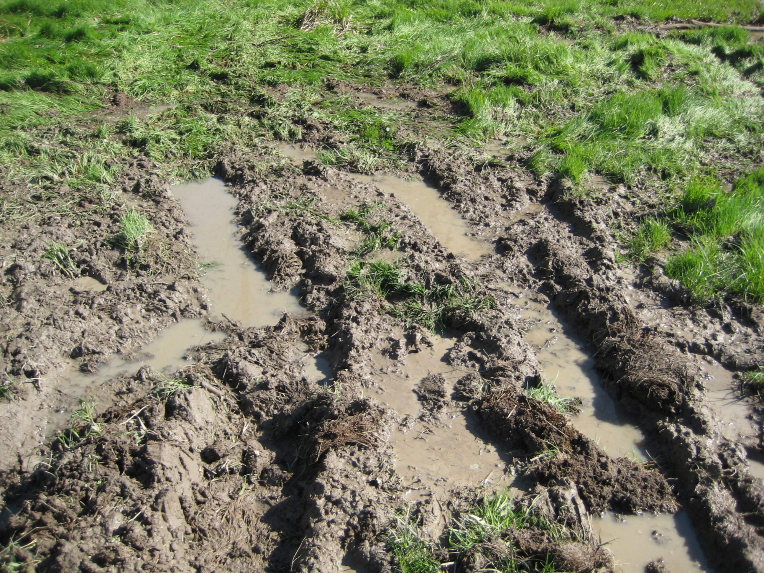

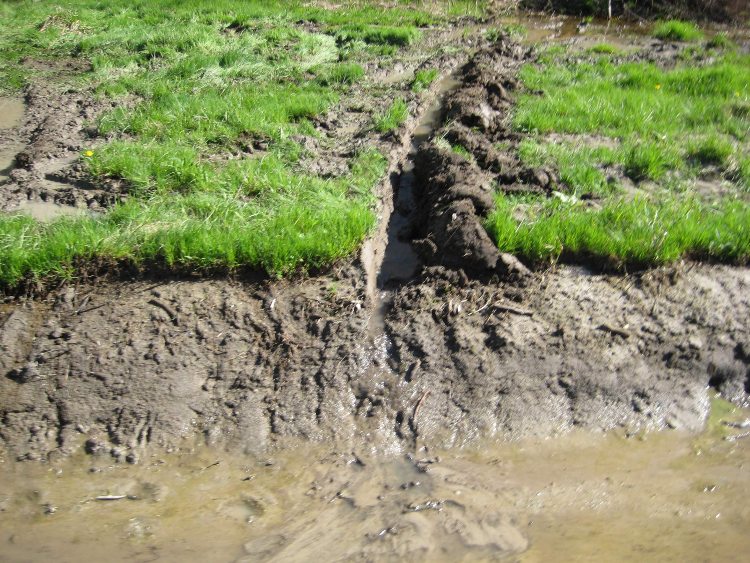

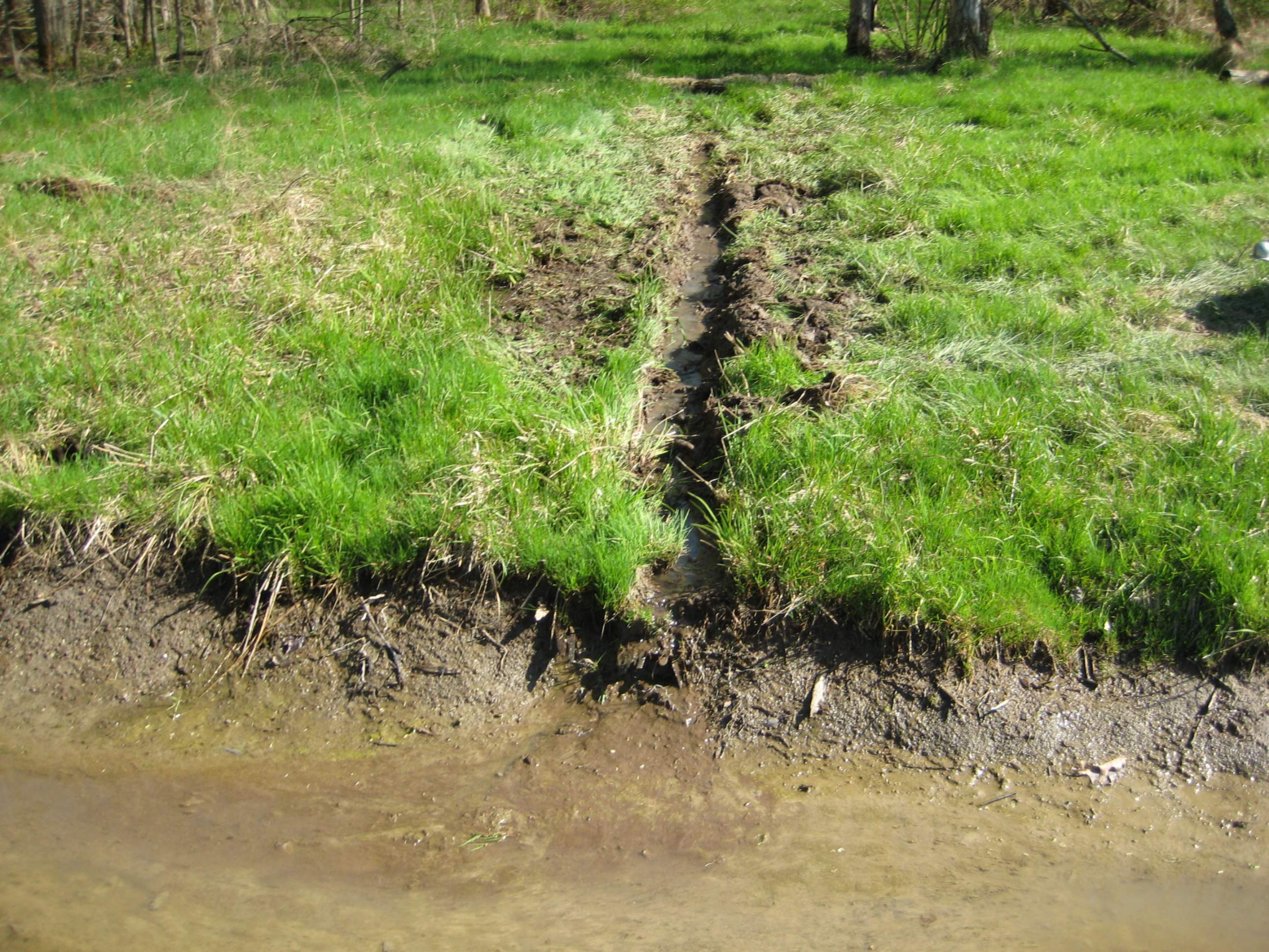

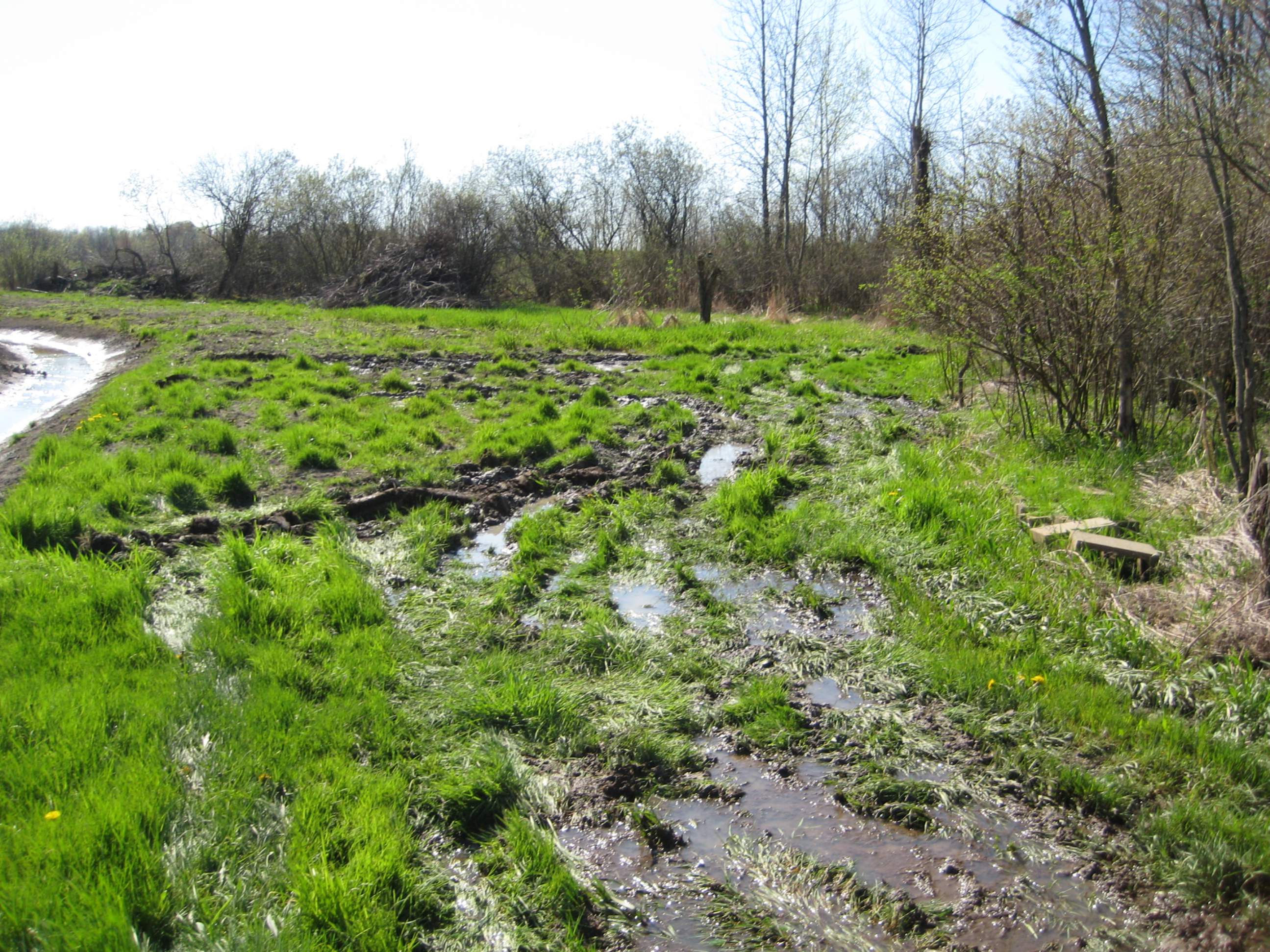

Last week there was a lot of standing water on either side, so I used the B7100 and a small moldboard plow to cut in some trenches to drain it down. In some areas, the rise to the edge of the creek was too high, and I couldn't cut deep enough to get the water to drain. Well, partly because of the rise, partly from lack of traction once I hit the mud soup.
After a little shovel work, they started draining down right away, and kept going long after I was finished for the day.
I'm hoping that once I get this graded to pitch toward the creek(or ditch) there won't be that much water. Is this where a subsoiler would help, by breaking up the hard pan underneath?
