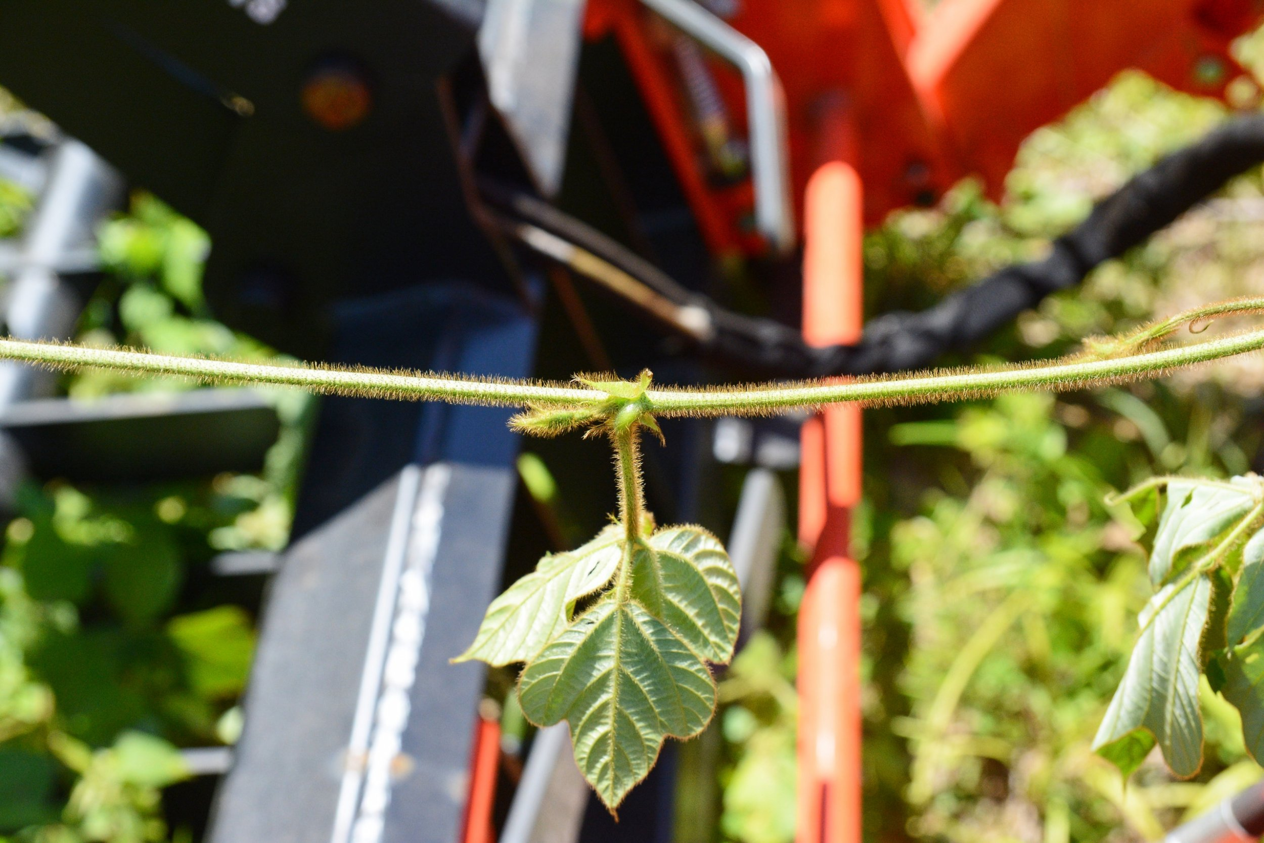

After seeing some kudzu vines in this area while bush hogging last summer, I cleared out the small trees and brush over the winter. Checking on my progress today, I was curious about how much of the kudzu had returned over the last 3-6 months.
This one vine is 20 feet plus long measured from where it comes out of the ground to the end as stretched across my tractor.

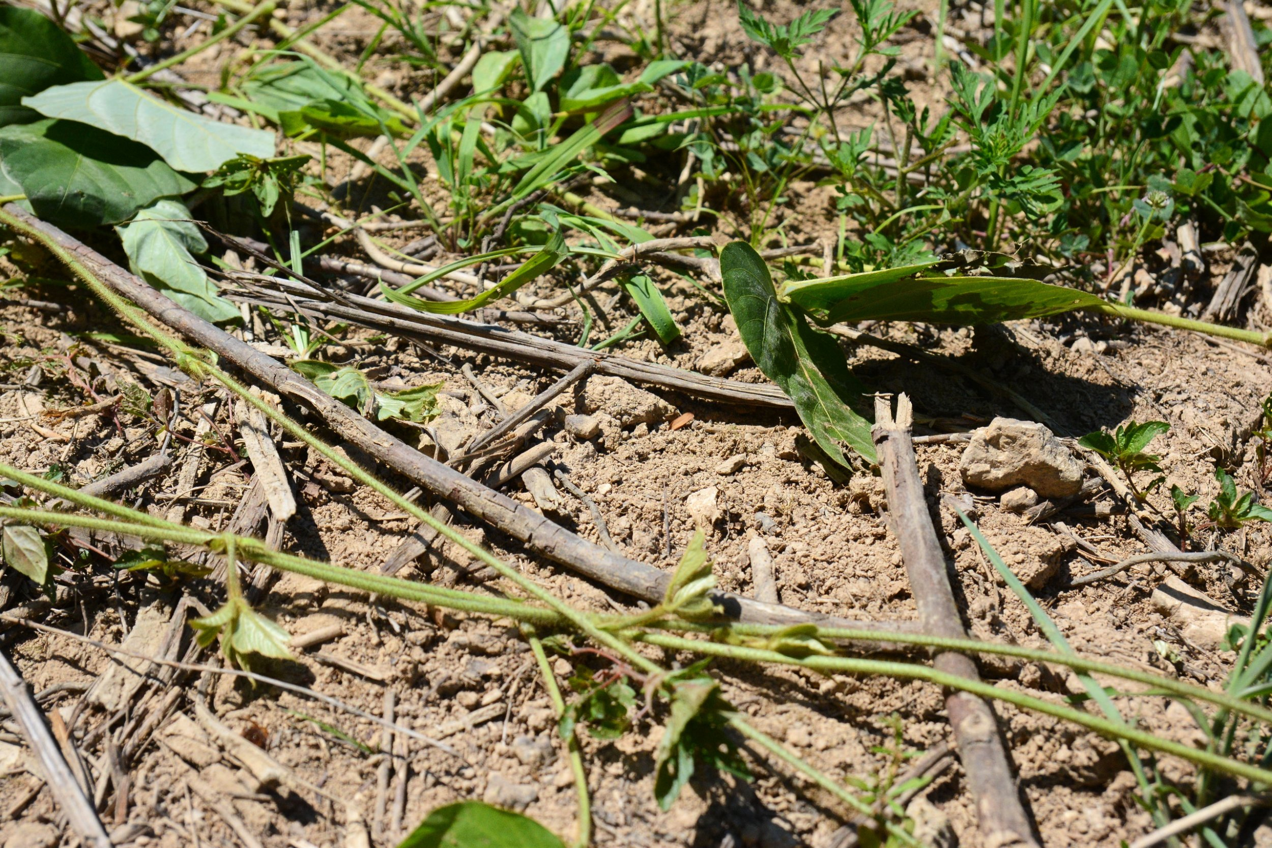

I cut this area with the rotary cutter about 4-6 weeks ago. The cutter didn't even touch the vine because the vine grows a couple inches off the ground beneath where the cutter reaches.
Kudzu can put down roots off the runners. The roots go several feet into the ground.

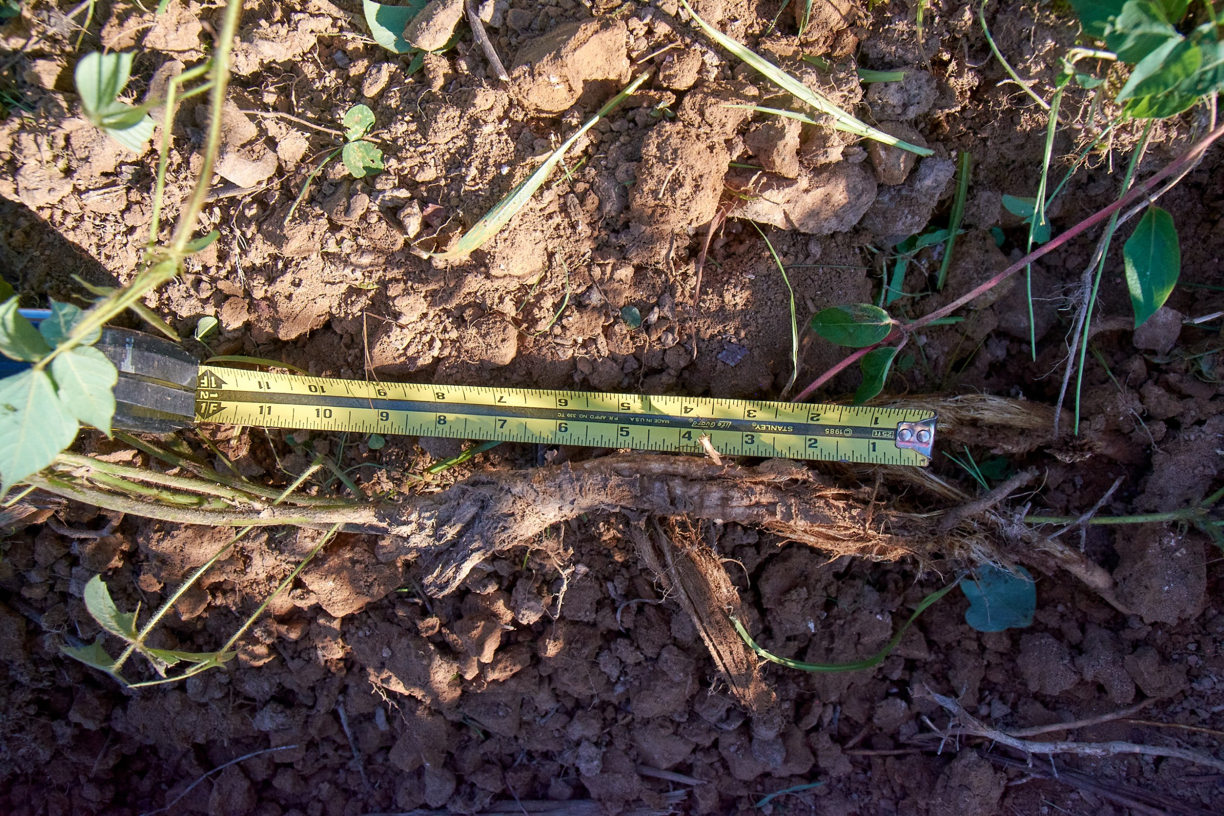

Some say you can kill kudzu if you remove the tuber. It is evidently located in the topsoil even though the roots themselves can be several feet deep.

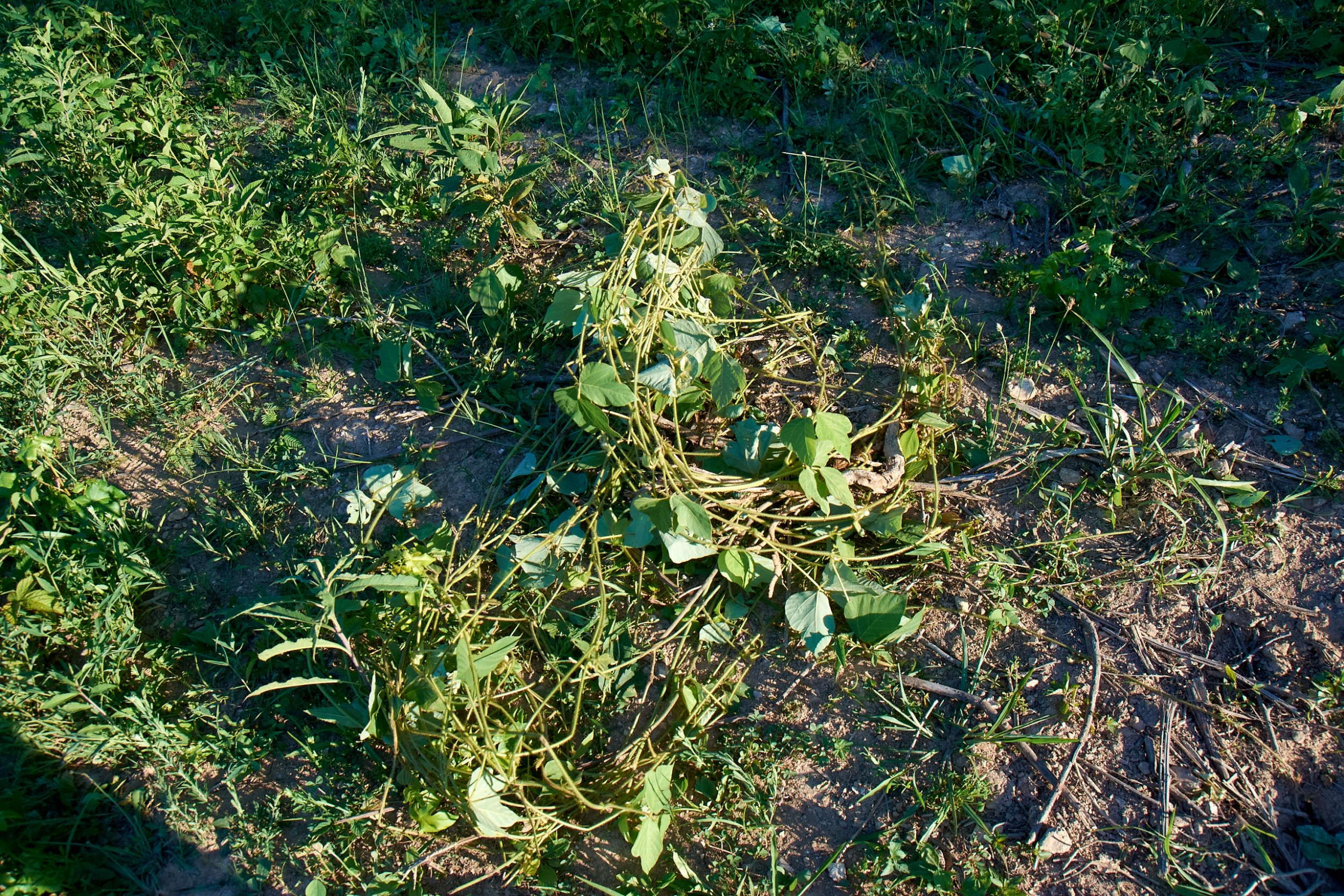

I dug up the tuber for this particular plant to see how big it was relative to the vines. It's about 8 inches long and was feeding 9 vines. The longest vine was not 20'+. It was only 19 1/2 feet. You can see all the vines from this one particular plant in the picture.

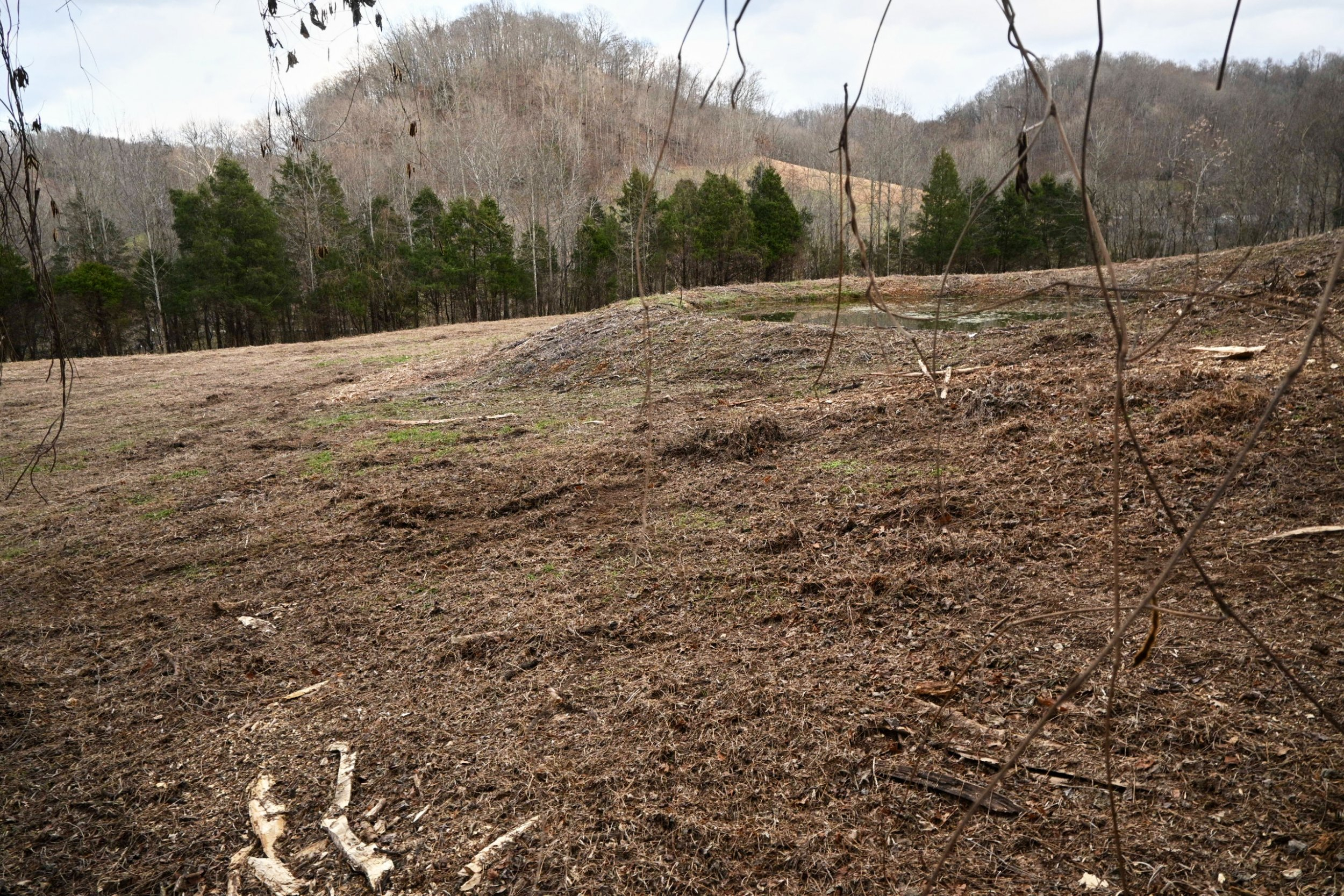

This pond area was mulched for several days with a forestry disc mulcher on a compact track loader 6 months ago. However, the land owner hasn't done anything to control the kudzu in the last 6 months. The area has grown back up because the well established root and tuber system is still there and reproducing new vines. I sort of suspected they thought they had beaten the kudzu when they had it mulched, but ....
It almost seems like when you knock down kudzu in an area, it comes back two or three fold. So you have to be prepared to follow up with additional control measures.
