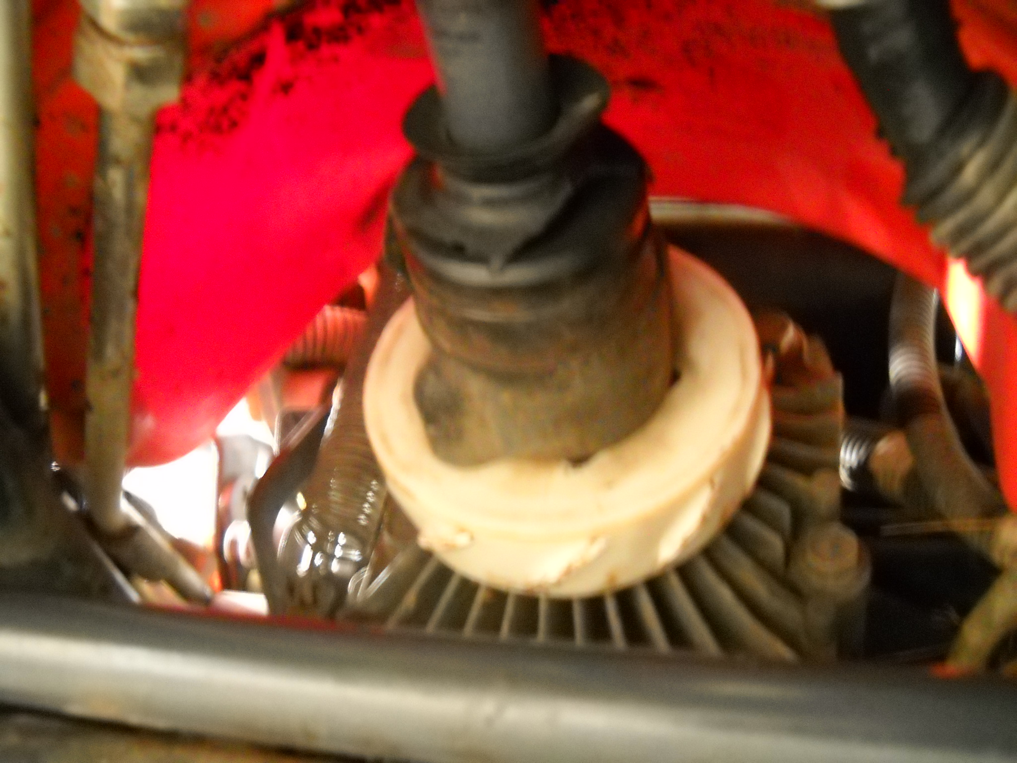

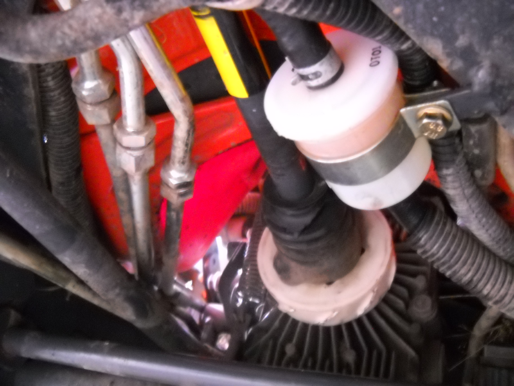

I don't trust my BX 24. First time mowing the tall grass: torn drive shaft boot, broken radiator fan and shroud, fuel pump wiring ripped out. That led to a full set of Bro-tek crunch plates. And a $$$ repair bill.
2nd time mowing that same tall grass: front axle pinion seal wiped out. That led to a home-made guard for the front u-joint and seal - so far so good.
3rd time mowing the tall grass: actually, before mowing. Noticed a puddle of coolant on the ground. Upper radiator hose clamp not sufficiently tightened.
Today (same tall grass) it seemed like I wasn't getting full fwd throttle in low range, but I haven't been on the machine for a while so I just figured my memory was bad. (I could hide my own Easter Eggs at this point, if you get my meaning..) Mowing for 3 or 4 hours, and suddenly could only crawl in forward. Reverse was OK.
Crept down the hill and got it on the trailer. 2 hours of pulling off wheels, poking at every linkage I could find. No joy. My guess was something internal in the transmission. Finally pulled up the access flaps in the the rubber mat on the floor pan. It took a while with my elderly eyes, but I finally spotted a pebble on top of the fwd/rev pedal pivot mechanism outside the frame. It kept the forward pedal from moving more than a few degrees.
How it got there, I'll never know. Why it stayed in place - sheer cussedness I guess. Should have checked there first, but I'm so leery of the machine at this point, I just assumed the worst.

The BX is known for low ground clearance and a soft under-belly.
I too added bro-tek plates and think the money is well spent... had a couple of close calls... a twig hit the hydro cooling fan and a small but stout small branch somehow snagged my fuel line and tore the hose.

I have done quite a bit of bush hogging w/ my little GC. I ALWAYS leave the FEL on and close to the ground. Do you have your FEL on? I mow the pastures and such when the grass is about 3' tall. I have found some grass wrapped around the fan, but not enough to worry about, just a couple of strands. But I always check under the unit at least once a week to check for "gremlin damage" you never know.:cool:

Sounds like the experience I get with my tiller. When ever i use it I break it. :( But after fixing it about 6 or 7 times now, I have successfully used it twice both yesterday and Saturday and it did not break! :D Now I am very happy to have it. :laughing::cool: Lets see, with your BX, watch the fuel filter under the operator platform, my neighbor's BX24 had a plugged filter and ran very poorly because of it. So i went out and got him a filter, replaced it for him, runs like a top. :thumbsup: His hydro fan has no blades on it and i offered to replace that but he is a little leery of letting his 15 year old neighbor take apart his $15k tractor. :eek: Why do i do it? It is a neighborly thing. I like helping out with that kinda stuff and being young, love to learn how to fix it. :thumbsup::)
