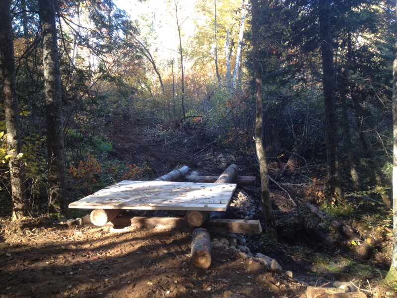

Here's the bridge so far

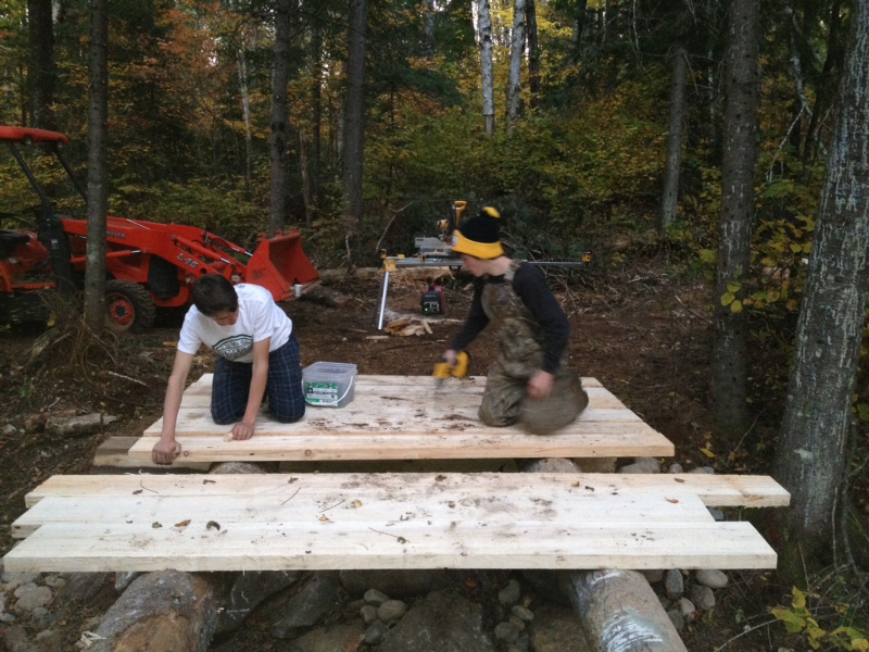

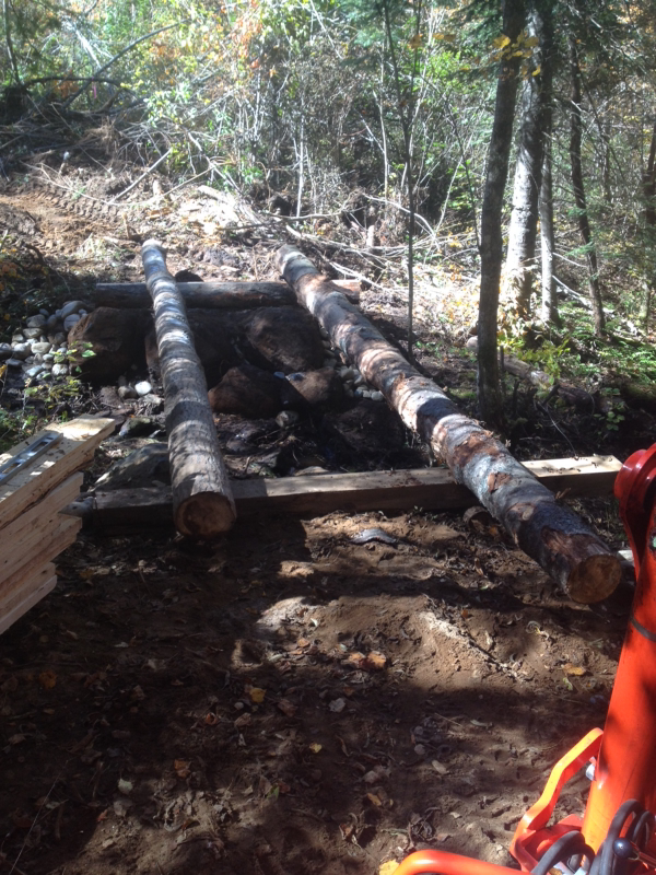

What are you using for the planking? I assume you had them cut for you. They look pretty substantial.
My only comment would be about bracing. I would be concerned about the logs trying to "roll" and loosening the screws through the planks. Maybe lag bolt a few planks across the bottom? Am I being paranoid?
   / The bridge
The decking was cut by a sawmill that came over and sawed for us it's 2x6 or 2x10 and for the logs rolling I will put an end plate going from one log to an other that will hold it all together That's this weekends projects

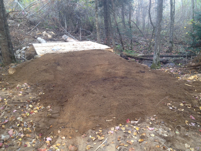

   / The bridge
Now I just need to find some more pine trees to mill up on 300 acres it's gonna be more of a challenge than building the bridge;)
