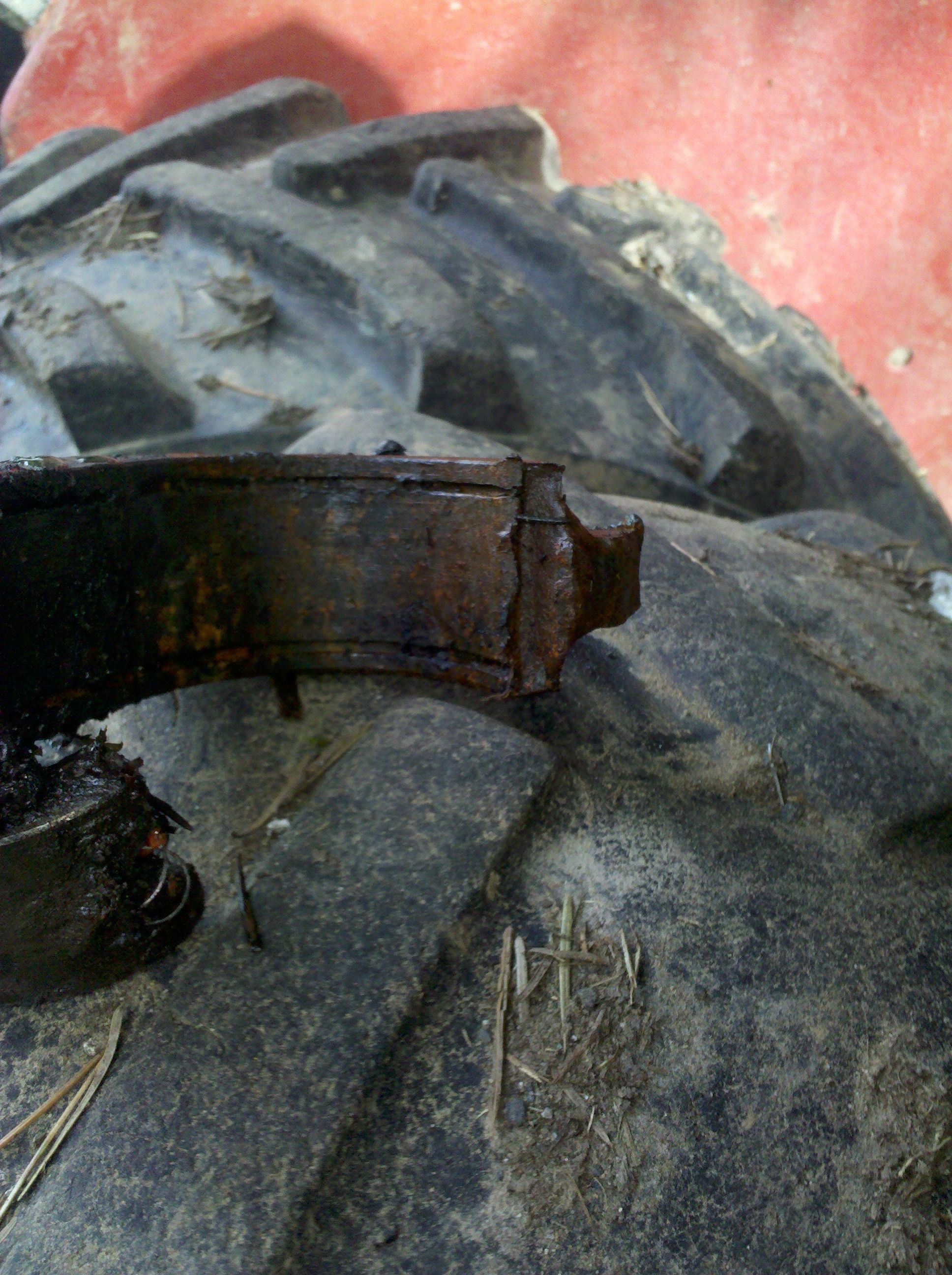

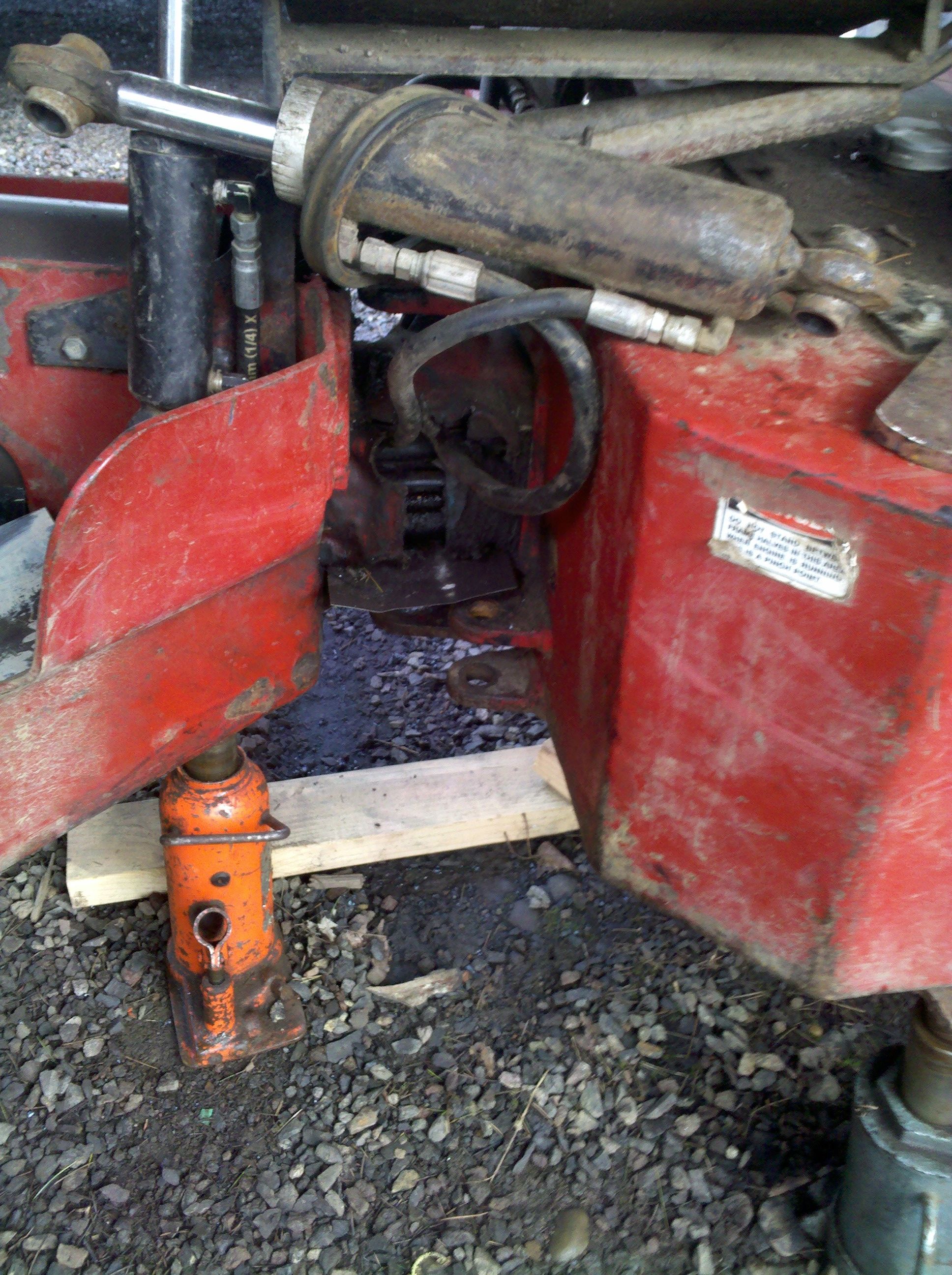

So my buddy has got the connector apart.
2 really bizarre things.
first is that this break happened a LONG time ago. There is significant rust at the break point. Grumble
Second, There is a "bearing" that fits into this that the pin rides in. My mechanic looked at it and exclaimed WOW, this thing is broken. We looked at 2 others and the outer bearing is split. It is a manufacturing process. I will try and get a picture when I can.

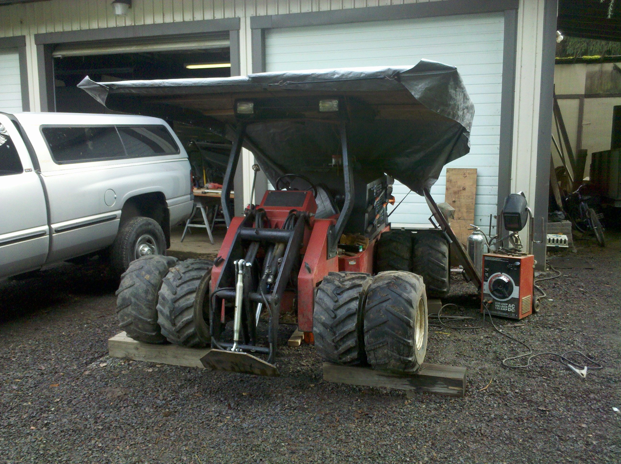

Oh, and I thought you would appreciate the methodology my friend is using to keep the rain off the project.
Car;

It is riding nice and flat (tractor had a sag I could never get rid of). The top and bottom spacers were really worn baddly so now it is sitting quite nice.
The weld is very, very thick, My buddy said that this piece has been replaced once before. In the process of removal the last time apparently they did a number on the wall. So... tomorrow, will take it out and beat it up a bit. crossing my fingers and toes
