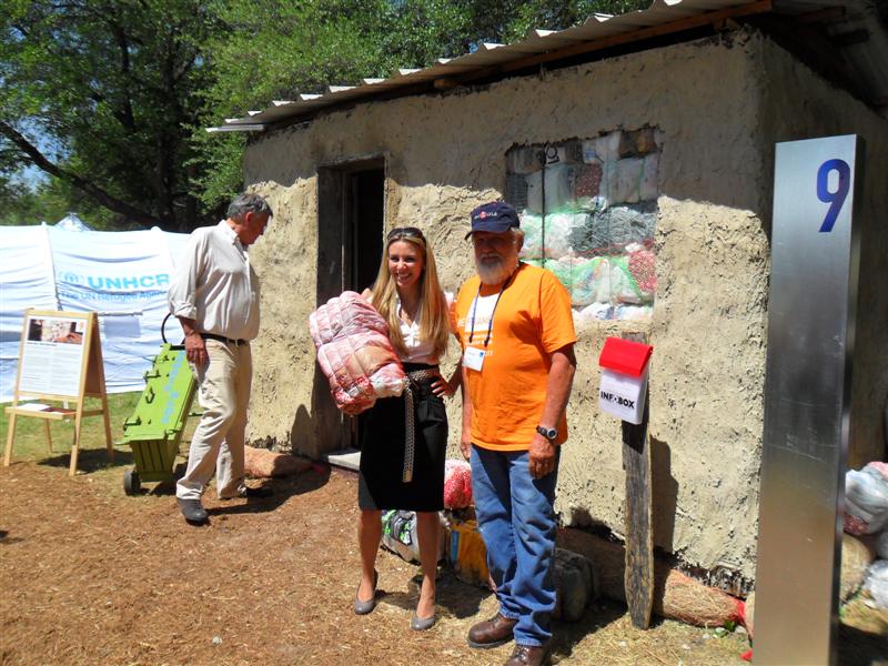

Harv, in some of the pictures areas were left unplastered. Does this let the light in like a window?
Amazing what plastic bottles and plaster can do, it really looks good. I think most people are missing the point on some of the comments on the other site that I read. The house will provide shelter for those who cannot afford shelter and are living in conditions that we cannot comprehend. Just wanted to say you've done one heck of a job.
   / The $300.00 house contest

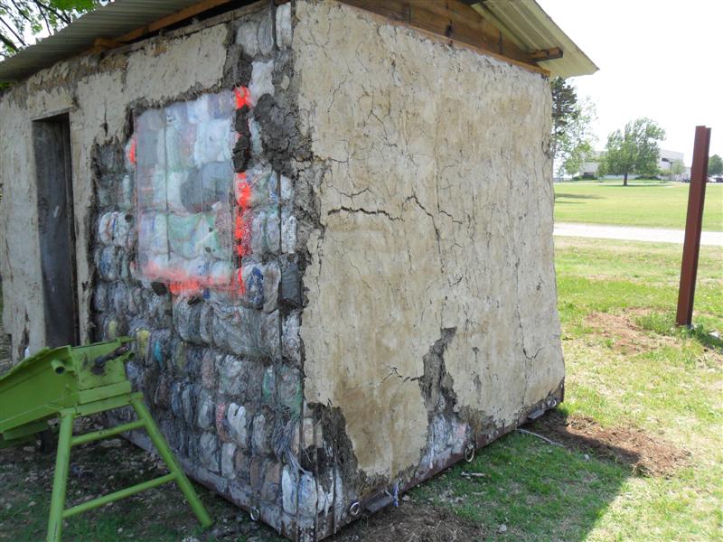

That is a "truth window". It's exposing the construction details so that visitors can see how it was made. You see smaller versions of it in some straw bale houses. What happened was Stephanie Hunt of the Hunt Institute that put on the Hunt Institute Engineering and Humanity week wanted me to leave the interior unfinished so people could see the house was made with plastic trash. My grandsons stayed in the house eandhweek and I wasn't going to leave them exposed to the hazard of a fire. So I plastered the inside for safety reasons and put a truth window outside for the visitors.
The young lady made a block and was down right proud of it, took it home with her too.

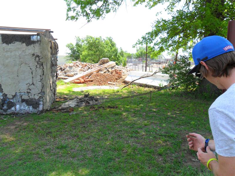

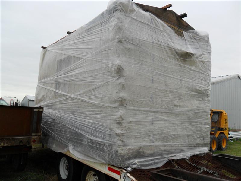

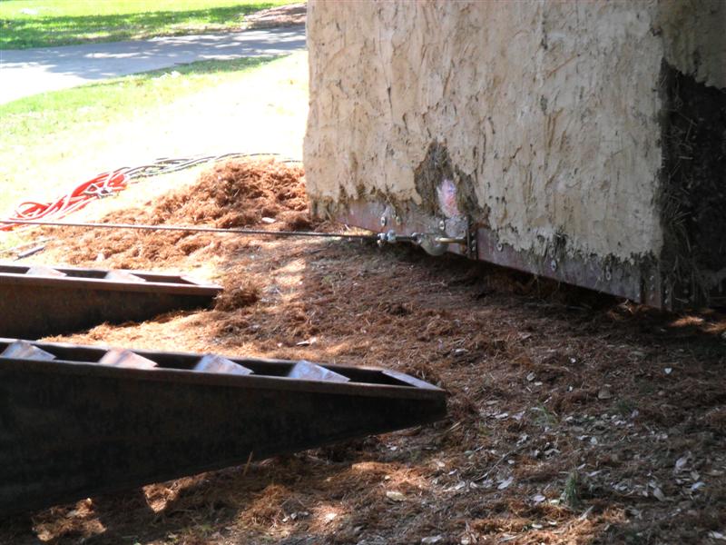

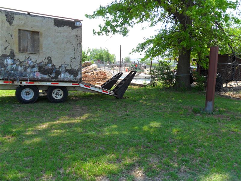

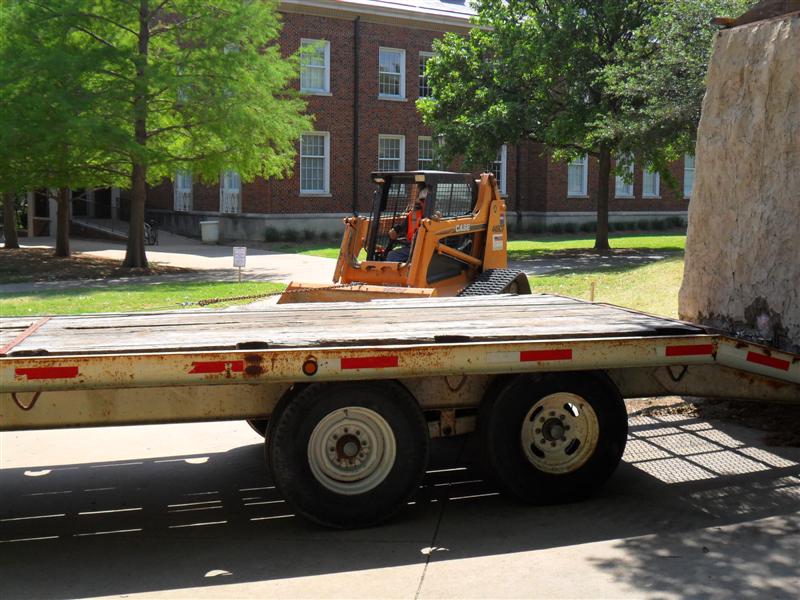

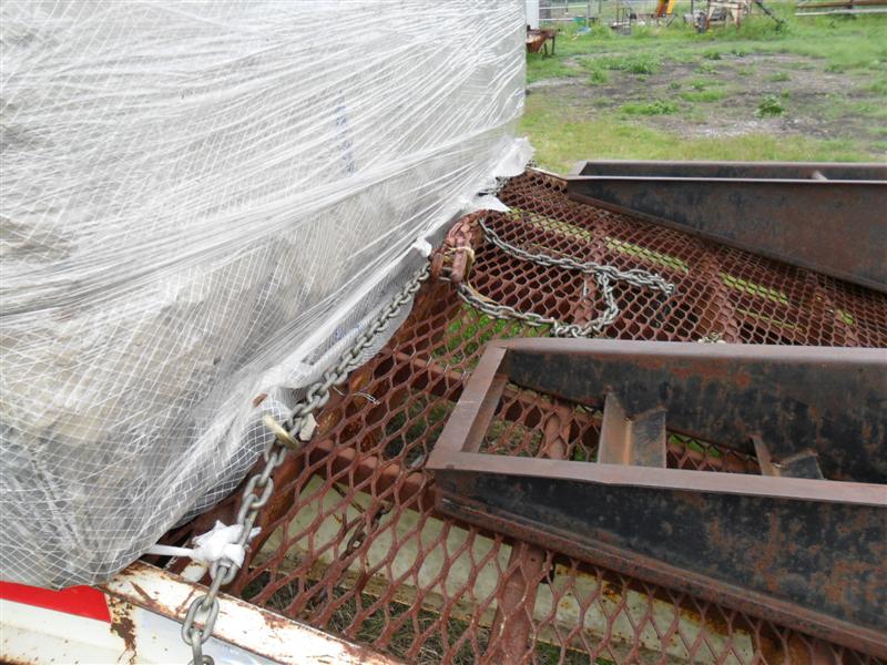

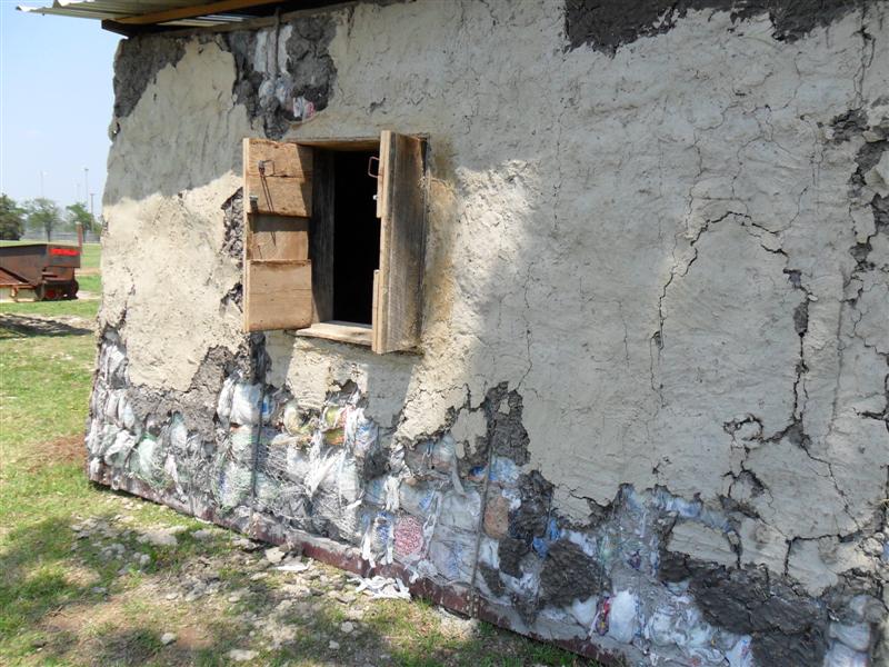

If you get a chance to look at the other entries I would like you to consider how they would done under the conditions we've exposed our house to.
We winched it onto a dovetail trailer. Tied it down by the its foundation. Hauled it from Dallas to OKC at speeds up to seventy miles per hour. When we got to the University of Oklahoma we tied it to a tree and drove out from under it.
It's at OU for structural and environmental testing.....LOL
A couple of points to keep in mind.
1. The building was only secured its foundation. There were no straps over the building to keep it on the trailer. You could call this a redneck seventy mph wind load test over rough roads.
2. The plaster is an earthen plaster, three coats over most of it. It didn't stick real well to the plastic when it was shook like an old fashioned martini at speed.
3. The building was still intact and just as strong before and after its journey. I removed the roof sheets because I was already an inch or two over legal width. I put it back on when we got to OU. That was all we did. The mud plaster has nothing to do with the structural integrity of the building.
