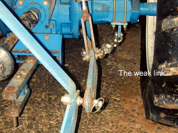

Lloyd, you should be able to find a pretty good price on the old 2120. It would be a fine tractor for most uses. There have been a few problems on our 2120, the biggest being the transmission/engine bolts getting loose as others too have mentioned. The bolt problem was resolved with loctite primer/threadlock. The problem it caused is yet to be resolved, namely, a hydraulic problem inside. Other then that, a few minor problems like weak draft links (see picture). The tractors works well, reasonably powerful, good loader, good power steering, shifting is OK, ours has low, medium, high range with 4 gears for each. High is rarely used, medium most of the time however we use low for hard loader use. Rat...

Yes,Rat I had the same problems with my draft links too.I have a Norse winch on the back of mine.A 1 inch by 4 inch flat stock fixed them right up.I had the 1 inch vertical and the 4 inch horzital.Never bent them again. thefarm

Does anyone have an idea what year they went to the weaker links? I understand the older ones were beefier.

Yikes... The lower lift arms on my 1920 are beefier than that. Mine are I guess 3" x 7/8. I'm quite sure I would shear off the lower link pins than bend one of those arms.
Mine was made in 97.. wonder why the 21's have wimpy arms considering it is a bigger machine???
