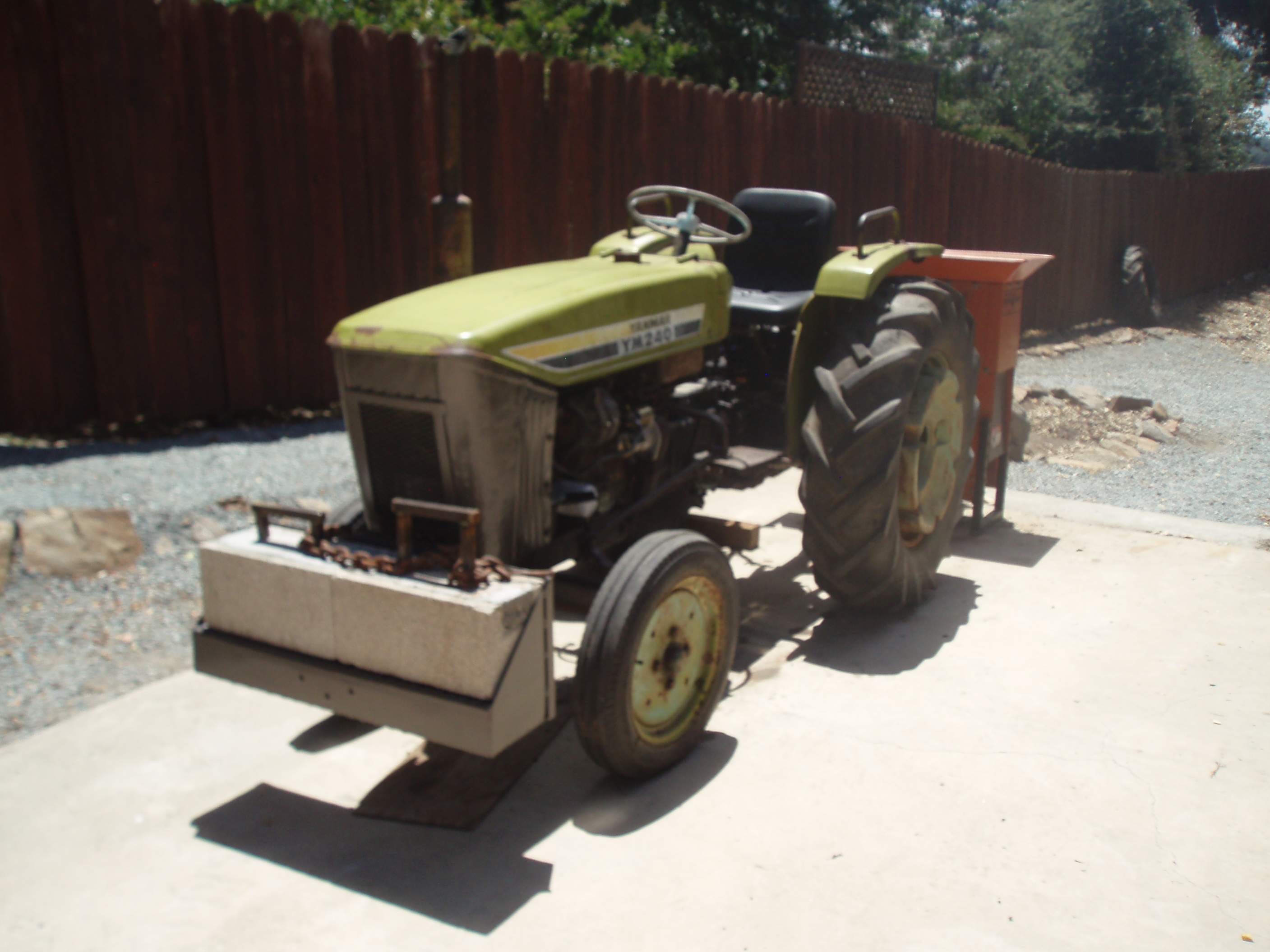

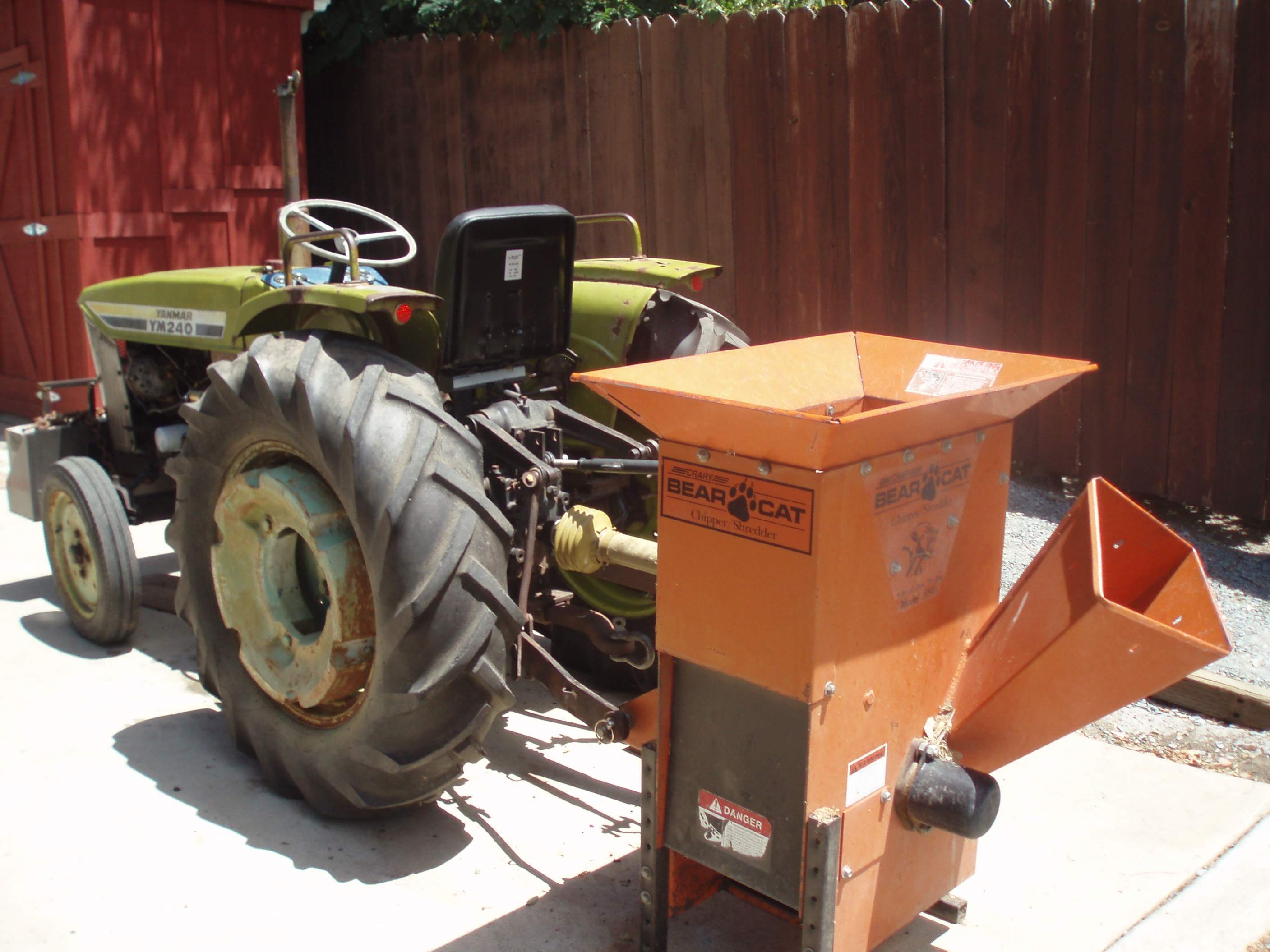

Many Thanks to all of you guys that nursed me along with my Ym240 project. The Tractor has my Bearcat 554 chipper on it, and the two together take care of alot of work! If anyone tackles a similar project, and wants to know a novices experiences, I'll try to add my two cents. Thanks again, jbrd

Didn't you post this like a month ago? With the same pics.
   / Thanks/Ym240 Project
Yes , Just wanted to acknowledge my appreciation for all the help.jbrd
   / Thanks/Ym240 Project #4
I'm glad to hear it is all back together and running great.
What did it take to get the cylinder sleeves out? After the struggle I had getting injectors out, I would be afraid to tackle sleeves.
And if you don't mind, what should an overhaul like that cost?
To get the sleeves out I made my own puller out of 3/4" threaded rod with a piece of 5/8" x 2 1/2" spring steel cut to the size of the sleeve for the bottom, and two pieces of 3/16" x 1 1/2" flat stock welded together for the top with holes drilled for the threaded rod and the stud rests. LOTS of wd40 & PB blaster soaking, I cranked down on the threaded nut until the top bars would flex then get under the tractor and BEAT on the bottom plate until the top plate was straight, then turn the top bars over, etc, After my first half a dozen trips doing this I did get some dry ice and pack the sleeves with it and that did make the first and the remaining cylinder go a little easier. The pistons with rings (OEM) and the sleeves ran right at $500.00. So add the head gasket, and other necessary gaskets, rod bearings and bushings as needed for a pretty good idea. One very important thing from my experience is when you have the head done use OEM valve springs. I broke two intake springs the first time I put it back together after running it for approximately 4 hrs. One question for you- Which Power Service do you use in your 240? I've been using the white bottle. Thanks, jbrd
