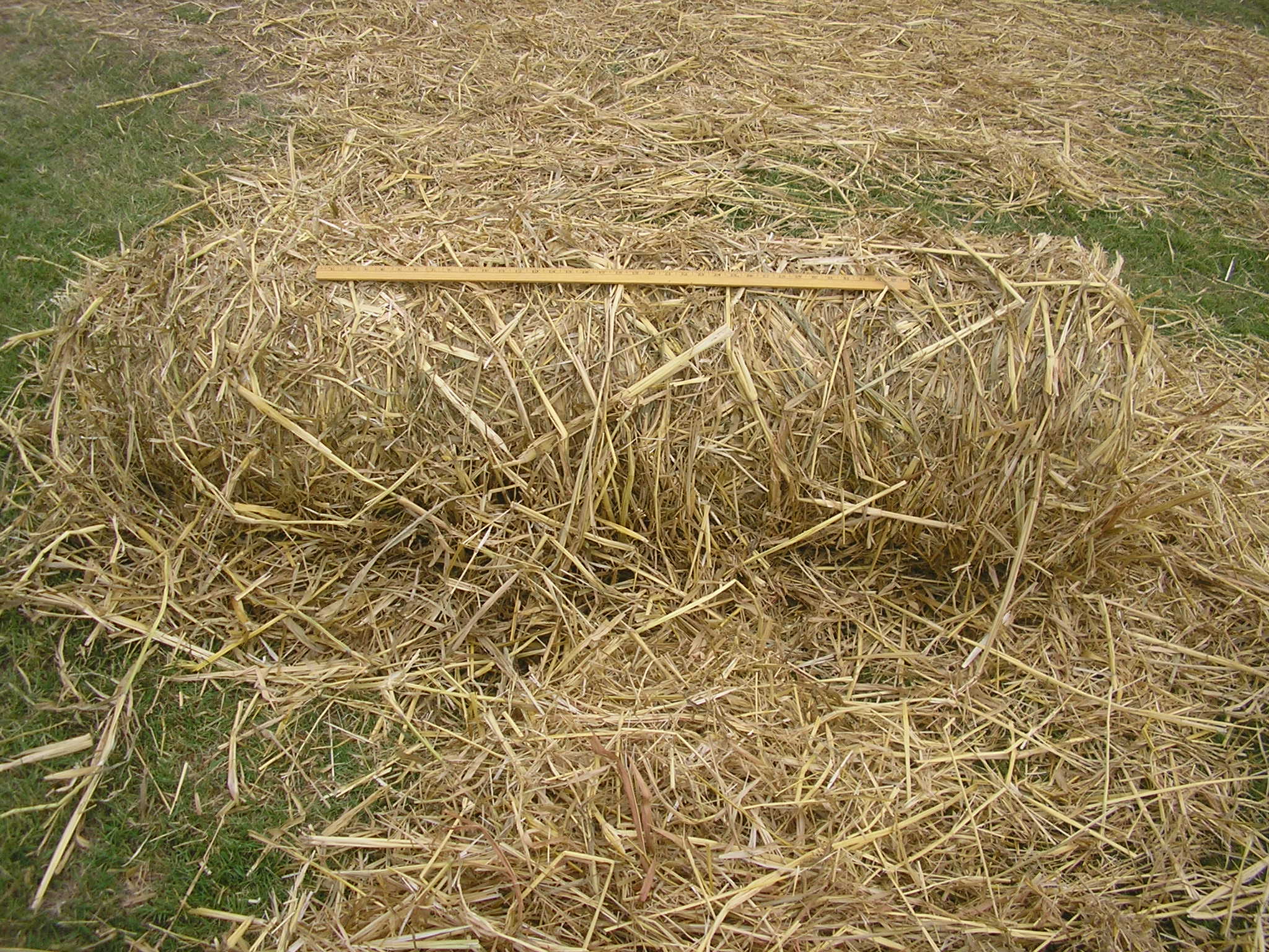

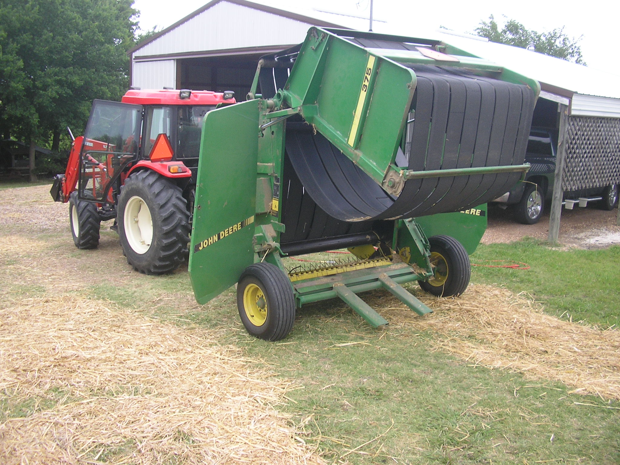

Since I had hay everywhere and where to start, I thought I'd ww the first round and bale it getting it out of the way so that I could start to work the rest.
The ww was so high that it repeatedly got tangled up in the baler tongue so I ran down it with the tires on the 2000 to flatten it and then made a shield like I think I saw in the 1209 owner's manual to deflect the hay.

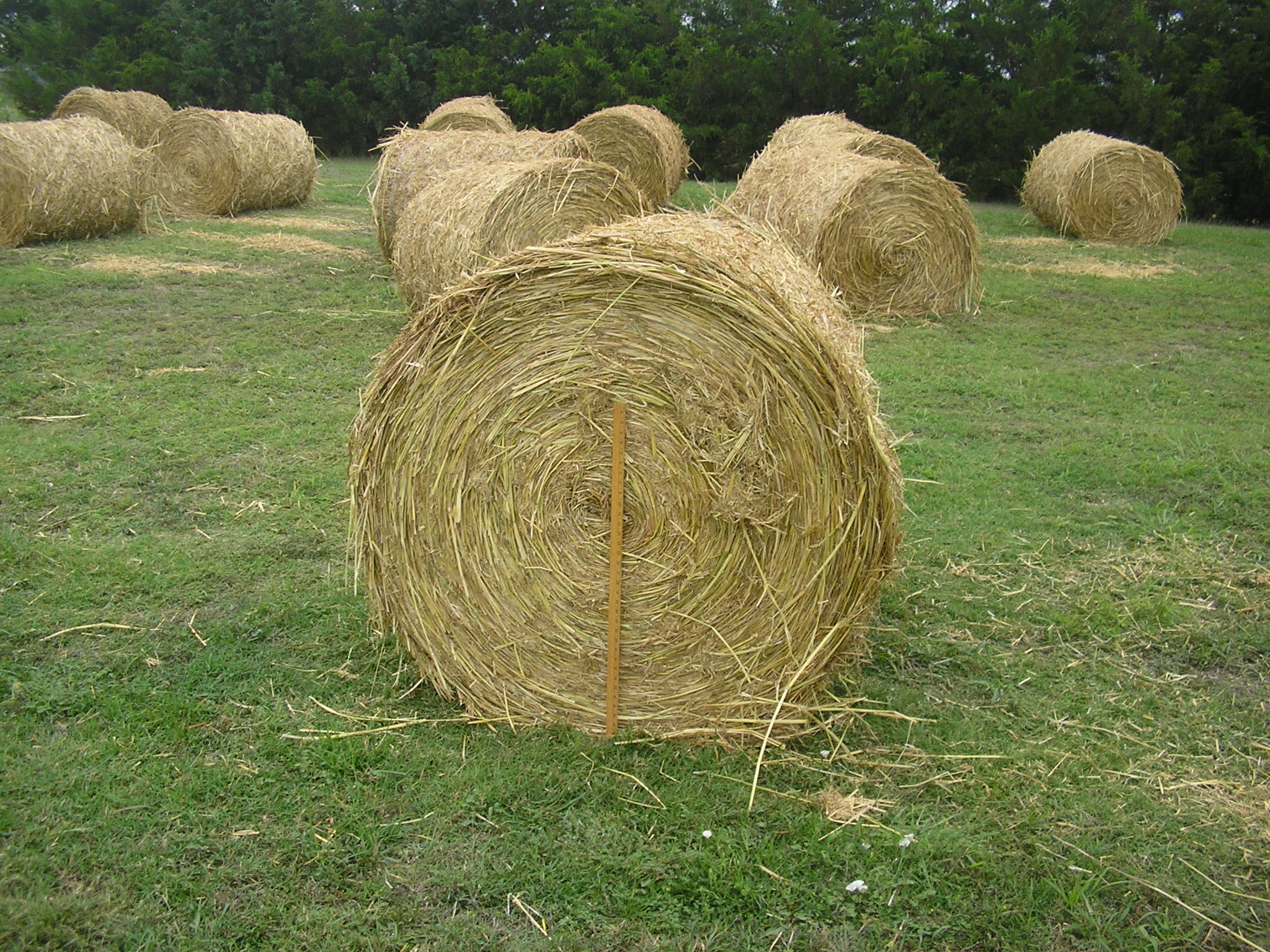

I got half way around the field and realized this just wasn't working. The hay was scattered all over the field with mounds here and there, especially around the 2 bad corners. It was plentiful and not too high. I wondered if the pickup on the 375 could reach out and pull in from the sides without it getting all tangled up.
I guess the long stems helped on this one as I got about 40% of the field baled yesterday afternoon without a hitch. Interesting thing, maybe due to stems again, maybe just because the mouth had plenty of hay to fill it, but the bales are the best looking bales I did yet with this baler.
One thing I did notice however, my little Cummins worked it's fanny off as with the hot afternoon, AC, hyd. fluid cooling coil, and amount of hay the baler was digesting, she ran around center scale on the temp gauge and slightly above, having never done that before.
So, I guess there is light at the end of the tunnel.
I thought you might be interested in this method of baling when and if you get into a similar situation, if you haven't already tried it in the past. One thing for sure. The throat on the JD works, being it open or closed; assume open.
