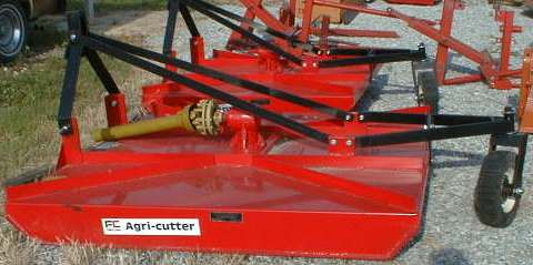

I do appreciate your help though... I've been meaning to ask you, how do you like your Fred Cain rotary cutter? Do you have any picture you can post of it... I think that brand is mostly regional in the south/sw area...
<hr></blockquote>
John:
I missed your comments on the Fred Cain mower. I've attached a pic I found on the net -- not mine, but all the single-spindle mowers look exactly the same. The size just changes.
Basically, these are about as ugly a mower as you've find. Very shoddy [albeit thick] paint jobs, too -- mine has "drip lines" on one whole end. However, they are fairly bulletproof. I've never mic'ed one, but comparing them next to the heavy Bush Hog models at the dealer, the decks look a bit thicker and the bracing on the top is comparable. My 60in mower priced out about $75 cheaper than the light duty Bush Hog model!
I have only a few dents in the sides from hitting some super big rocks hidden in some deep weeds. The blades might need replacement, but it would be hard to wear out the deck, and in the 5 years the dealer has been carrying the line, they've never once had to open up a gear box, even on the multi-spindle models or behind the bigger tractors. Also, I like having no chains on the back, which seem to get in your way when you've going backwards over heavy brush.
Anyway, hope that satisfies your curiosity.
