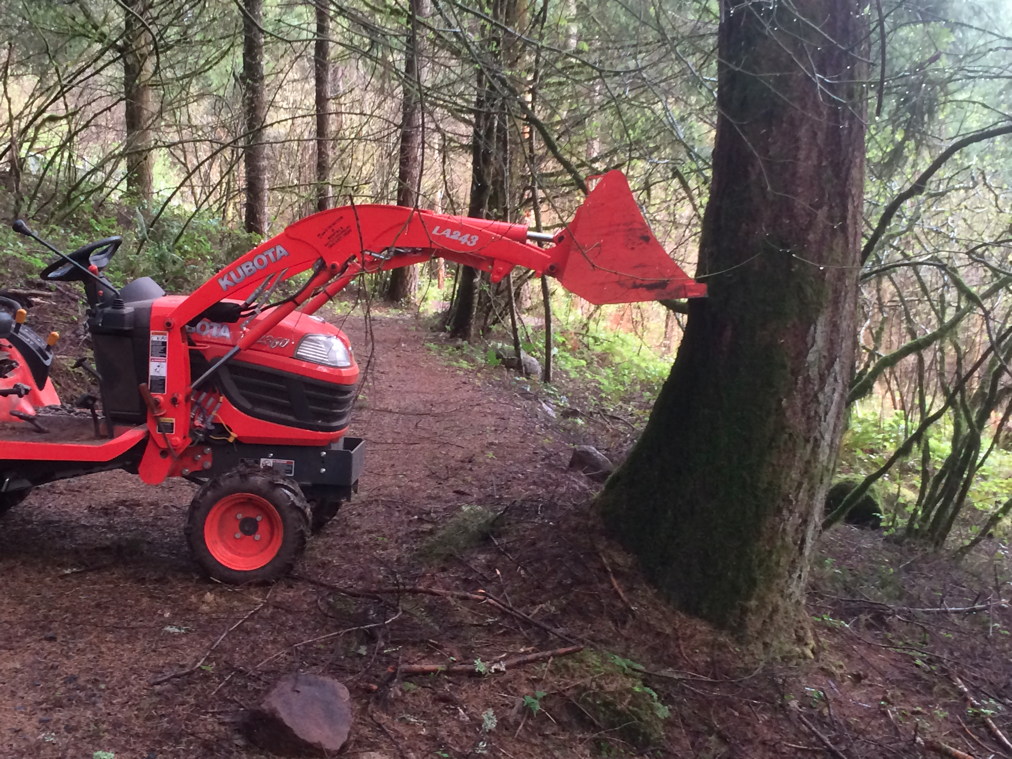

I've built tractor and Jeep trails across my slopes, just using the loader (No backhoe). Make a level starting place, dig with the uphill corner of the bucket, then dump on the downhill side. I never got close to tipping over, except once--watch out for large boulders rolling across to the downhill side of the bucket!
A toothbar was a great help!
Sometimes you need to scoot a fir tree out of the way. :)
Bruce
