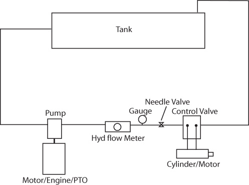

The 5 gallon bucket is an interesting and ingenious approach and I may have use it if I can't find the capacity of my pump. The pump I have is a Prince C-387 and it is similar to the one J.J. linked me to.
While back I did inquire the company about the specs, but do you think they would give me specifics? Nooo!, they just linked to newer models, but no straight answer.
Anyway, I just about convinced myself to install the tank in back of the seat.
The tank I have is about 5 gallons which should be sized with the pump I am using. Tank capacity 2X pump gpm. Is this the general rule? Or can I go 1X1 for a loader?
I guess before I do anything I need to find the pump gpm. Does anybody have a clue about the capacity of this Prince C-387 pump? I would love to hear from you.
I have an attached sketch of the test system I have in mind, minus flow meter (these meters are gorgeous, but pricey, maybe later, right now I have other priorities).
Just want to confirm if this system is doable.
Thanks for all the help so far.

I do not like a few things on your test set up.
First a safety issue! There have to be a relief valve between the pump and the needle valve!!!
Second, I want the pressure gauge before the flow meter (this is of minor importance, but will include, the very small, pressure difference caused by the flow meter)

If you have a larger hydraulic motor with a known displacement, one can hook the motor on a work port (return to tank). Put the needle valve between the Control valve and the motor.....use PRV in control valve for safety...
No put a counter on the motor shaft, to count how many turn it makes over 30 seconds....
Note that there shall be NO LOAD on the motor shaft....
if motor displacement is 1 cui and it makes 691 turns in 30 seconds the pump flow is 6.0 GPM.....internal leakage in control valve uncounted for, can be eliminated if control valve is excluded, and replaced with a PRV.....no bucket needed....
