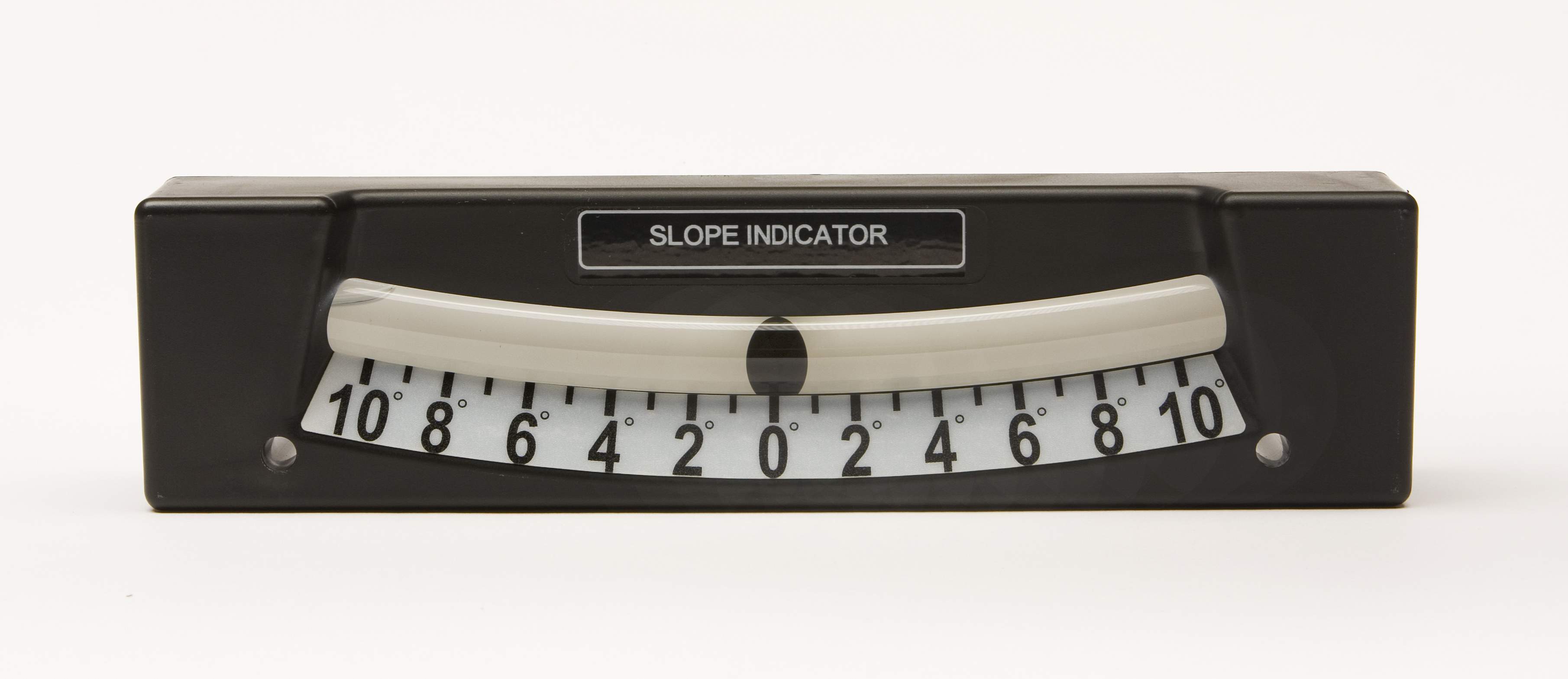

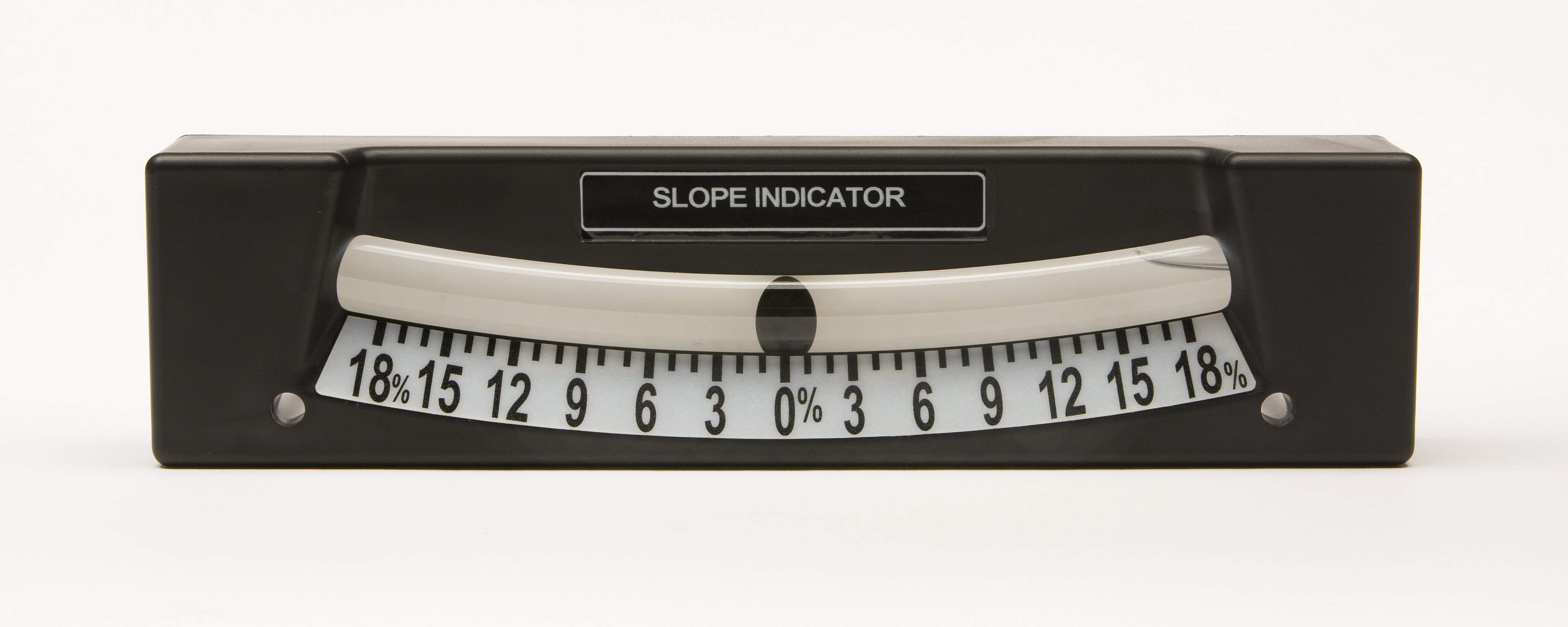

I posted this earlier in the wrong spot. We have a new tiltmeter designed to
use on the blade of a dozer or grader. It mounts with heavy magnets, and
I have 2 left that read in percent, and one left in degrees.
You may remember, we have asked TBN members for their input on some of
our meters. Found the best testers are the ones in the field that actually
use them. They are designed for road crowning, and or precision leveling, etc.
Too small a scale (10 degrees, or 18%) for rollover use. We will supply the
meters free, and you may keep them after testing. We only ask that you give
them a fair trial, and post your comments here for all to see. Good or bad,
we appreciate your input.

You sent me one of the degree type about 2 weeks ago for my dozer. It works great for grading house pads and general leveling. The major problem I have is that it needs the magnets to be on the bottom so that it will stand up in vertical position. I use mine on top of my dash panel and the only way to see it is to stand it up, but your magnet only covers the solid back part. My only remedy is to mount a piece of angle to my dash to make the meter stand vertical.:( Other than that it is a very handy tool for anyone doing grading or leveling type of work.:) I thank you very much for the chance to try it and will and have shown it to a lot of other equipment operators around here. It would really help tho if you could make it so that it will stand up in a vertical position.
Again, thanks and all the best to you guys!!:) By the way, I got it within 3 days of replying to your post here! Really fast and didn't expect that kind of service for something that was free and to test!!
Thanks again,
Fred Burchfield
Canton, Texas
reddog848@gmail.com
