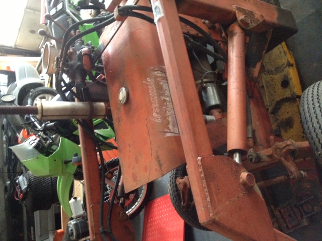

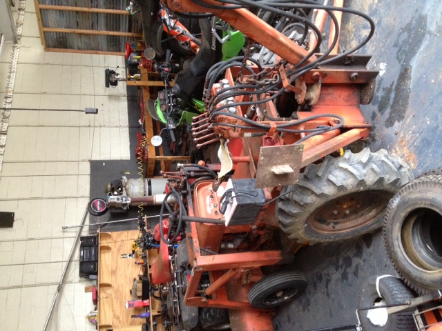

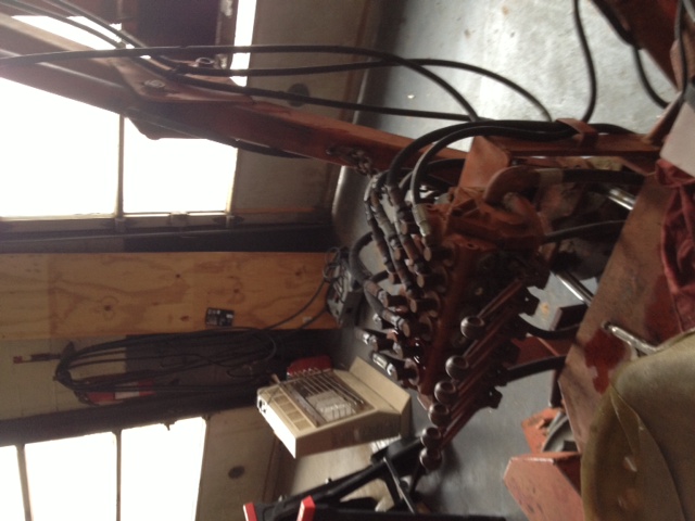

image.jpegimage (2).jpegimage (3).jpegThanks for the welcome.
I did call them and they really dont have any parts book or service manual for this model. So Im trying to see if anyone else has anything. I didnt pay much for it $900.00 and I just started fixing things boom cylinder is leaking and has no real power to it. I tore the cylinder apart and all seals are just about gone. i found a place in oklahoma city who ordered me a seal kit for it. everyone of the hoses rubber is just falling off but there not leaking so im going to replace hoses as needed and rebuild the cylinders one buy one. Ill try and figure out how to send pictures here!

Thats a great deal on the T3! 99% sure it is an Power King/Economy Tractor with the terramite bucket and backhoe......you can google economy king for sites and people that know about these tractors.
Thanks for the pictures.

I'm nearly finished with cylinders and hose's 5 new cylinders and 2 that i rebuilt. pretty soon paint job.
