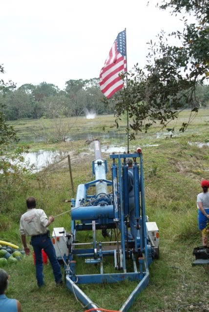

@ Spudgunner,
Not to make light of your trials...but your nic simply overcomes me!
There are few things in life that are as fun as watching common items go uncommon speeds and distances and are destroyed beyond all recognition.
I'd like to think earning my keep with a TC would be right up there with spudgunning. (I'm imagineering a slogan as we speak)
"Uncommonly fast and efficient plowing"
(I dunno...mebbie a bad joke?)
In reverence of your nic and all the fun I've had spudding, I posted this video on YouTube to bring a smile to your face in the face of breakdowns.....and remind you it is just a machine and if it ain't working right you gotta keep looking.
Here is the direct link:
YouTube - Gallup's WaterDawg

Outstanding!!!
I've also seen pics of "Bowling Ball Mortars" made out of gas cylinders (the kind welders haul around with them).
