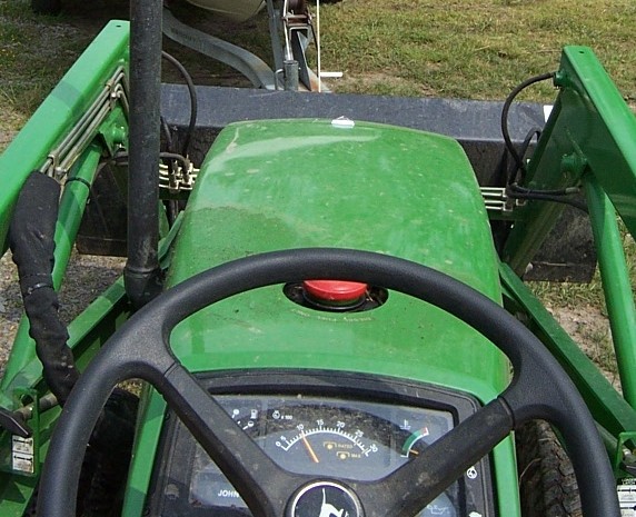

Is the reading on the temperature gauge shown in the attached photo normal? It takes quite a while just to get to the shown reading...

Unless you have steam coming out of the overflow with the gauge showing normal temp, I don't think you have a problem...
The gauge on my JD 790 starts well below the green when cold an does take several minutes to reach operating temp. The gauge will remain in the first quarter of the green, just a little higher then the gauge in your picture...

I've a 670. My temp gage indicates just about where yours is at normal operation. Takes about 5 to 10 minutes to get there. The JD Manual does say something about checking the thermostat if your engine is running cool. I don't think that's the case, however...reckon it's the nature of the beast.

If one touches the Rad or the return coolant hose to the engine you can get a pretty good idea of the operating temperature of the engine.

I'd say yes. Diesels run a lot cooler than gas to begin with, and most of us rarely work our compacts hard enough to get 'em hot anyway.

Don't worry about it Buck. The guage on my 4710 also is like this with no problems. If this proves to be a problem, then I'd rather cope with this than having the needle over in the red zone. /w3tcompact/icons/wink.gif
