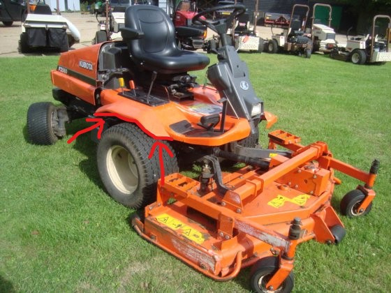

I have a kubota F2560 Mower. Getting ready for the summer I pressure washed it. There was a ton of grass and dirt on top of the drive train under the body and fender cowling. I probably washed out a couple of hundred lbs of crap from under there. Anyway, ever since doing this, the temperature gauge rises to about 1/2 way right after I start it. If I throttle it up it pegs it over to full HOT. I'm positive that the engine isn't really hot and I've tried unplugging from the temperature probe on the engine but it still does it.
I've let it sit and dry for a couple of weeks but it still does it. Any idea what I should look at and for?

Sadly, yes. I was shocked.
I'm ashamed to say that I never really looked under that seating deck and had no clue that it could hold that much crap. I actually had to go back to my pressure washer 3 times to get it all and the reality is that I didn't. There are still little pockets of hardened grass and dirt under there.
Looking at this pic, I've got a line with arrows. There is what looks to be a small space but it goes all the way across and holds a lot.
