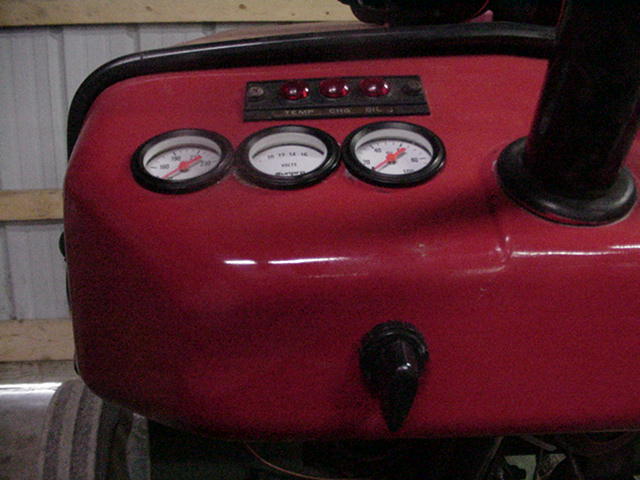

I want to add a temp guage to my YM2000 and need some help. Does anyone have any brand recommendations due to the vibration. Also electric versus mechanical and the metric adapters need. Any help would be appreciated.
   / Temp Guage YM2000 #2
There is a ton of good information contained in this forum. Do a search for "gauges" and for "guages" (the other kind of gauges /forums/images/graemlins/grin.gif) and you will get several hits. A lot of people have posted part numbers for Sunpro gauges and adapter kits, etc. Like I said, a ton of info! I used Sunpro 1.5" gauges for my 2210. I just got a 3 gauge set, cut holes in the dash and mounted them directly into the dash (see attached photo). There are a couple of adapters you will need for the oil pressure and for the water temp. I had no problem finding the one for the oil pressure, but looked for several hours for the one for the water temp. I finally found it at NAPA, although pricey compaired to the Sunpro kit. I think most people have went with mechanical gauges. Good luck, let me know if I can help!

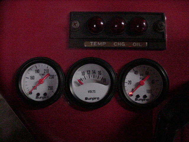

Another picture...

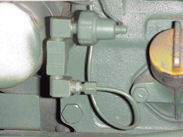

Finally one more of the pil pressure tee and elbow connections. I got this idea from another post here on TBN. It allows you to keep both the gauge and dummy light. From what I have read, this is not an option with the water temp.

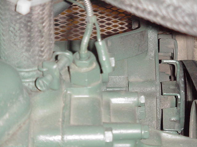

Here is the water temp connection...
