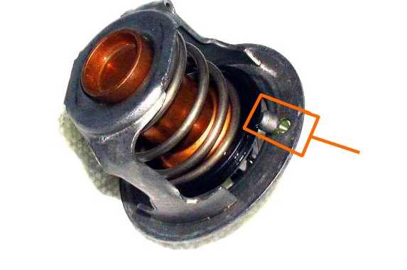

Several of us have had thermostats fail. There is a little bleed valve that gets stuck in the open thermostat (bad design problem). It holds the thermostat open and the engine never heats up.

Here is a picture of the problem many of us have had. The little stuck pin is highlighted in orange and you can see it is holding the thermostat open.

I took the thermostat out today and the "ball" did have it locked open. I clipped it off ,put a new gasket on and refill with antifreeze. started it up and let it idol for maybe 30 min. The temp hand still only moved maybe an 1/8 in. Talked with the dealer and he said a new thermostat was $30. I hate to pay that for one if that is not the problem. It is in the mid 40's here so surely in 30 min it should be up to temp. Where should I go next. Does it sound like the sender now or still maybe bad thermostat. I took the rad cap off and could put my finger in after 30 min. It was warm but not hot.I could hold my finger in it.
