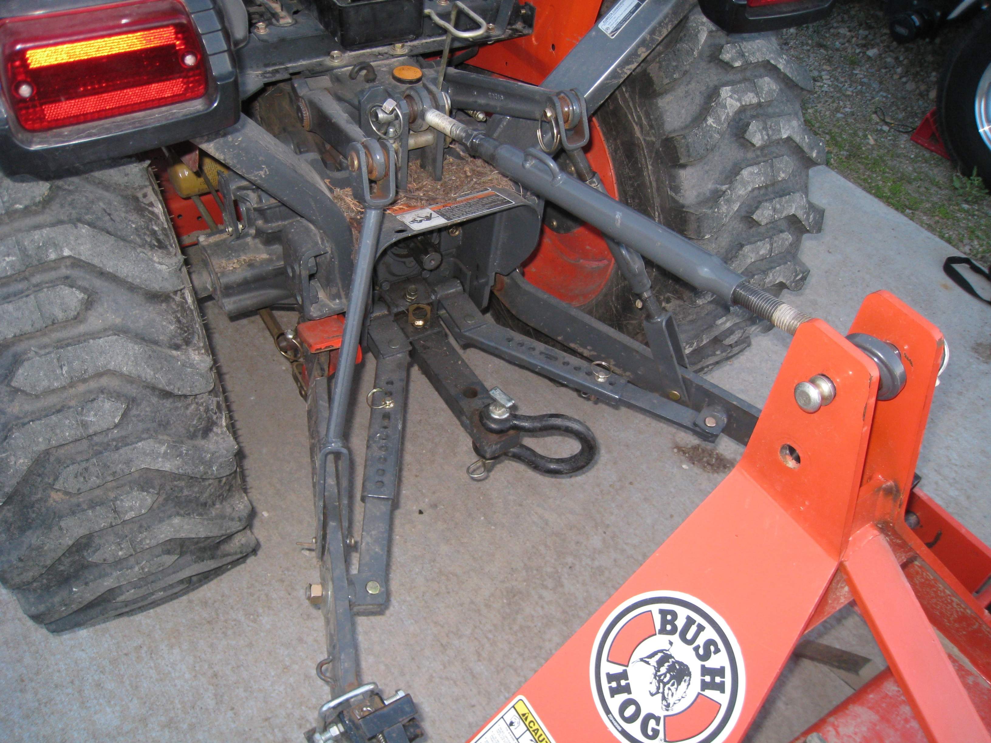

   / Telescoping Stabilizers #4
I put them on my B2920 and I think they are a huge improvement. They hold the arms out and set to whatever width I want so with the Pat's system, I can just back up to the implement and it is set. It also has slots so you can put the pins in there and have a little sway. I use that when I have the rotary mower on so if I bump a tree there is not so much shock to the tractor. They came without instructions, but you don't have to be a rocket scientist to figure them out.
   / Telescoping Stabilizers #5
Word of warning. I have a B3030. It comes standard with the telescoping stabilizers. I also have a BX with turnbuckles. I like the tele. stabs. but you have to be careful with them because they will not take compression. The inner bar will bend, especially if there is a hole outside of the outer box. The larger Kubotas use a box for the inner slider (resists bending). This is not a problem if you make sure one of the stabilizers is in tension before the other goes into compression. I raise the implement and push it to one side and then the other to check this. Since I have been doing this, I have not bent another stabilizer. It is hard to get the turnbuckles to go into compression due to the way they are mounted. Had I not put Pat's easy change on my BX, I would be looking at sliding stablizers for it, but now with Pat's on I don't often have to adjust the turnbuckles.
