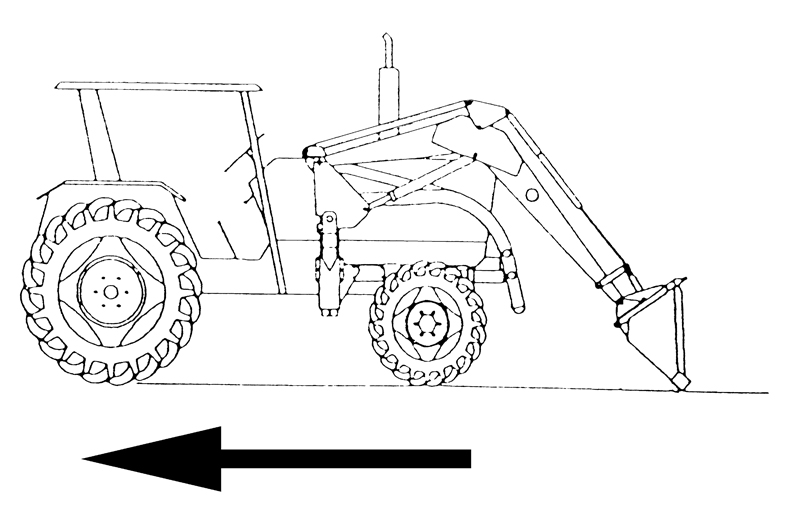

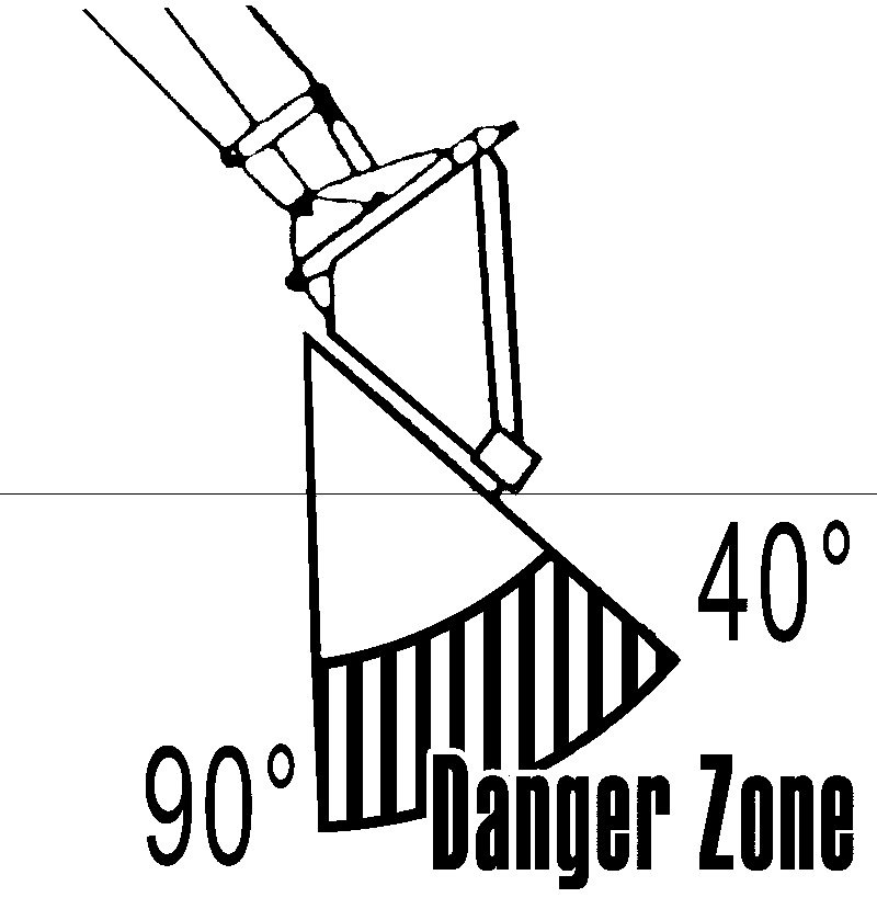

Whitey said:
I am going to remove about 4" - 6" of packed material from my irregular shaped driveway this summer and replace it with limestone. My question is......I am torn between buying a tooth bar for my 60" FEL or a 60" RB or a 60" BB for the removal. Price being a factor along with the future usage of the equipment. Backblading with a tooth bar to loosen up the material seems like the logical choice, low price along with future usage. I just don't think I would use a RB or BB as much as a tooth bar. Anyone out there care to weigh in???
JD 770 / 70 FEL / 7 BH - 425 AWS / 54" MMM / 54" FMP
Be careful Backblading in this position. It can be "very" tough on any loader's bucket cylinders. With the rams fully extended they are exposed and are at a vunerable position. Down pressure from the lift cylinder's can bend the bucket cylinder rams.
I'd agree with RFB - a box blade and ripper may be more efficient depending on the lengh of the drive.

Thanks everyone for your experiences and opinions! This is why this site is so great! I never even considered the "Danger Zone" for my FEL cylinders :eek: I am thankful for that post. It looks as if the BB (boxblade) has won out. I forgot to mention that my wife will be doing this so the easier the better. I think that after it's initial useage the box blade may be forced into other projects. :rolleyes: Give my wife enough time and she may reconfigure the entire property.:D
