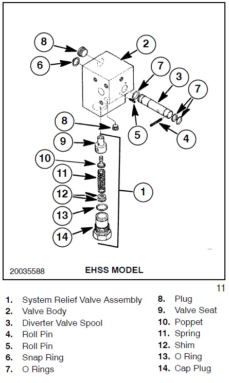

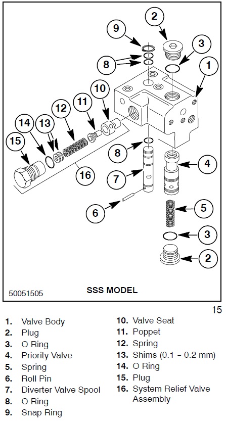

I didn't get an orifice installed. Seems like this a a common theme and would make sense, where did they put yours? Jinman's feed back would suggest on the bucket end of the dump curl cylinders but this would also slow down the dump when the regen valve in joystick was open "hard over to second position". As I understand it the regen valve is basically a check valve that allows fluid to flow from the bucket end of the dump/curl cylinder to the tractor end but not the other way. Would it not have made more scene to have put this valve between the power port and tank port of the joystick as this would have allowed escaping fluid from any cylinder to supplement the incoming fluid any time incoming pressure was lower than the tank port pressure i.e. dumping a bucket at low rpm with low pump volume?
There is another little box of tricks on the machine that is called the "COMBINATION SYSTEM RELIEF - DIVERTER VALVE". I can find very little documentation how these things actual do what they do but they are different between the SSS and the EHSS. The EHSS appears to have 2 additional hydraulic pumps on it, one for the main tractor clutch and the other for the PTO clutch. The diverter valve on the SSS has to manage the distribution of fluid to the PTO clutch, Loader, 3pt Lift and rear remotes, the EHSS valve does not have the PTO port on it, as the PTO clutch has its own pump, and as such seems to be a lot simpler "See attach pics". My new theory is that on the SSS model when dumping the bucket with low pump flow a vacuum/low-pressure is created by the dump cylinders being drawn out rapidly due to the weight of the dirt. This low pressure, lower that atmospheric pressure, makes the pressure of the PTO port, that is just recirculating as it is not in use, appear high. High pressure signify demand so the priority valve "not present in the EHSS" tries to send fluid to the PTO port, further staving the loader of its fluid and creating a vacuum within the demanding cylinder. This vacuum, as proven by cracking the hoses, is the condition I loving refer to as the soggy noodle bucket syndrome... I can actual create the same condition in the main loader by lowing it rapidly and then dumping the bucket once it is on the ground. Instead of the tractor lifting up, the loader moves up without the tractor creating the soggy noodle loader syndrome but this is a lot less annoying...

Sirloinofbeef, I don't think that your problem is associated with the system relief and diverter. The system relief valve just sets the hydraulic pressure at about 2500 psi and the diverter sends fluid to the FEL joystick valves first if a loader is installed. The one for the SSS seems to incorporate the priority valve into the same block. On my tractor, they add a priority type valve to supply 0.8 gpm flow to the PTO clutch. It's bolted onto the relief/diverter valve. That one looks like it just contains all three functions in the same machined block.
I don't see much difference to putting the orifice on the actual cylinders or on the quick couplings as long as it's on the right side of the curl circuit as DieselMonk describes. Either way should work.
