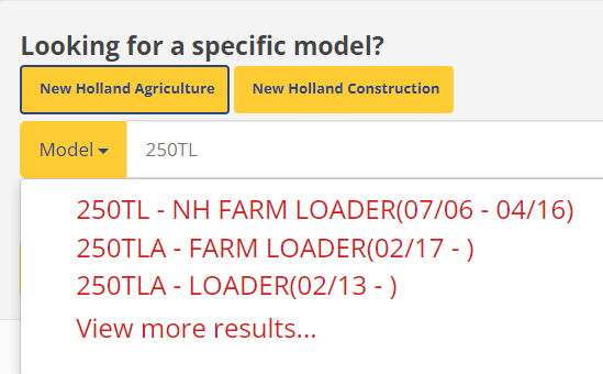

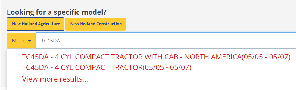

Here is what the parts catalog shows for production dates. That model tractor was only built from 05/05 until 05/07. The 250TL replaced the 16LA in 07/06 so it would have to be the last 11 months of production, at the most. When they switched over would be dependent on factory inventory. Yours should have a plate on the frame showing the year it was made by Shibaura.

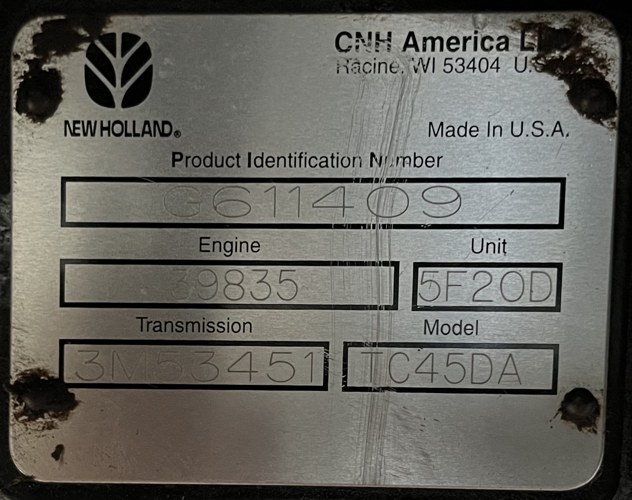

This is the only plate I have found so far, but it’s a New Holland tag.
Where would a Shibaura be located at?
