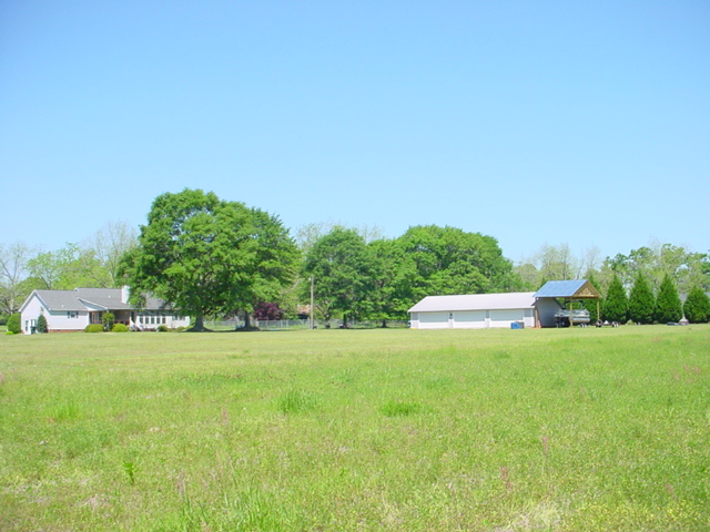

I previously had a 97 NH 1720. I have noticed that the 45da gulps up alot more fuel. I'm not fussin' about it. I just wander if it's the more horses or the a/c causing it. I could mow my place 3.5 times on a full tank with the 1720. Now, I'm getting a little more than one mow. The 1720 had 8.5 gal tank. The 45 has 13 gal. I thought maybe the 4.5 gal difference would equal it out. I was wrong! haha
Any comments?

Hey Jim,
Yes I'm finish mowing with a 6' rhino. The grass aint that tall this time of year. It's still growing slow. I've only cut three times this year. I have 10 acres. I'm mowing aroung 6 of them. It takes around 6 hrs to cut all of it. So far, I've put 28 hrs on the tractor. The land is flat with few trees.

Wow, is it ever green in Georgia! We won't see that for a couple weeks yet, and it's only just now time to mow the lawn first time.

That's a very nice lookin' place, Houndstooth. I really don't know what to tell you because you are using about 2 gallons per hour and that seems a little high to me for the mowing task. I can only guess that you will have to keep some data over the next few months on consumption with and without the AC and also doing different jobs. Of course, you mostly mow, so it may be awhile before you can collect that kind of data. What range are you using? High-Turtle? High-Rabbit? The range could have a little to do with it, but on flat ground, you'd think the mower and ac would have the most effect.
