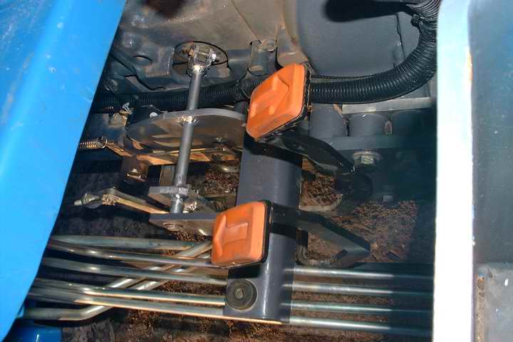

I was mowing with my TC45D when it stopped moving. I had backed down a hill and it would not go up. It will move ever so slowly in reverse but will not go forward. It is a hydro drive transmission. Any chance this could be a cheap or easy fix?

Have you checked your hydraulic fluid level? Do all other hydraulic functions work with full power? FEL? 3PH? If they are failing also, it could be a clogged main hyd filter that is starving the HST pump. It might also be a loose rubber boot on the inlet side of the pump (under the right operator's platform) that sometimes lets the system draw air mixed with fluid.
If fluid is at the right level and it is exclusively the HST operation, it could be a clogged HST filter on the left side in front of the operator's platform or a crimped HST cooler hose. This is the easier/cheaper problems. Otherwise, it might be a faulty charge pump that provides fluid to the HST or an internal HST problem. These are expensive problems.
Finally, you need to look at the bracket where your HST pedal mechanism enters your transmission housing. It's behind that big "B" shaped plate as shown in the photo below. This photo is taken from the top with the platform lifted and clearly shows the bracket. Mine is painted silver after I repaired it. You will be looking up from the bottom (with tractor not running) and you may have to move some stuff to examine the bracket. If this bracket is broken or slipping, it could be that the pedal movement is not making the input shaft to the transmission swashplate turn as it should. This is also pretty major, but not as much as splitting your tractor to work on the HST.

   / tc45d will not move forward #5
So, I have a TC40DA with a hydro trans. It has been acting up a bit kind of like the TC45 in this thread. It works well to start but after using it for awhile it acts like it's slipping. I tried to climb a hill and it only made it about half way then the engine RPM started dropping and the forward movement stalled. I didn't have any load on it or in the bucket. I backed down and drove it on level ground with full forward speed without a problem. It has also done a similar thing when I was using the loader moving some dirt. The forward pedal seems to stick down and when you remove your foot it returns to neutral slowly.
   / tc45d will not move forward #6
What range were you in and how much of a hill? I never climb any hill of consequence without being in low range. Normally low/rabbit will pull most hills. If you are in high/turtle, small hills aren't a problem, but soon you will find you are getting HST bypass/stall, which is the pressure relief inside the transmission lifting.
As far as the pedals sticking down, this is normally an example of having too low engine rpm. Keep your rpm around 2000 or higher. What happens is your rpm drops and the HST charge pump does not supply enough fluid to operate the swashplate, so it tends to stay where it is placed rather than returning to neutral. You also might improve this by lubing the roller that follows the "B" plate or adjusting the pedal return spring under the right-side platform.
