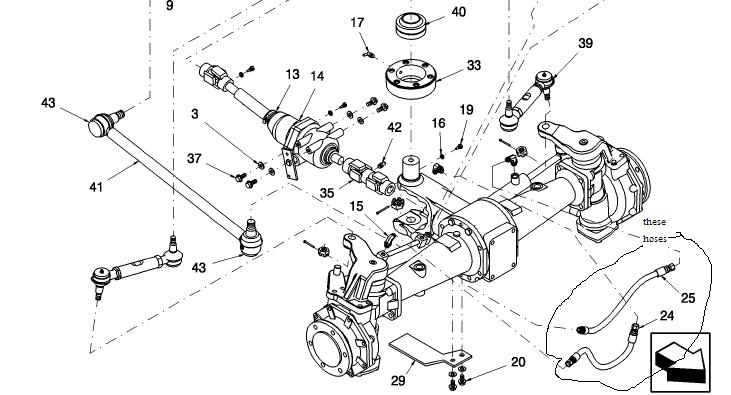

Y'all,
I have a 2001 TC45D with Supersteer. The front hose on the turning cylinder had a hole worn into it today. No big deal(less than 20$, with 1300 hrs on the tractor).
However, others who have this class, with SS, may want to check the hose(there are actually 2 of them) out, and possibly put abrasion protection on them. There is an angled piece of metal by the pivot that lightly rubs on these hoses
Chris
