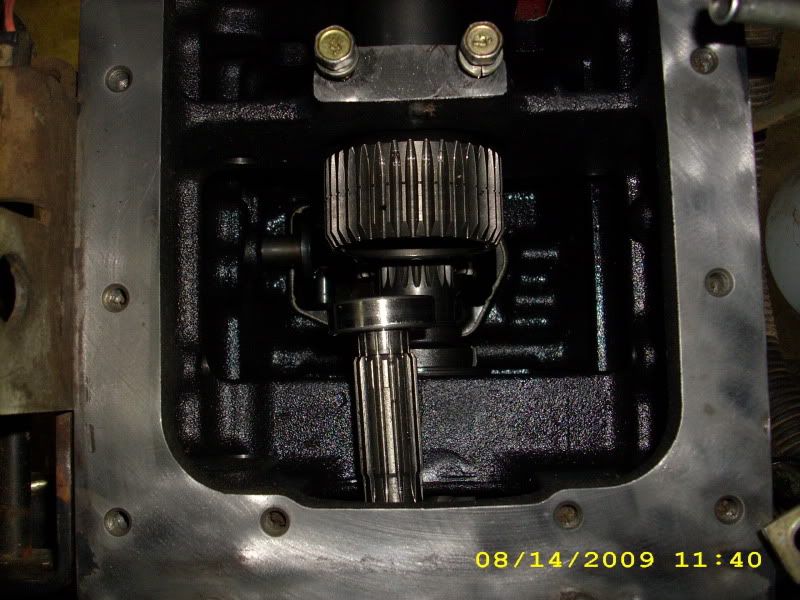

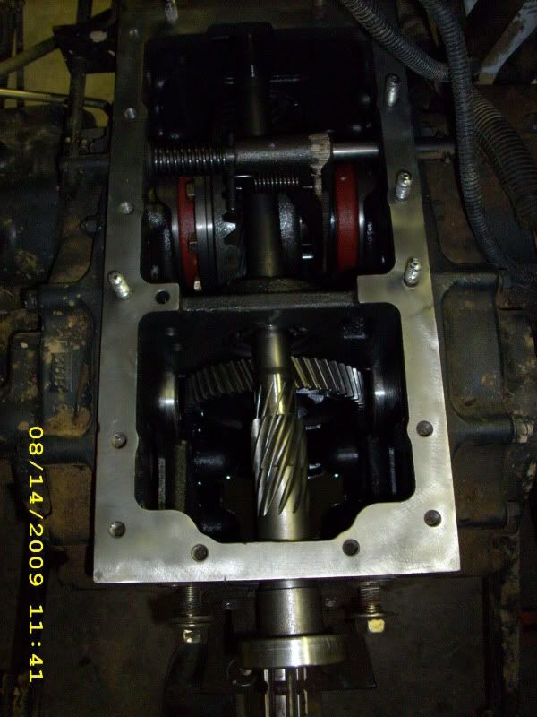

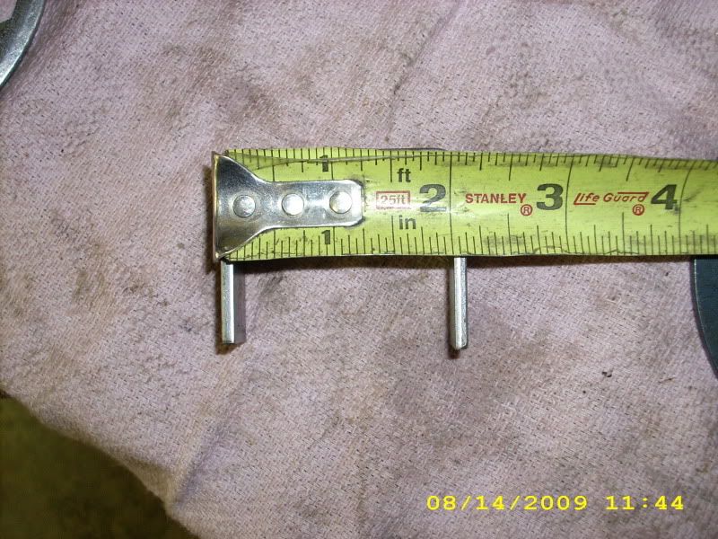

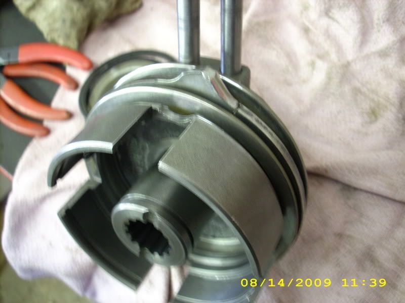

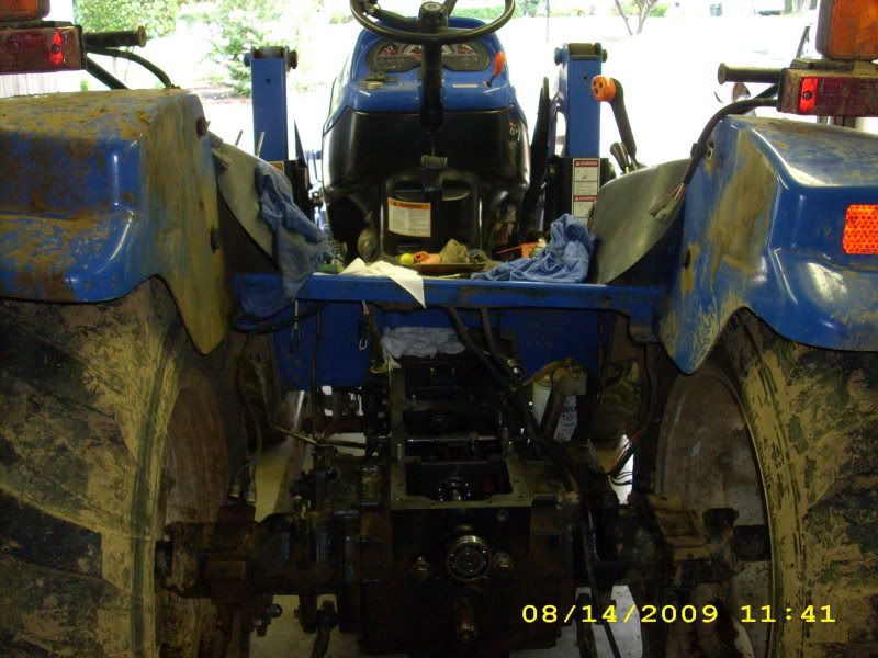

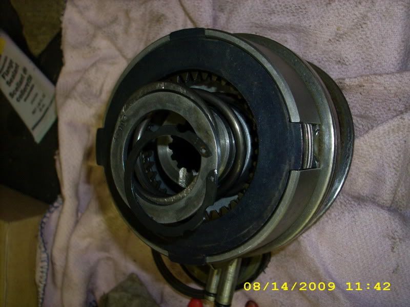

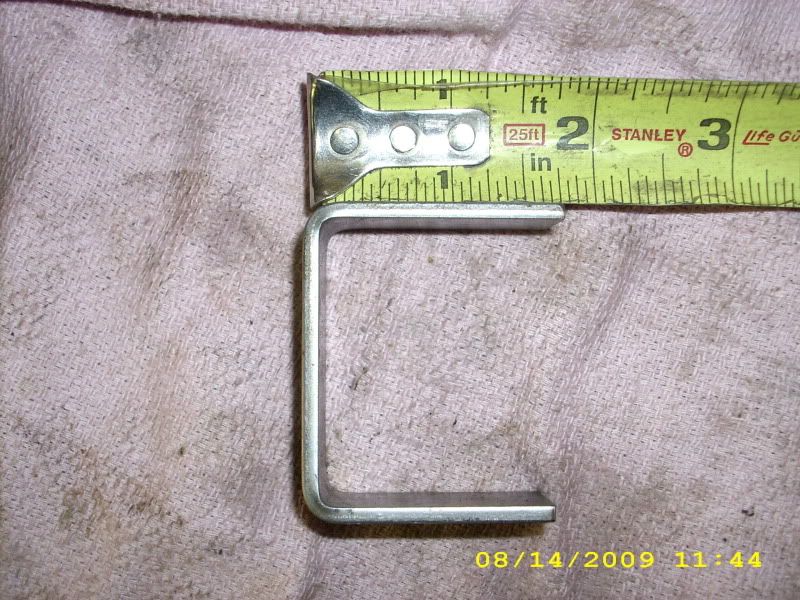

JinMan thanks for the help I found the problem to be the PTO clutch pack and the brake disk. I Just left the NH dealer and it seams there was a up grade to the brake from a 1 mm disk to a new improved 4 mm disk that i did not get the upgrade in 07. The brack disk broke apart and jamed the clutch pack causing the PTO to stay engaged. I'll get some picks and post them. Thanks again for the help Ken
   / TC45D PTO problems
[/IMG]
[/IMG][/IMG][/IMG]
[/IMG]Got her back together and she works fine now here's some pics and the special tool I had to fab to compress the cluch spring
   / TC45D PTO problems #8
Excellent work:) How did you use your fabricated tool to compress the clutch pack spring?
Did you use a big c clamp, vise or hydraulic press?
