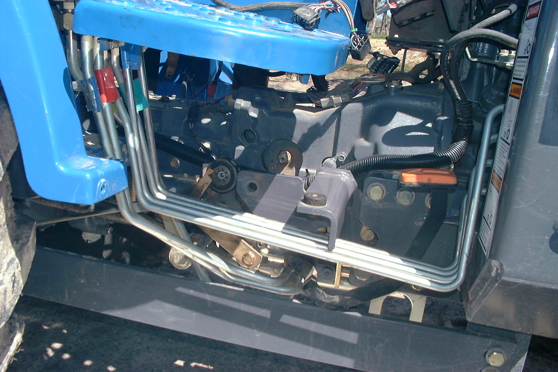

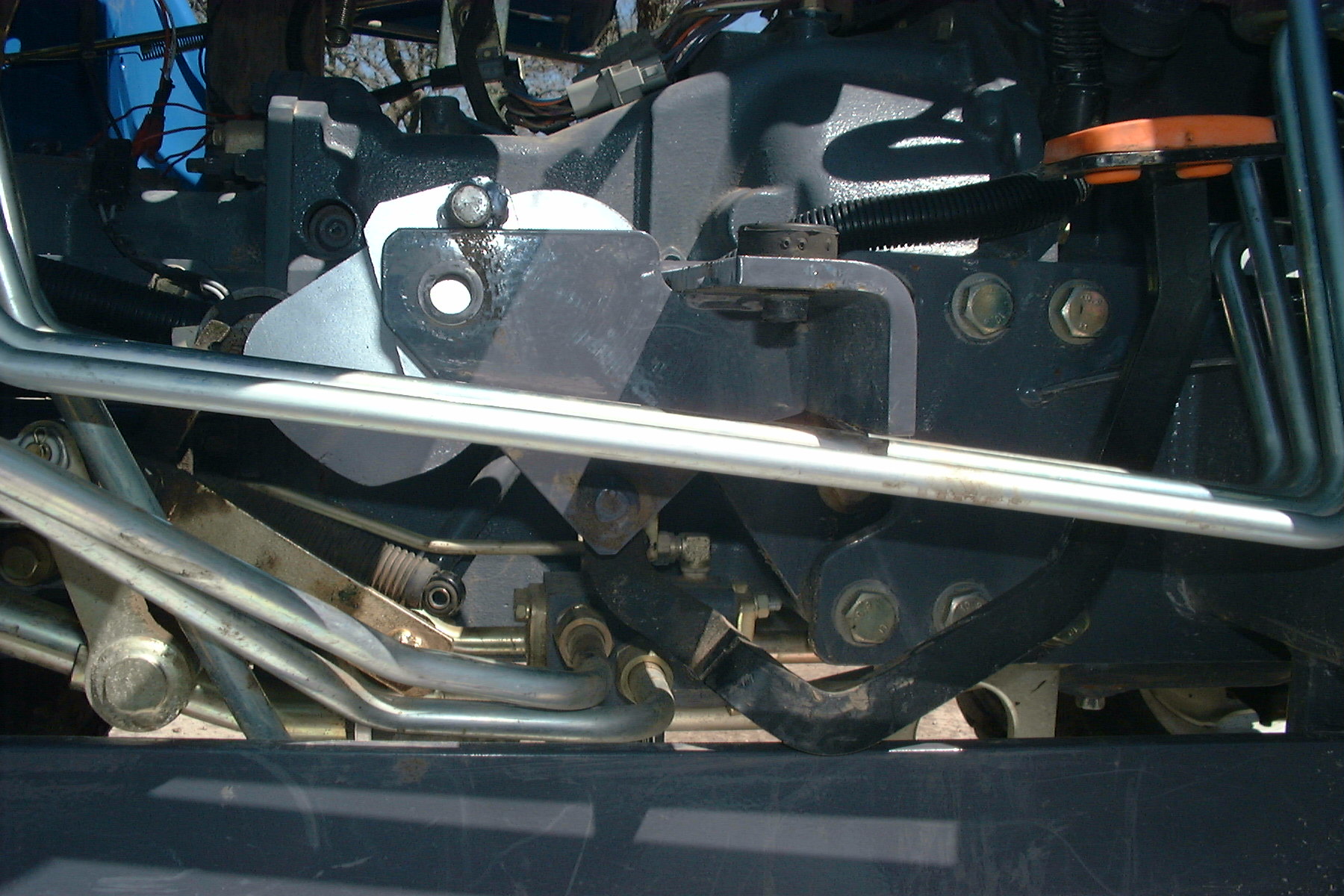

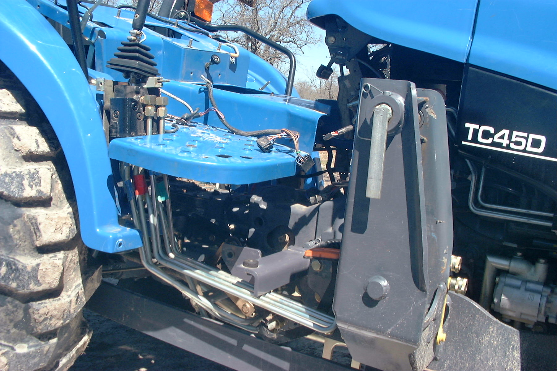

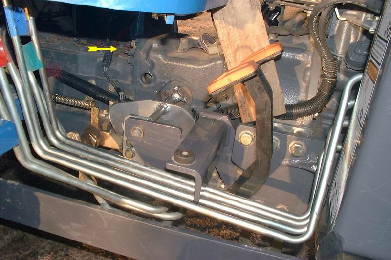

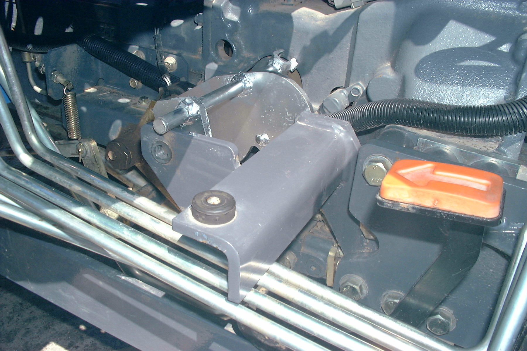

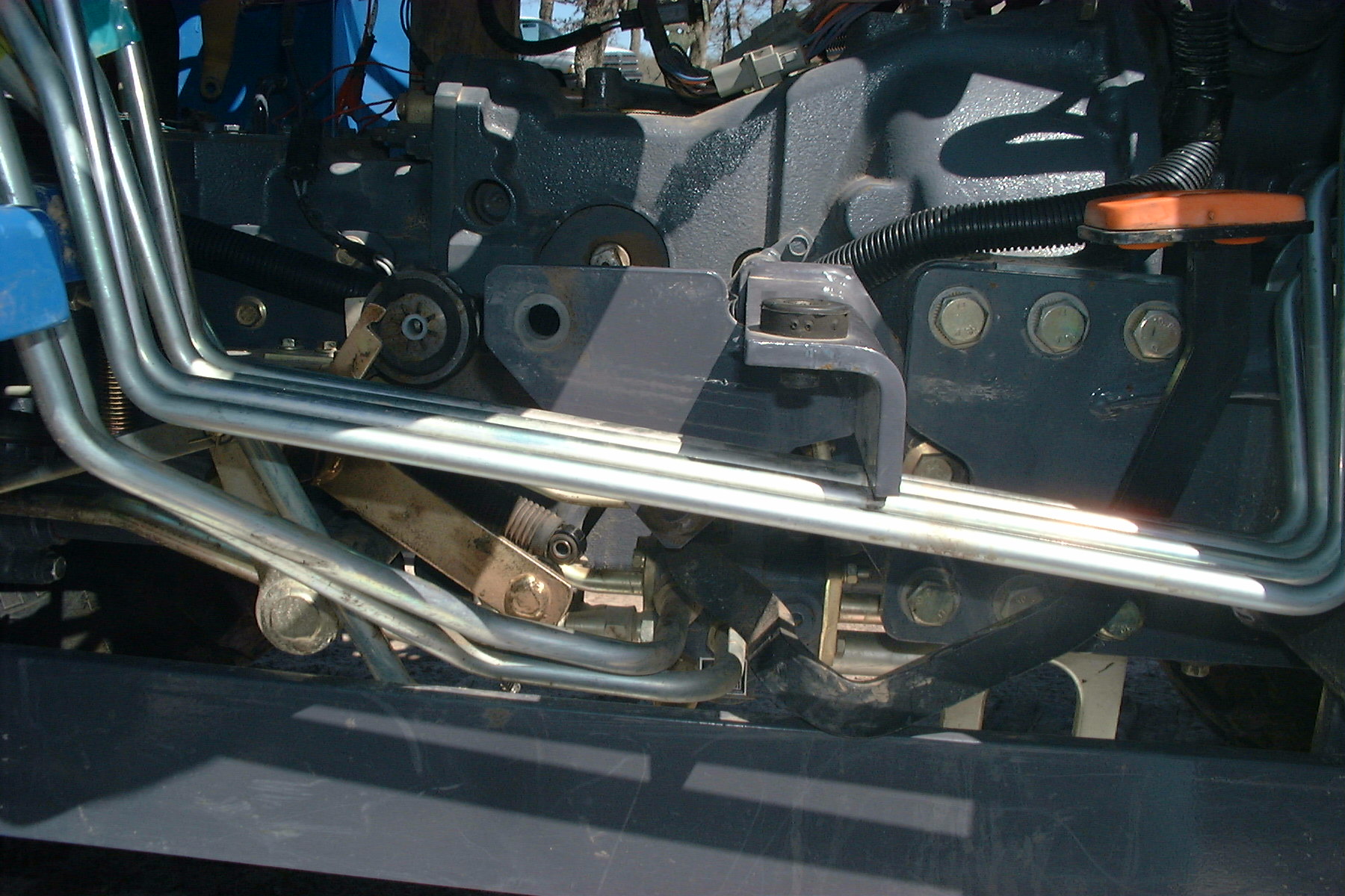

Hi Marv, I may be the original member to report this problem. The shaft might be tack-welded in place, but to do the job right requires removal of the platform. That's because of the damper shock behind the B-shaped plate which is right next to the cruise control magnet. Everything is jammed together down there with close tolerances. Have you found my thread with the photos? One big job is removing the right loader post so the platform is free to come out. Frankly, it's a butt-kicking job that is best done over a couple of weekends in a covered/heated shop.

Marv, I know exactly what is in John's photo, do you? My point is that cutting is a great idea if you know what you are going to expose and what you are cutting through. If you don't know, you could find you've cut something that should not be cut. Yes, cutting is a good idea if done carefully. I'll get together my photos and try to post them up soon for you. I'm sure they will be helpful, but you won't find a lot more than what's in my original post.

I have another question concerning the trans pivot shaft where the tack weld broke. What is the
best way to make sure the shaft and B-plate are all lined up properly before you weld.My thought
would be to put it back together and mark both peices in the correct position. Would this be the
best way to do it? Thanks again for all your help.

Marv, the best way to make sure the alignment is correct is to insall the B-plate in place before you weld. If it doesn't lay straight, it might be necessary to put in some shims to hold it in position. You are really asking the wrong guy about this. I took everything apart, so I really have no idea of how to do it any other way.
   / tc45d platform removal #10
Marv, here are the best images I have of the platform area and the loader post bolts. I hope they help.B-PlateOut.jpgB-plate-01.JPGB-plate-02.JPGB-plate-03.JPGB-plate-04.JPGB-plate-05.jpgB-PlateIn.jpgDSCF0006.JPGDSCF0001.JPGDSCF0002.JPGDSCF0003.JPGDSCF0004.JPGDSCF0005.JPGDSCF0008.JPGDSCF0006.JPGDSCF0007.JPG
