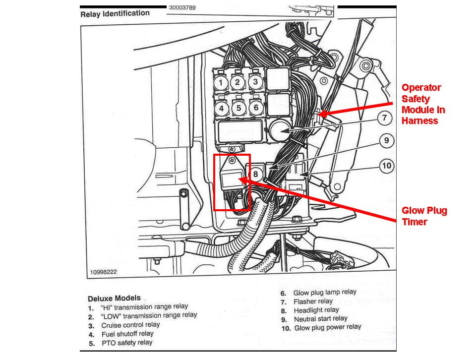

Thanks guys for your help. I will try by jumping/by passing the starter. Where would I find the Operator Safety Module and how do I test it's function. Still trying to figure why the machine stops and blows #2 while running. I will check the module at the injector pump for heat. Thanks.

Here's a locator for your relays, timer, and modules.
