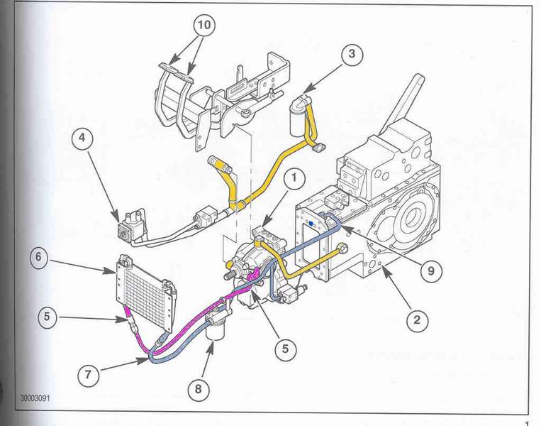

well its not the power steering, **** hyd fluid down to add. its right under where your left foot would be and behind the bellhousing. Its tuff to look at but if you look under front of rear fender it looks as its leaking around a tube/fitting.
   / tc45 hyd leak #5
Well RATS! I was hoping it would be an easy one. I've attached a photo of the HST hydraulic flow diagram. The fitting you are talking about is the flow from the HST cooler as it enters the HST transmission.
In this illustration, the large yellow line at the top is the suction feed to the HST charge pump (a small pump on the front of the transmission that supplies pressurized fluid to the transmission). The charge pump output (pink line) goes to the HST cooler. From the cooler (blue line) the fluid goes to the HST filter and then into the top of the HST. It actually flows through a seal in the mounting flange of the HST. Finally, after being used by the HST, fluid flows out the top yellow line and returns to the reservoir.
I'm not sure whether your leaking line is the top (blue) line or the return (yellow), but the blue line can be running at 200 psi or greater as input pressure to the HST. The yellow line should be very low pressure.

looks to be #9 in photo and i don't need to tell you it looks to be a pita to get to. looks as you have to remove body to get to it. used it tonight with checking fluid and its dumping bad on the belly mower. don't see it spraying, but it is leaking down the side.

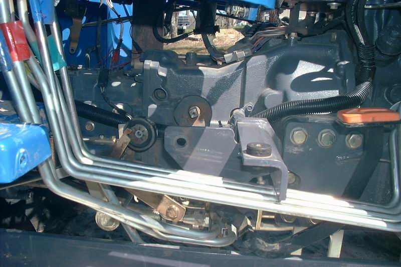

You are right Steve, it is a bit of a pita, but it can be made simpler by removing your rubber operator station mat and opening the access panel right under the hump. I'm including a picture that shows the panel removed on my tractor. I'm also including a picture that shows the area where you are working.
There's also a panel below the seat that allows access. I had to lift my platform to work on my HST pedals when they broke and that's when I took these photos.
To get the rubber mat off, I had to cut a small slot in it so it would come out from around the joystick hydraulic lines. It's a small cut and is hidden by the joystick cowling, so it won't even show. Once you get the mat off, you will have access to the fitting. That's also the location of the pressure test points for the HST transmission. Those have been reported to be a problem and leak sometimes. You might get lucky and find it is one of them instead of the banjo fitting.
