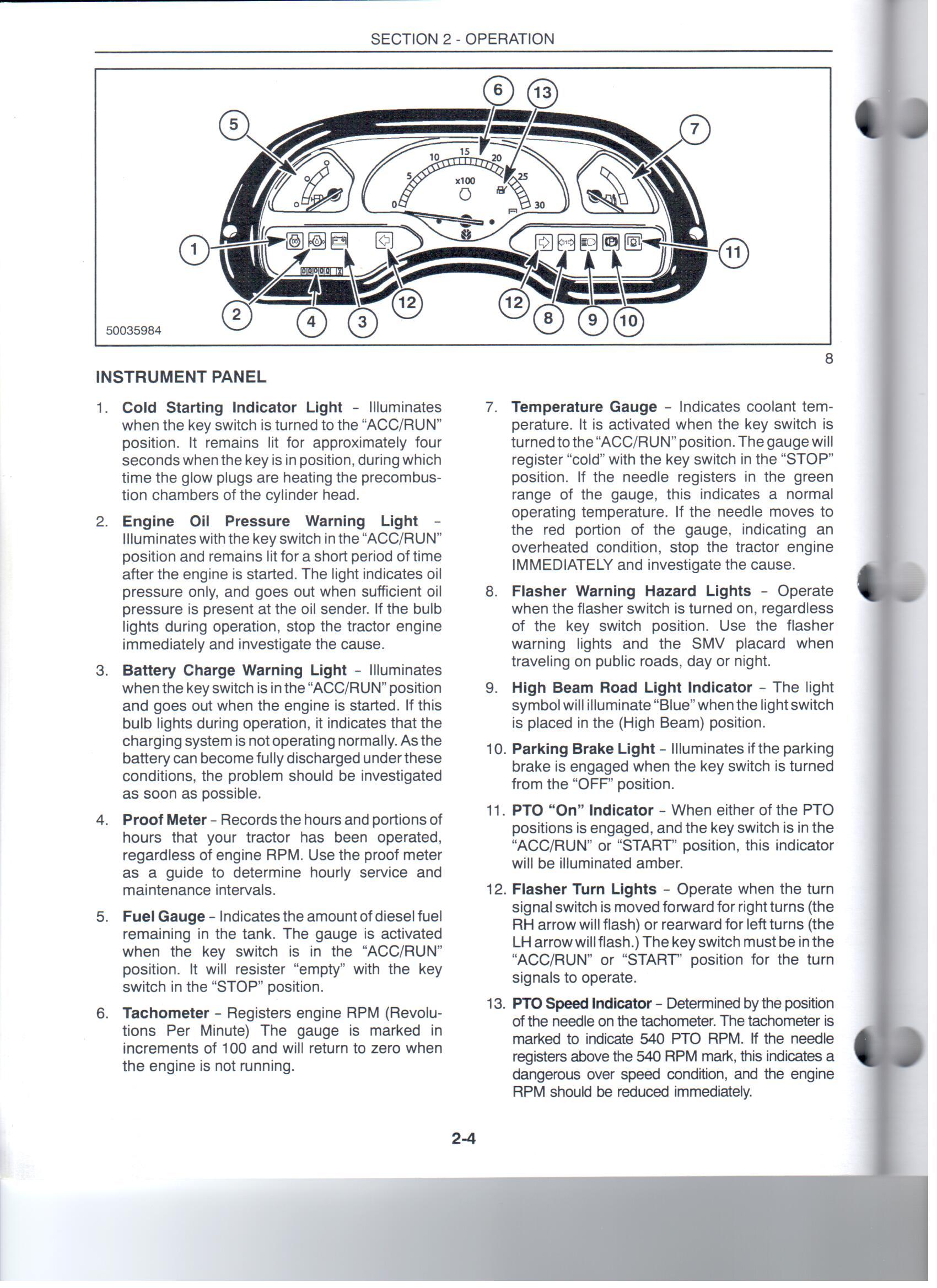

Once the mower is running, you can increase engine rpm up to 540 PTO speed as shown in the lower right portion of your instrument panel. A little green light that says "540" will illuminate when the engine is around 2600 rpm.
Jinman's info on how to engage and disengage is spot on. The light situation may be different depending on the year and transmission.
Is your machine HST or gear?
My 2005 TC40DA HST had a amber light (11) at the bottom right of the instrument cluster that comes on when the PTO lever is engaged. The tach has a mark (13) for 540 RPM PTO. There is no green light at proper RPMs.
