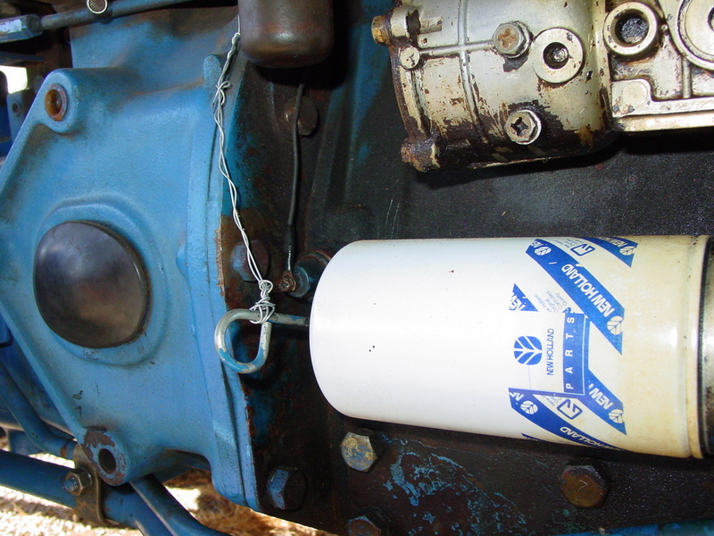

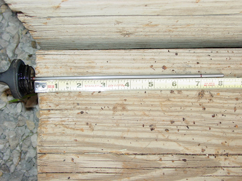

The pic show my dipstick pic for Ford 1700. It may not be any close to what you have and I just posting it as s a reference. I am sure one of the good lads will post the accurate dimension soon.
JC,
Correction to the OP,My bad! I did not read your post correctly , dipstick shown is my transmission Hyd fluid oil level and not engine oil dipstick.I guess I now should make a record if of my oil dipstick dimension should I lose mine. just one suggestion , I tie off the dipstick with a peace of wire or some twine to the engine somewhere so I have less likelihood of loosing it.

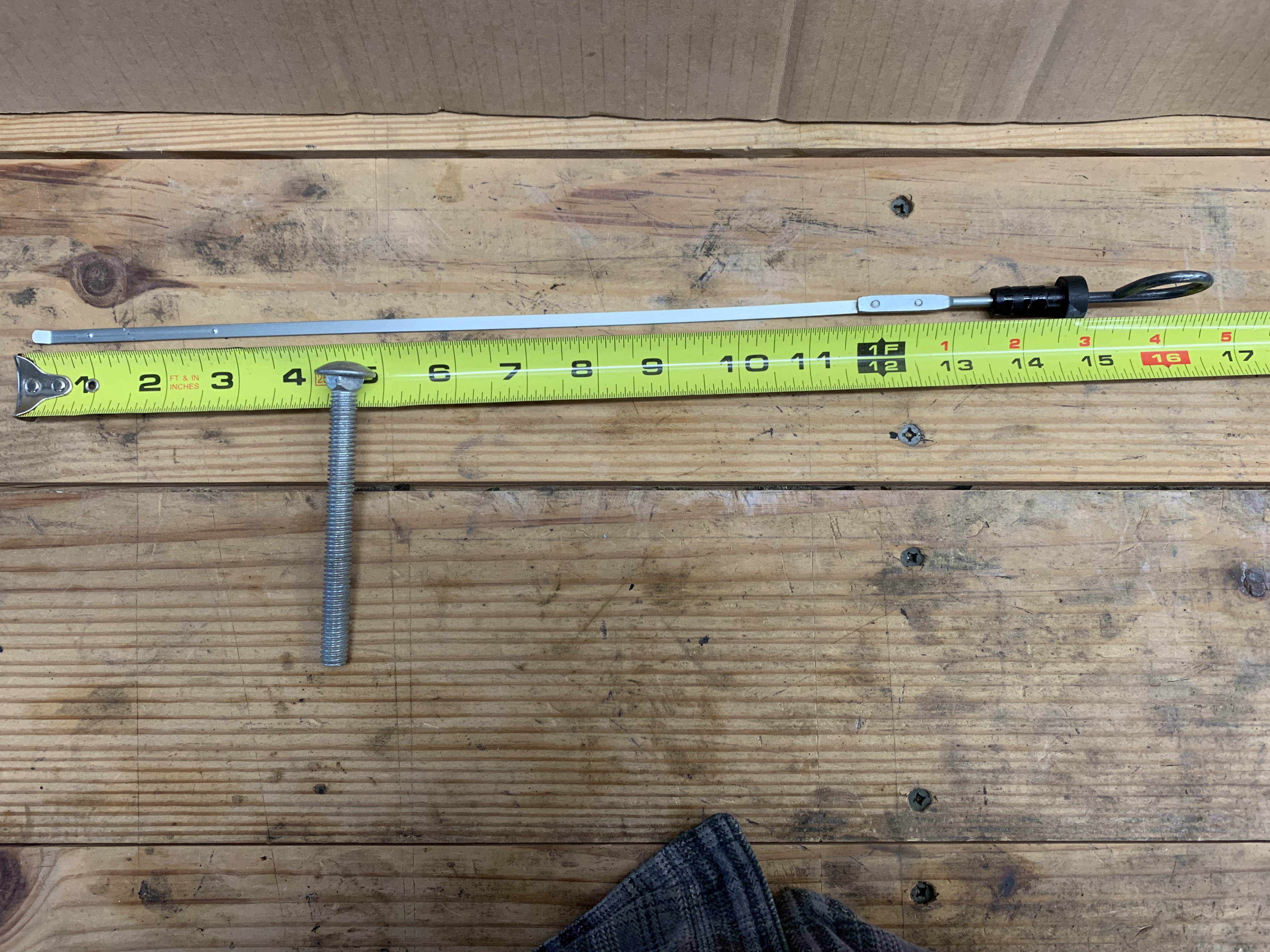

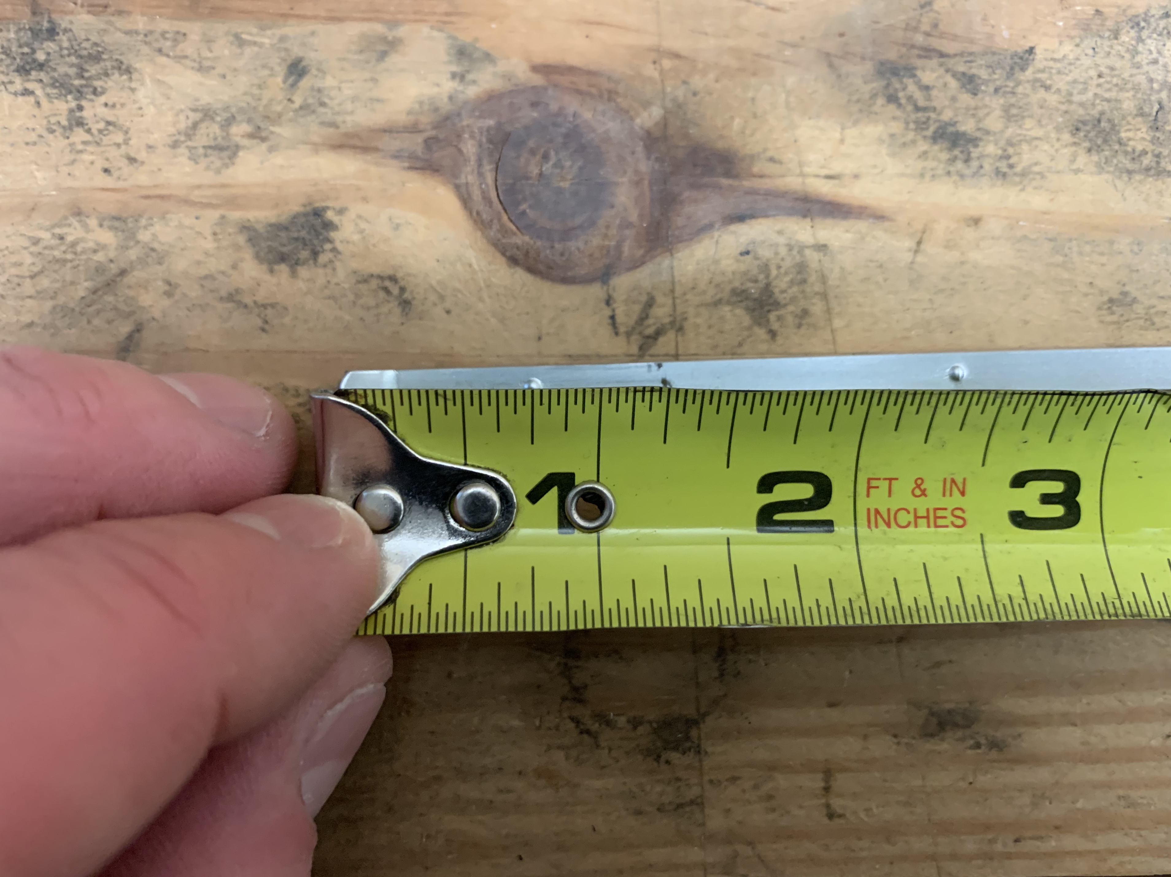

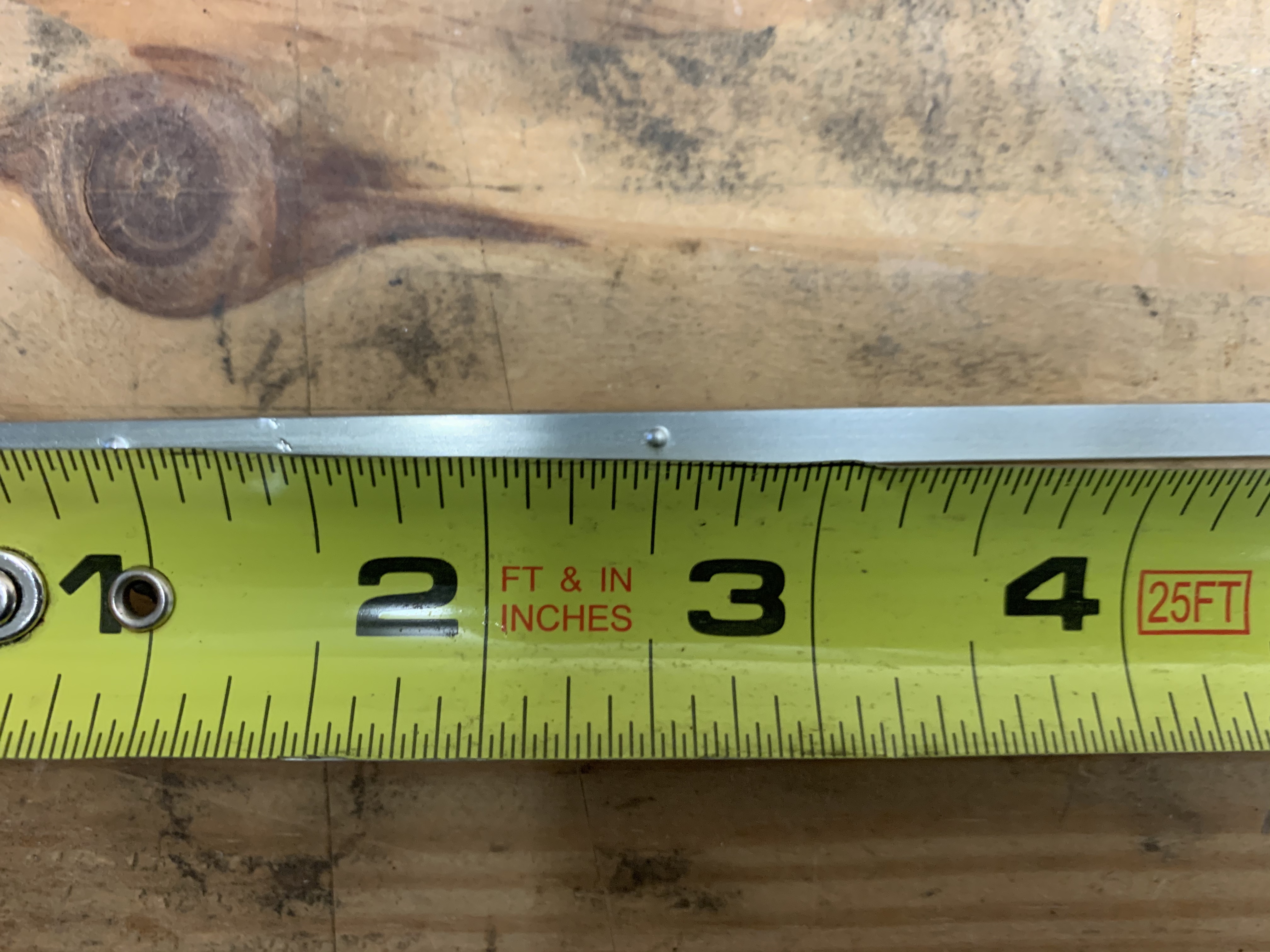

It looks like the low oil mark is 3/4” (0.75”) up from the bottom, and the full mark is 2 1/2” (2.5”) up from the bottom
   / TC40DA Dipstick Length #7

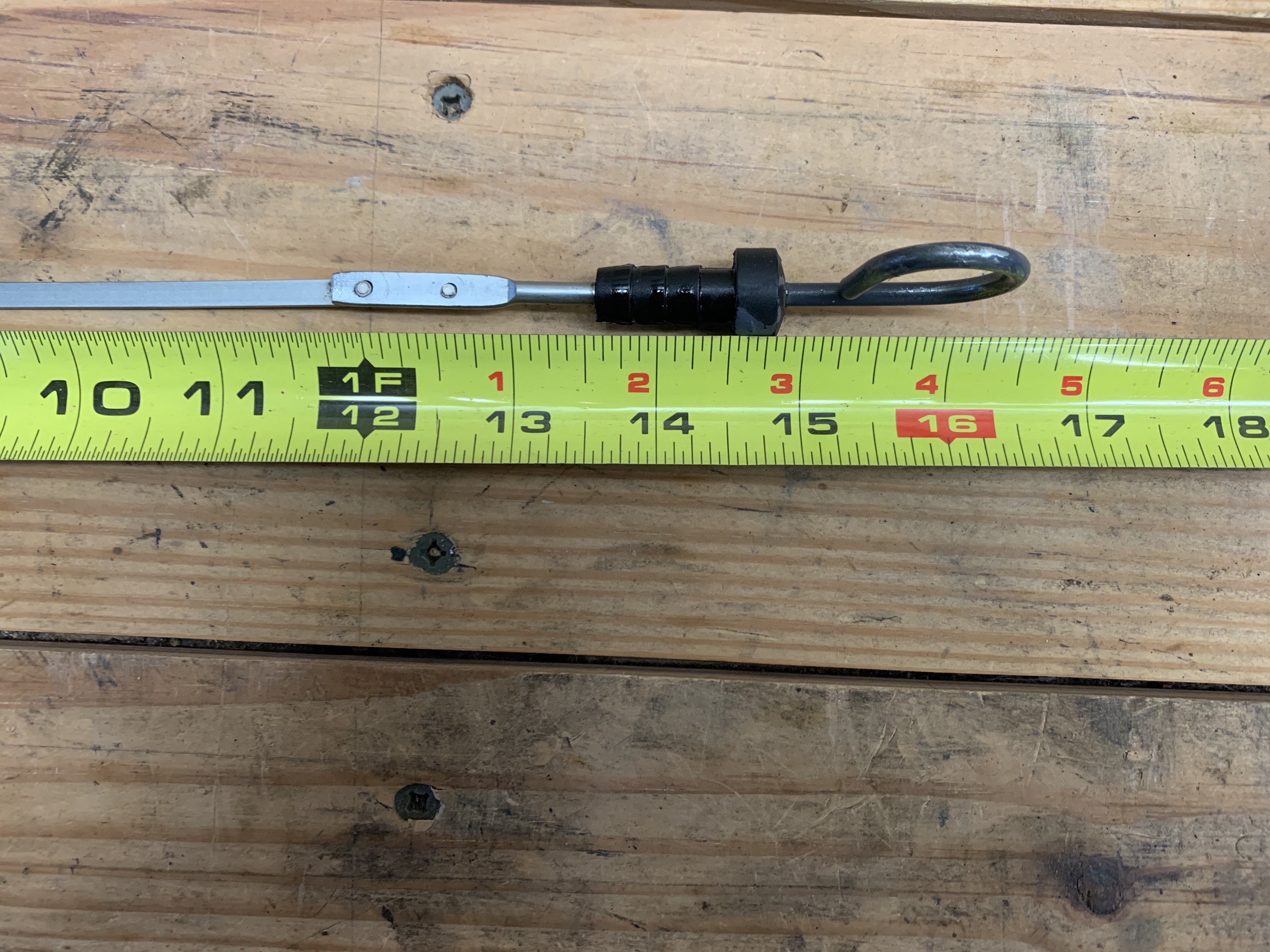

....and the top of the tube is about 14.530" from the bottom.
