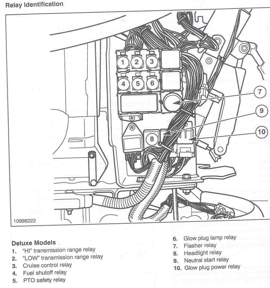

I recentley bought a TC 40D hydro. The left turn signal light and turn indicator has been lit since I bought the tractor. When I use the right turn signal it works fine and the left turn light remains lit. The wiring within the turn signals themselves look fine. The threads I found related to this problem pointed toward moisture in the turn signal switch. I removed and disassembled the switch, it didn't have any moisture in it. I greased the contacts with silicone grease and reassembled the switch. Any suggestions of what to check next? Thanks, Sig

When you use your turn signal, the standard way of operation is for one light to blink and the opposite side comes on and does not blink. Both lights come on, but only the one in the direction you have chosen with the switch will blink.
That said, you have a problem that your left light stays on all the time. Since you say the switch seems to be working, I don't think it is your problem. Another check you can do is to press the hazard flasher button on the dash. This should cause both blinkers to flash simultaneously. If only the right one flashes, the you probably have a bad NASO flash converter module. I don't think you have a problem with the flasher relay itself because it is the same flasher used for both the right and left blinker. If it works for one, it should work for the other.
The NASO converter and all other relays are located under the left side of the cowling directly below and in front of your steering wheel. This cowling has two bolts below the steering wheel and two more you can access after raising the hood. They are on the flat "firewall" area behind the muffler and engine on the left side. You won't have to remove both cowling halves. Only the left side is required to gain access to the relays.
In the illustration below, #7 is the flasher relay. The rectangular box to the left without a number is the NASO flasher converter. That is probably the source of your problem. There is a whole procedure for checking out this flasher unit, but if the hazard flasher and blinker switch both do not cause your left light to blink, then you can pretty much be sure that the problem is the NASO flash converter unit.

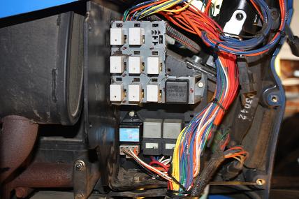

Oh yes! There's one thing I forgot. When you open up the cowling, be prepared to see an area that is about as dirty as you can imagine. Inside these cowlings seems to be a place that attracts and collects dust. Use dry air to blow out the dust, don't be foolish like I was the first time and splash water in there.:eek: I got water behind my relays and all sorts of things started going wacky. I had to pull the relays and blow-dry the area to get things back to normal. don't be surprised to see that you may have some rodent damage too. They seem to love this area of the tractor and the taste of wiring.:rolleyes: The first thing I would do is to look for damage and then pull all the relays and plug them back into their sockets to make sure this is not caused by dirty contacts. You could get lucky and not have to spend a dime to fix your problem.

Jinman, I pulled the side cover to check out the NASO, the configuation is different than what is shown in the diagram you attached with your reply. I blew out the dust and removed and cleaned each relay. There is a relay on the right side that is different from the other eight relays. Could this have replaced the NASO shown in your diagram. Unfortunately I didn't write down the part number while I the cover off. In the attached pic it's on the right side of the relay block.
