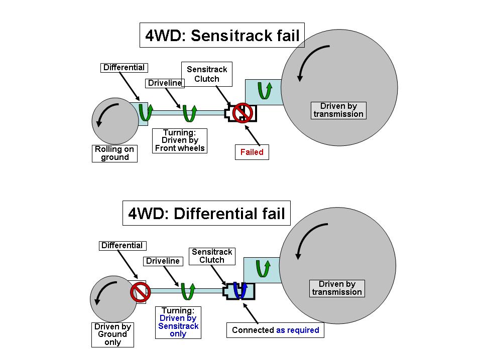

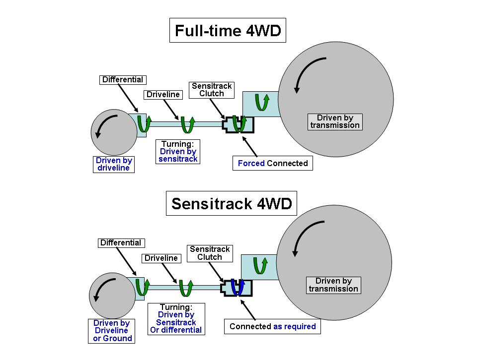

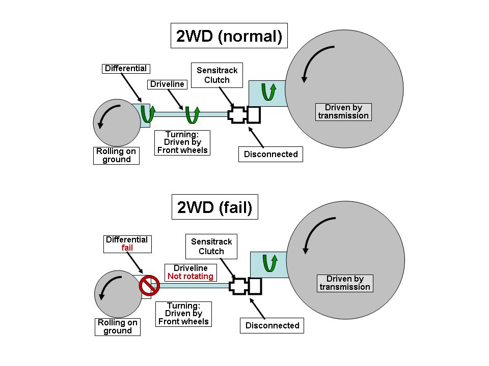

Guys, I'm sorry if I've carried this a bit far, but the old instructional multimedia guy is coming out in me and I decided to draw a bunch of illustrations because there are just too many variables for us to discuss without some kind of visual aid. I illustrated only the main drive components.
Slide 1 below:
2WD Normal and 2WD Failed due to the differential failing.

4WD Full-time and Sensitrack 4WD normal operation

Sensitrack Failing to engage and Sensitrack engaged, but the differential is failing
I'm sure you can come up with other possibilities like the transmission failing, etc, but that is not the OP's problem and I didn't want to confuse the issue anymore than I already have.:eek::D
BTW: I love PowerPoint and its drawing tools. For simple diagrams, it is hard to beat and allows you to build nice slides.
EDIT: And the proof you always need an editor is that I made a mistake on the first slide. At the bottom under "2WD Fail" the box with text saying, "Turning: Driven by Front wheels," should have been deleted.
