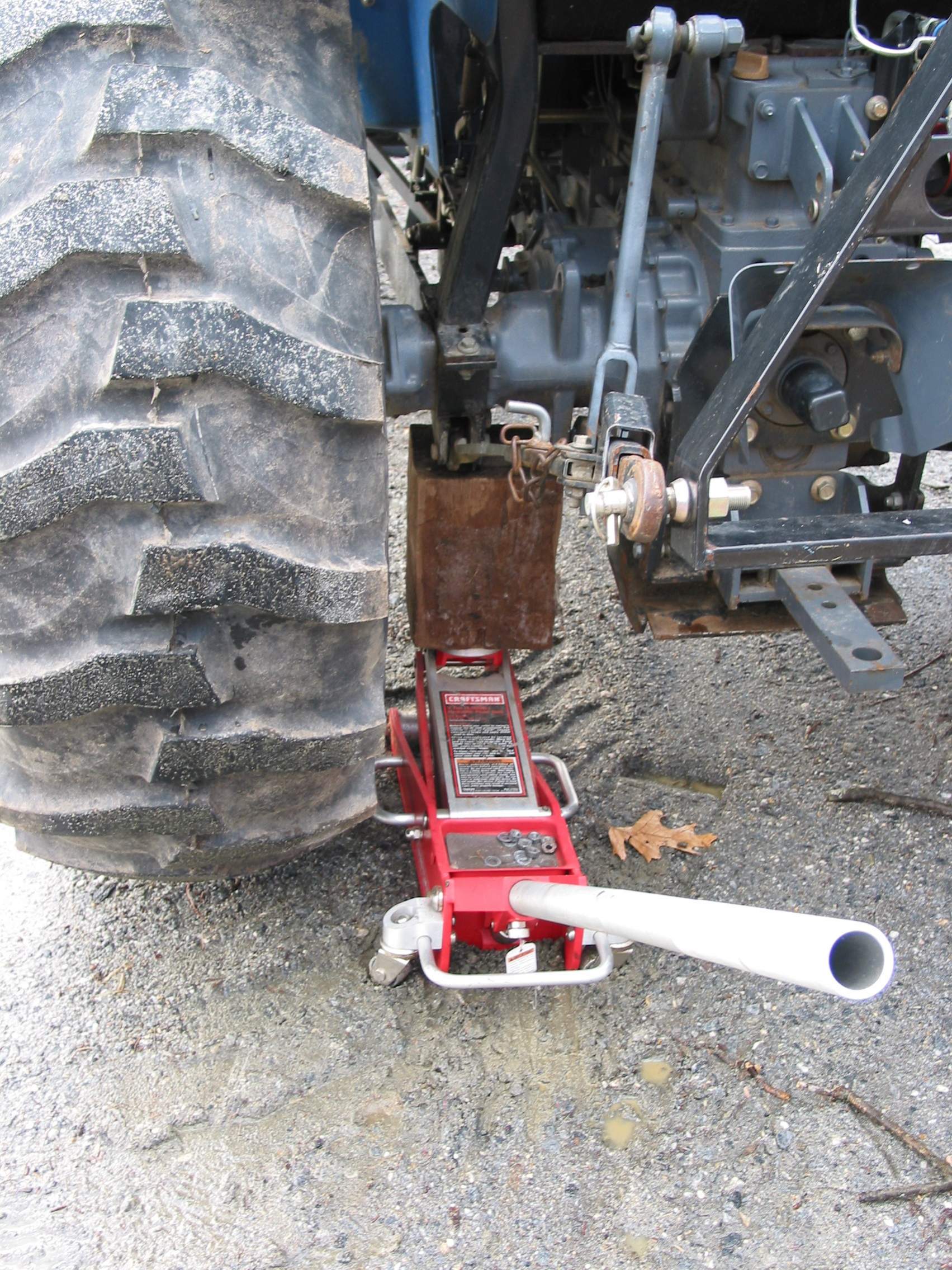

I had to release the 4 to 2 wheel drive lever while she was on the ground and running, then shut 'er down and did my blocking and jacking. Turns out the floor jack's good for 2 tons. I first looked at using my 20 ton bottle jack but it couldn't reach the axle. First tried the 2 ton under the backhoe rear mounting plate but heard a loud crack:confused2:. Can't see any metal cracks (see picture). I moved to the sway bar mount on the axle and, using a stout wooden block, jacked her in the a enough for tire to clear the ground.
WHEEL SPINS EASILY. won't this be great for re-mounting the tire chains.
BTW sure will be hard to fit my jack stand under the axle w/ the jack and block. Any ideas?
Any guesses on the crack sound, it wasn't the jack.

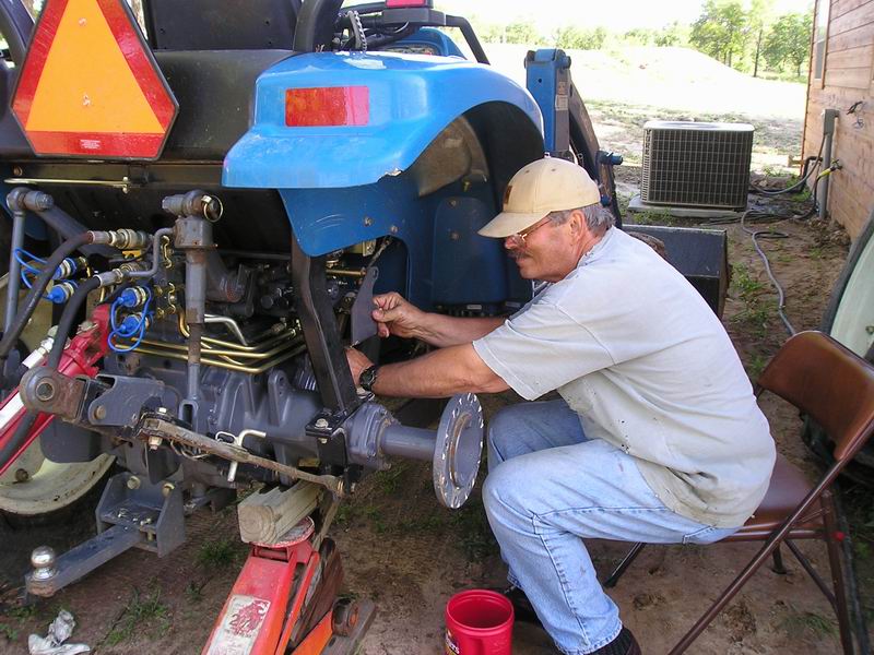

Check the tightness of all BH mounting plate bolts. Sometimes the bolts are snug, but not tight. When you apply pressure, the plate shifts on the bolts and pops. My loader subframe loosened up and I didn't discover it until one bolt was out and the second loose. The subframe creaking was my first clue something was wrong.
I also had a problem getting a jackstand under my tractor. What I did was to put wood below the jack platform so it could not drop (see photo below). That was my "temporary" jackstand and you could do the same with yours, especially if you use a smaller block on top of the jack.
