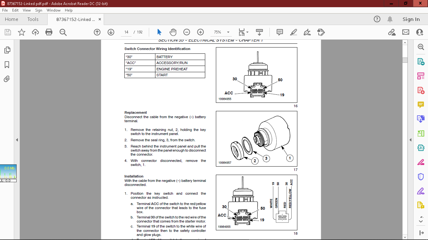

I've been having problems with the starter solenoid not kicking in, but after playing with the starter switch, it eventually starts. Went over to the tractor today, turned on the switch and NOTHING. No dash lights or anything else. No solenoid clicking. NOTHING. All fuses are good, including the main fuse. I've read about bad switches and corroded positive batter cables. Anyone have a clue to guide me from here?

So all fuses are good... but are they getting power? If fuse #2 has no input power from the ignition switch, neither will any of the other fuses. The whole tractor would be essentially dead.
The ignition switch on the TC series are semi-known to go bad... but so are the battery cables... so you should check them also...
We have a TC40D so we know a lot of it's problems...
We have had an internally bad battery cable... & we have modified our starter circuit with a dedicated starter relay... to modify the starting circuit by adding a simple relay so the starter solenoid get direct voltage every time... works great now...
I'd test the switch... & the battery cables first...

Test your ign switch, the slo-blo fuses, and test/swap the safety-start relay. (lite & turn relays same)
