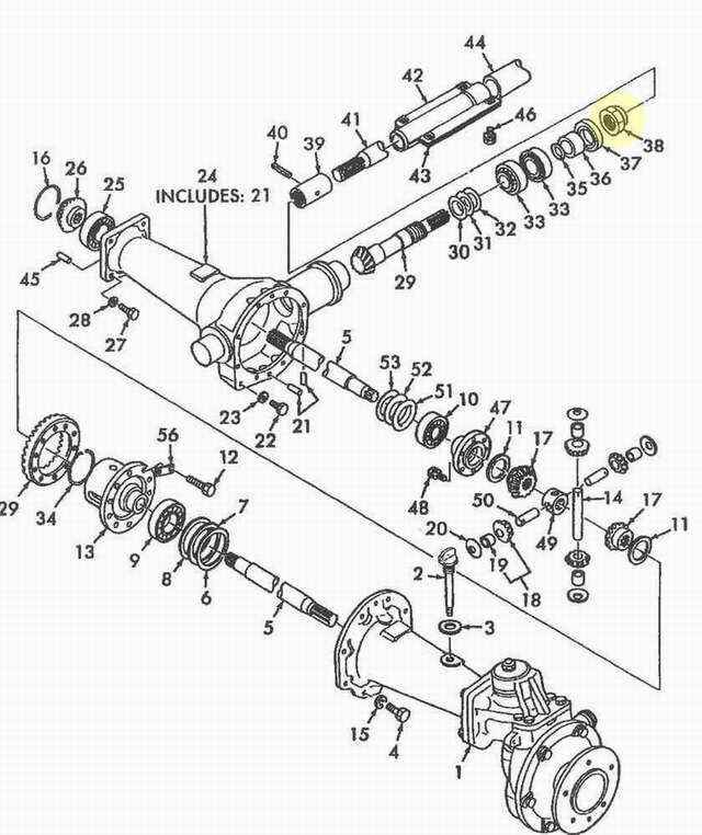

The bad news with my NH TC-40D. (350 hrs, new Sept 2001) Last week I was moving 40 yds of loam on fairly level ground, in 4wd. Heard a clunk, and then no front 4wd. Slowed me down a bit getting the work done, but was able to finish.
The good news was my dealer's superb service (KLEM Tractor in Spencer, MA). Picked the tractor up the next day. I was going to call today (a week later) to see what was the problem was, and before I could, the truck pulled up! Cool.
The problem (known by NH) was the locking nut on the front pinion gear was not assembled with a locking washer. Problem only experienced by owners who work the front end hard (like me with my Rooter bucket). Bolt spins off, pinion slips apart. Fix is fairly easy, though you have to crack the front axle case open to get to it.

Kent, I feel a little like I'm hijacking your post, but I've looked a little closer at the illustrated parts catalog and found what I think is the nut that loosened up on your front FWD input pinion shaft. Both the supersteer and non-supersteer front drive axles have a similar nut. I'm attaching scans of the illustrations with the nut highlighted. Let me know if I picked the wrong part.
Attachment is Non-Supersteer; part #38 is the nut.

Thanks for the post on the schematics! Unfortunately, because the dealer picked up the tractor, I didn't get into too much detail on the followup phone call. I suspect you are correct, though, from the verbal description I received. Fortunately, nothing "broke"...just came apart. In addition to adding a lock nut, the dealer also used Locktite. (Why the factory didn't do this was a surprise to the service mgr).
The only thing that seemed to be happening ahead of time was an increasing difficulty in engaging/disengaging the 4wd lever. It was always stiff (reverse a little or suspend wheels often necessary), but it became almost impossible right before the clunk.
A nice side benefit of having the dealer fix the pinion is now that the 4wd lever is smooth as butter!
