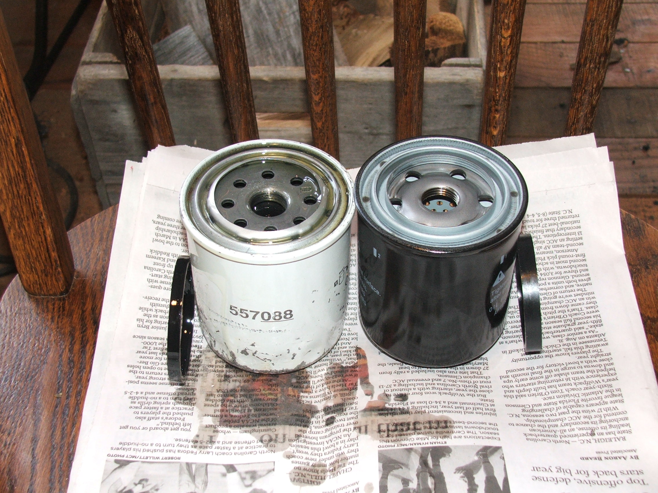

installed filter from Messicks today. The new filter had a wider gasket and the design was different than the old filter I purchased from carquest auto parts strore. The old filter has a rolled inside edge to the groove that holds the gasket and the new filter has a straight edge. Anyway the new filter seems to be ok,only had time to run the motor for about 10 minutes.

Very nice comparison showing the new rugged filter and seal. Thanks!
