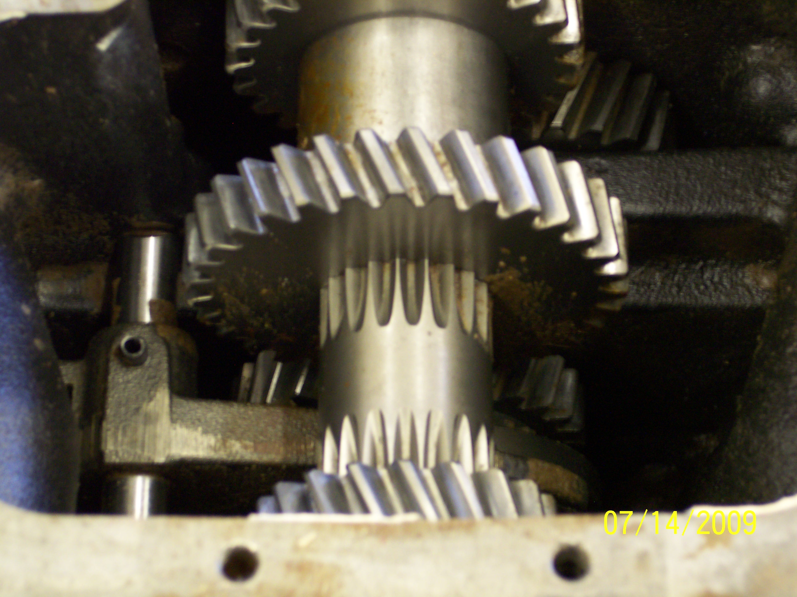

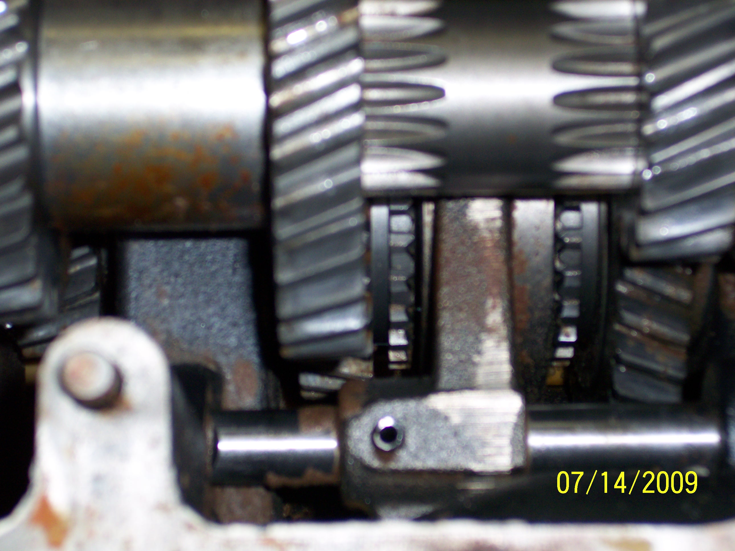

Mitch here are some pics of the internals. The lever that comes to the ouside pushes and pulls on a collar that slides on a pin. This collar then move the grears. I don't know if this helps but at least you know what you are looking at now. Most likely it is the shaft that comes to the outside. Being it is held in by one bolt I am pretty sure that it just floats and is not actually attached to the internal collar. I would think that you can pull this straight out without any consequences. Why it is sloppy is strange, but I would pull the bolt and shaft before I committed to tearing the top end off.

Skinnr, the shaft with the lever on it WILL NOT come out of the transmission unless something is broken. It is removed from inside the case. The single bolt on the outside just holds a locking collar in place so the shaft and lever cannot slide back into the transmission if the outer shifting bellcrank is removed. On the end of shaft inside the case is a lever with a ball on the end. That ball fits up inside the shifting fork that is visible in your photos. When the shaft is rotated, the lever moves the shifting fork along a shaft with three notches in it for the indent ball to seat into. Those notches correspond to ranges I, Neutral, or II.
What Mitch needs to do is get that cover off his transmission and then shift thru the ranges so he can see what is happening/not happening correctly inside the transmission. If I were a betting man, I'd bet his indent ball and spring are malfunctioning so that he never feels the proper range when he shifts. It's either that or maybe a broken shifter fork or shifting lever on the end of the shaft.
