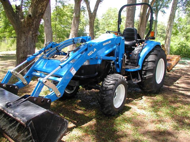

NHeuro,
This is a pic of my tractor on my property on the Bayou Teche.
