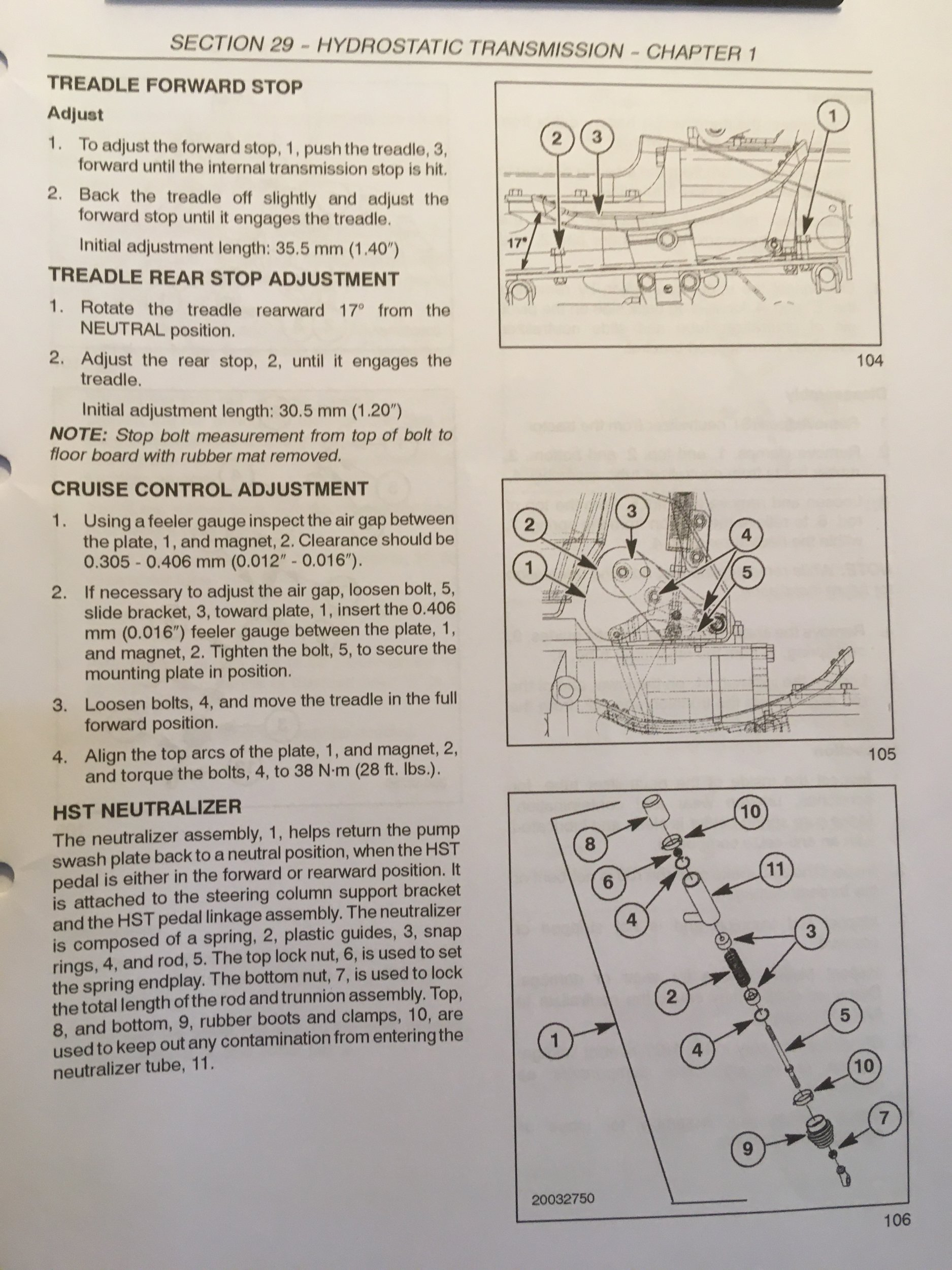

Hi all, my TC35D has a issue where kit continues to creep even when let off of the pedals. Does anyone know how to fix this? and please xplain in good detail
   / TC35D HST creeping #2

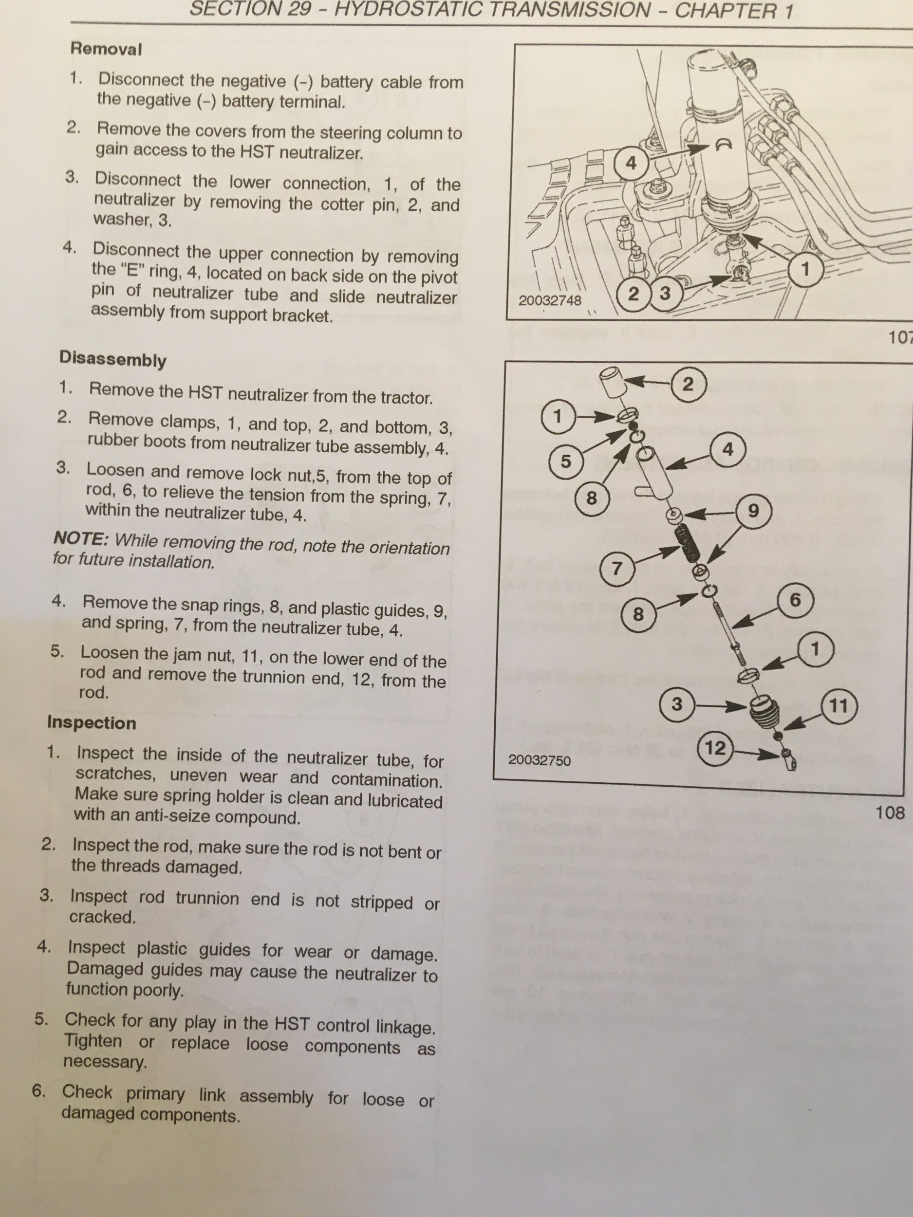

There is sometimes a visible centering spring to keep the pedal in the neutral position. TC35 likely doesn't use that setup.
So I have NH FSM manual for similar models (w, w/o super steer) that shows "Neutral Position Adjustment/check" (1 page) and includes "Neutralizer" widget that's part of it. (3 pages to o'haul) If you want to see 'em PM me an email and I'll send PDFs tonight or tomorrow.
To get at the widget we must open the hood and remove the side panels to access it along-side the steering column under the IP. Prop the rocker pedal fully 'forward' (securely) from the back or the panels won't come off without gouging paint and plastic. (and DAMHIK. :sneaky:)
t o g

Here is the chapter for the TC35DA HST pedal adjustment. It may help. From what I can tell there isn't that much difference in the mechanical operations.

Yup! It's as likely that the OP has the two-pedal vs rocker-pedal setup. ('tractordata' wasn't clear for me on model specifics)
btw, I suspect the OP might the two-pedal version or the tractor might not be creeping. The TCs/Boomers are mixed Shibaura or LS-sourced. Thanks to repowell IMO we've got this covered. (y)

Sent manual pages to OP by email. Apologies for pics vs scans but my printer sits on top of the scanner. This covers rocker-pedal HST on mid-sized, Shibaura-sourced NHs.
