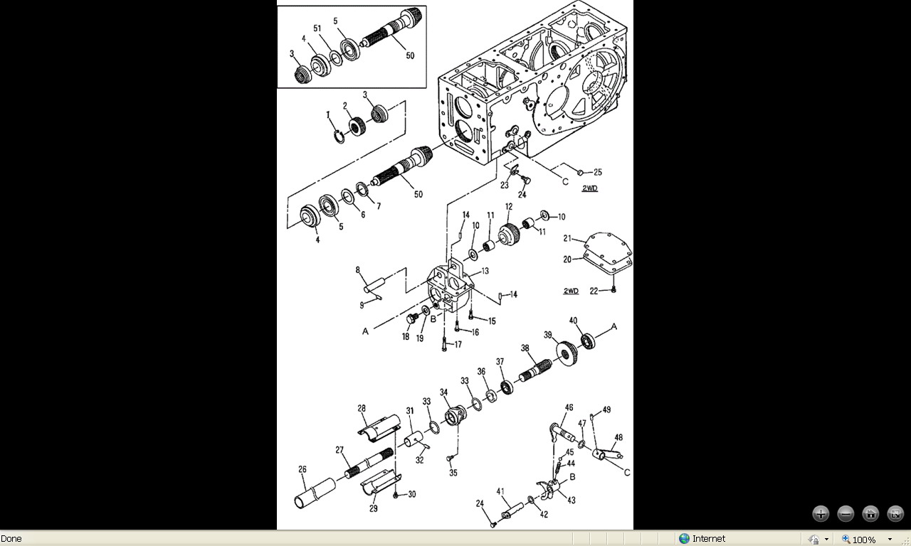

I disconnected the linkage and manually moved the lever on the gearbox. Same result with the clicking sound when moving forward. I definitely think the gears are not unmeshing. Unfortunately I think you have to drain all hydro fluid to remove the gearbox cover to take a look. Anyone have experience with this?
   / TC35D FWD Will NOT Disengage #5
Yes, if you remove that gearbox, all the oil drains out. You have two drain points on the reservoir and a drain point on the gearbox, so if you are careful and drain the fluid into a clean container (or one lined with garbage bags) you can re-use the oil. You should find that the dropbox/gearbox is just a sliding gear with a fork attached to the linkage. Pretty simple. . .
   / TC35D FWD Will NOT Disengage #6
Here is the diagram of the dropbox.

Thanks for the Diagram Jim. I'll have to take it apart and take a look.
