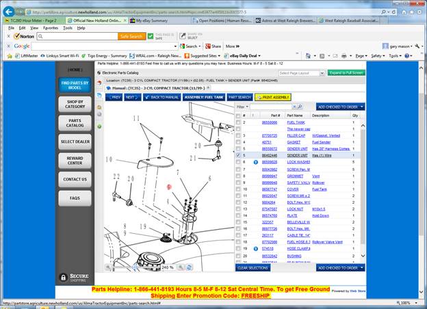

Ok, so I have a TC35DA tractor that I bought it brand new, just .2 hrs on it.
My tractor sale parts ordered me my part for the fuel sending part. when I went to pick it up today it wasn't like the one I took off my tractor.
the new one had 2 terminal links, but the one I just took off had the rubber jumpers in the center circle. after looking at the service manual it did look like that there are 2 different sending units. it looks like that my TC35DA tractor actually got the sending unit for the TC35. that one has the rubber terminal links, but the DA models had the 2 open terminals. So something happened at the factory when mine was made and my DA got the wrong sending unit.... hummmm
   / TC35D fuel tank issue
here's the parts page that show 2 different part numbers for the Fuel sending unit. The one with the 28" wiring harness is $140 and the one without the harness and just the terminal ends is $95. Guess NH figured out that having the sending unit with the wire harness attached was silly and no need to replace good wiring when the sending unit goes bad.
