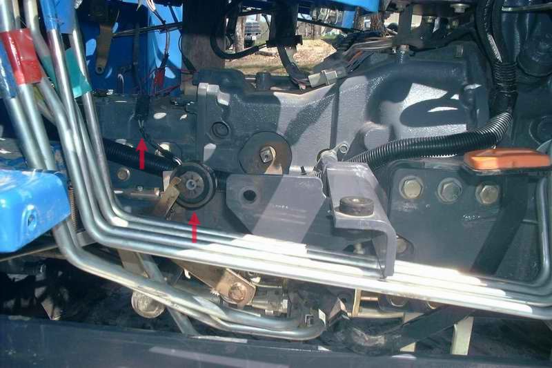

Here's my suggestion on the cruise control problem. You said you replaced a blown fuse #2. Before, you didn't mention that the tractor would not start. If fuse #2 is blown, not only will the cruise not work, but also the starter will not operate to start the tractor. Fuse #2 supplies power to the starter solenoid. If you have good ears, you should be able to hear the relay set for cruise. It's under the left side cowling down under the steering wheel. The other thing is that when you move the cruise switch to ON, you should see the green light illuminate and stay illuminated until the switch is turned off. That's the point Notforhire makes.
If the light stays ON, then you may need to check your cruise magnet. The photos below show the location of the cruise magnet (red arrows). The first photo is with the HST pedal mechanism removed and the 2nd is with it in place. That's whan the magnet holds when cruise is set. It's not as easy to get to as in these photos because the operator platform has been lifted on this tractor. However, you should be able to reach up from under the right side and disconnect the cruise magnet. With the magnet disconnected, you can check for 12v at the plug when cruise is ON and you can also put your meter on ohms and check the cruise magnet for continuity. It should be around 12-15 ohms. If it is bad, most likely it will be open with infinite resistance.
